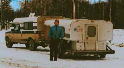

Here's a picture of a slide in camper in a trailer

Irmo, that looks awesome! I would totally do that for my truck! I like the idea of the jacked up pop-up! I will be definitely thinking about it in my vodka/ibuprofen induced coma tonight (hopefully these chiropractic visits will help in time).
