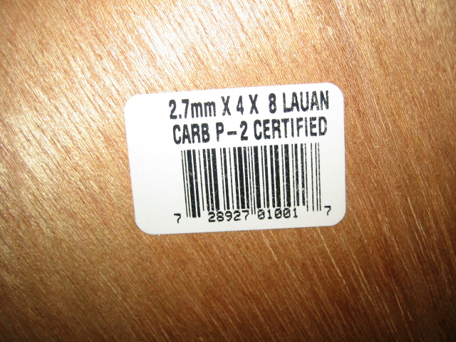

WizardOfOdds wrote:On a side note, I tried to find one-eighth inch (2.7 mm) ply as I understand you used, but it can not even be ordered at either HD or Lowes here. Bummer!
