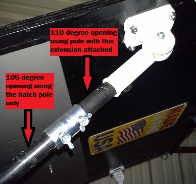

Postby working on it » Sat Nov 08, 2014 1:49 pm
angib wrote:If you go for a flat vertical hatch, be sure to check where your head will make contact with anything when using the galley. You may want to take a bit of the roof into the hatch (to give an inverted L shape) to give head clearance - and it will also stop any structure from being directly above a stove.
The flat vertical hatch (or rounded, but still vertical) requires more lift/opening angle than using a standard sloping teardrop hatch. I used prop rods on the edges of my galley shelf to hold it up, @ 105 degrees, but at one campsite, that angle was compromised by ground slope, and wasn't enough for head clearance. I compensated with extensions, to raise it another 5 degrees,
finalized extension angle usage.jpg (59.23 KiB) Viewed 5068 times
but it was a bear to lift. If going with a vertical hatch, an assist may be necessary if your hatch is as heavy as mine is. I finally added a gas spring assist to mine.

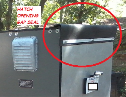

The Kammback was originally in my planning, also, but my hatch opening gap seal serves almost as well.
KAMM substitute.jpg (74.59 KiB) Viewed 5068 times
