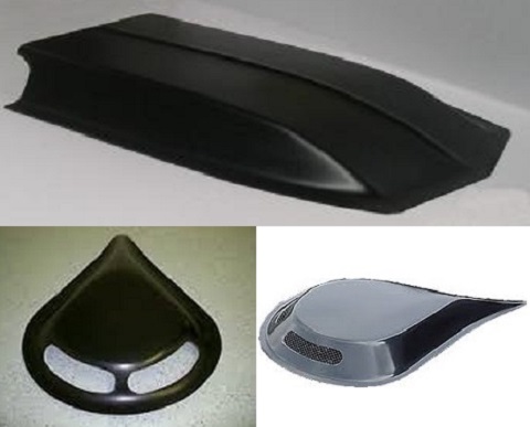

Postby working on it » Thu Apr 24, 2014 10:52 am
I like this idea: if you could enlarge one of these,
cowl vs thunderbolt afx hood.jpg (35.68 KiB) Viewed 3167 times

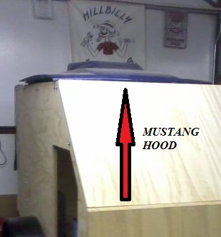

and make it proportional to the trailer...of course, being a Chevy guy, I have to publicly disavow the bubble shaped one, but on a trailer top, maybe it'd be just right. When I was building my TTT, a hood was placed on top (for safekeeping), and some people that saw it thought it was part of the design.
some thought it should stay there.jpg (29.33 KiB) Viewed 3167 times
