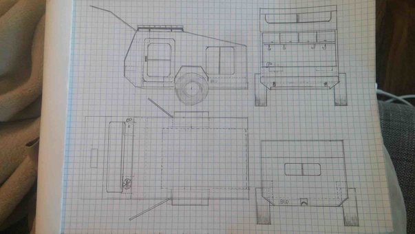

4. Some crappy drawings and a crappy wiring diagram

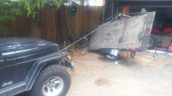

So this should be fun! It's already been fun doing research and planning. Last weekend, I used the Jeep's winch to lift the trailer onto its side and then wire-wheeled the minor surface rust off the frame. Then I treated it with rust reformer and put on a layer of undercarriage coating.

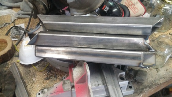

Next is expanding out the trailer about eight inches to the sides and up. I made some good templates for that today and cut all of the square tube steel that I'll weld onto the frame for that. The next step is to weld those on. When I was cutting the old side bars off the trailer, I learned that two of them had been filled with water for who knows how long. I know a lot of vehicle frames have drain holes, so I think I'll connect the new side pieces to the trailer frame with small holes and then put some small drain holes in the bottom of the frame.

I like your sketch. It has a nice profile. Make sure your balance is corrected for when you enter the trailer from behind the axle. Would hate to have it lift off the trailer jack in the front. Suppose you could always put stands in the rear.
Can't wait to see some build pics!

Thanks for the input. I do agree that it looks a little back-heavy. I'm uncertain about the effect of having a ~260lb motorcycle on the front sometimes. (The tentative plan is to have it as close to the trailer body as possible.) The batteries, electrical stuff, and propane will all be up there too, but I think the water will be in the back. So I'm on the lookout for things that can be moved forward or back depending on weight distribution on a given trip.
Oh, and I'm planning stands for the rear, but it would suck to have imbalance while towing. Maybe a temporary holder to keep the water up there during towing on those motorcycle-free trips?

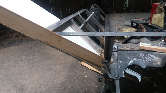

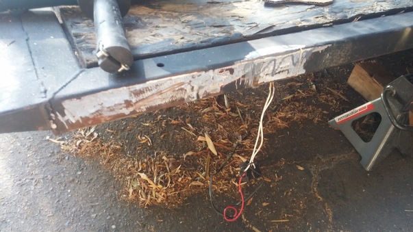

I just finished working on the trailer for a few hours. I finished grinding the new steel supports to get them ready to weld. Then I cut off the old brake lights. This was a bummer, partly because I had just welded them on a couple of trips ago, and partly because they were welded on so well. I was in denial about having to remove them, but finally I just did it.
Now all 10 of the 45 degree supports are welded onto the frame, making the sides ready to accept siding and diamond plate. A few welds still need to be finished up.
Trailer New Supports.jpg (63.96 KiB) Viewed 10343 times
Trailer Lights Gone.jpg (83.59 KiB) Viewed 10343 times
Trailer Half Apart.jpg (65.16 KiB) Viewed 10343 times

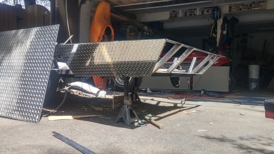

I worked on the trailer for about 6 hours today. I started by making a template for the rear frame extensions out of drywall. I thought it would be amusing, and it ended up working pretty well. Now that those are welded on, the back flexes a little bit. I think it'll be rigid enough after I add some supports for tow points a little higher than the deck.
I cut a piece of diamond plate and was sad to realize that each of the three pieces I bought will only cover one piece. I paid $2.50/lb for the diamond plate at a metal recycler. There is lots of waste, but maybe I'll use some of those pieces for trim (drawer fronts, etc.). On that note, I understand that slow-close drawers hold themselves closed pretty well, so I'm thinking of ordering some of those. Anyway, I found an old sheet of diamond plate that I found next to the dumpster at my old office. I thought that it was another diamond pattern, so I had written it off, but it turns out that I'd used that for another project already. The new sheet is oxidized and old looking, but I hit it with WD-40 and it looks good enough that most people won't notice it isn't as shiny as the other stuff.
I also welded on the steel flat bar that will hold up the walls and then drilled holes for hex bolts. (Reminder to self: drill some holes for cabin light wiring too.) I'm still finishing up some welds, cleaning those up, priming, and painting. The bottom, back corner was a little difficult to cobble together, but it worked alright. The other corner will probably be easier now that I've done it.
I'm not 100% sure I want to keep the old subfloor. It's not perfectly flat (having some swelling around the edges), and I don't know if my power planer will make it better or worse. I think it's called particle board, but with giant particles. I can even pull many of the chips off. I do have a sheet of 1/2" plywood of some sort hanging around, but I was hoping to leave the old one alone in the interest of time. Plus I don't know if I could pull the carriage bolts flush like they are now into a better material. The plan is to put a panel of 1.5" insulation, 1.5x1.5" studs/spacers, and 1/2" plywood on top of the subfloor. If you have an opinion about that not laying flat, speak up.
The project will get stuck after another 5 hours or so due to me not having a trailer - the lug nuts still haven't arrived. But I have a long list of materials I need to fetch. It'll be pretty cool to see the shape come together - I erected a 4' level on one corner just to get an idea of the proportions, and it looked huge.
Trailer Frame Addition.jpg (64.02 KiB) Viewed 10153 times
Trailer Corner.jpg (62.26 KiB) Viewed 10153 times
Trailer Corner 2.jpg (75.11 KiB) Viewed 10153 times
