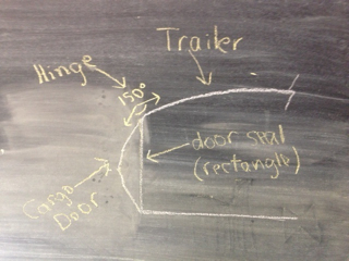

How else can I do this roof hinge? Posting here because since on my build the roof-line transitions to the cargo door panel with a rather sharp angle, instead of relatively flat, close to 0 degrees with the teardrop. On this build that angle will be more like 30 degrees (where a conventional flat backed cargo hauler would have the standard 90 degrees).
So the question is whats a good waterproof hinge that can do angles?
The better-than-hurricane hinge idea looks awesome, but upon closer inspection it doesn't appear to be able to do a 30 degree angle. 10 degrees probably, as I think its designed to be installed relatively flat.
Any suggestions on how else to accomplish this? The door will be completely sealed separately from the hinge btw so the roof hinge doesn't have to be waterproof. Just seems like a better way to go. Also consider making the hinges with 1/4" flat-plate, rods, and 1" square tube aluminum. Also considering aluminum piano hinge.

Postby ssuuki19 » Wed Jun 14, 2017 6:10 pm
Thanks for the pictures, and input, working on it.. sortof a three seal approach, but with the hinge beneath the first seal (conveyor belt) instead of on top of it and open to the elements. I might be able to do something like that, even with sheet aluminum to hold down whatever I can source for the 'conveyor belt'. Even if it only keeps the majority of water away from the hinge (in my case its one continuous) thats already better for the d-seal (as you refer to it), or door seal (as in the drawing pic) which in my case is rectangular by design for this very reason.. doors are tough. I was told back in the design phase to skip it, meh...
