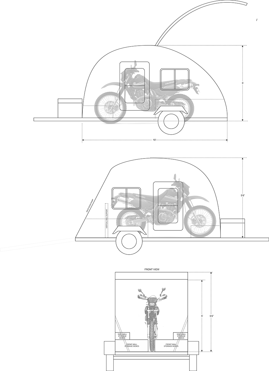

Hi, I'm a noob here. I've been checking this site out for ideas and finally got registered.
So here's what I'm hoping to build. I'd like to use the teardrop design incorporated into a toy hauler to haul a motorcycle in. My biggest concern is structural integrity in the rear end since I won't be using the traditional galley, that space will need to be open to get the bike in and out. I'm hoping I can brace the rear with metal supports as shown in the drawings (I need to learn how to use Sketchup). The bike will probably be my DR650 (380lbs) but I'm sizing it to also fit my Tiger 800 (500lbs.) if I decide I'd rather take that bike. Only one bike will go at a time given the space restrictions. I started out thinking a 5x5x10 should be big enough but might stretch it out to as big as 6'W x 5'6"H x 10'L. I'll be towing with a Sienna minivan so weight and aerodynamics are important. Hoping I can start with a landscape trailer if I decide to go with the drop down ramp design and incorporate the built in ramp.
Here's the ideas I'm starting with. I'd really appreciate any feedback I can get. My carpentry skills are decent enough but I have no welding skills so will have to hire that out if needed.
teardrop toyhauler.jpg (162.39 KiB) Viewed 6774 times

Postby Socal Tom » Thu Dec 28, 2017 10:39 am
My TD was originally built to be a Bike hauler. The PO used 3 inch roof spars to try and add more strength. I think if you do that and attach it to the frame in a very strong way and brace it well during construction, I think it would be ok. If it were me, I would add triangle gussets at the roof line and the floor, and probably add tie downs in an X pattern between them if I were going to be on rough roads. Just make sure you don’t put the hinge too far forward, because that would weaken the hole thing. Another thing you can do it to make the galley hatch narrow. If you leave some side at the back it will help hold it all together.

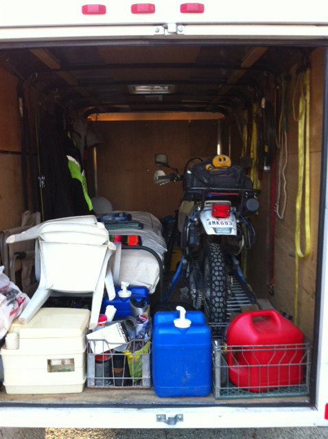

Postby swoody126 » Thu Dec 28, 2017 12:09 pm
DR in trlr.jpeg (118.18 KiB) Viewed 6743 times
sorry about the wonky pic i tried to rotate it to no avail
when i used my 5x10 cargo trlr to haul the DR-350 things were tight butt it did work
i could even leave my bed made up and for a storage point over & under...
i feel one key to doing this successfully is to have secure tiedowns thru the floor/frame so the skoot CAN'T move about while traveling
my personal solution is BEDBOLTS
http://www.bedbolts.com
they will work thru a 3/4" deck on top of an angle iron or stamped channel frame
and since the forged eyes can be removed & plugged for other purposes while being able to be replaced/used as needed i have employed them in other trailers as well
once the space issue is settled in your mind allz you gotz2do is plant the bedbolts and go on with your build
don't forget to make headroom for loading & unoading activities :shock:
while i'm here i might suggest tiedown straps w/ loop ends and ratcheting devices 'cause you'll need 'em in those close quarters
PINGLE makes a nice front wheel chock that can be removed and set aside while using the foor as a floor ;-)
http://www.pingelonline.com/prodcat/rem ... chocks.asp
positioning the side door(s) so you can reach everywhere inside the rig when packed/packing is real handy also
this sounds like a fun build
sw

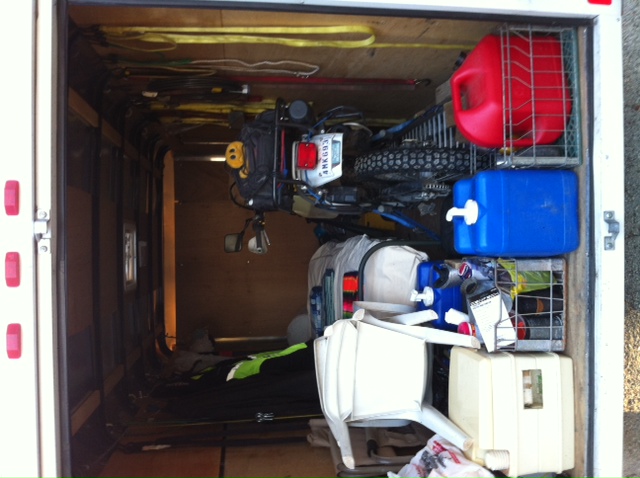

Postby Ride4321 » Thu Dec 28, 2017 12:21 pm
Tom: Looks like the original builder had the hinges up above the side door. Wow, I have no intention of going that far forward. Nice job fixing it up.
Swoody: That pic gives good perspective of space, maybe 6' width is in order. Headroom for loading/unloading is going to be a pain no doubt. I'll probably build a mockup of the sides with the hinge area braced with a support to see just how practical/impractical this will be. A couple sheets of luan or cardboard and some furring strips will give me a better idea if I'll even be able to wheel the bike in and out. An alternative would be an extended tongue and hauling the bike in front of the TD sideways but there goes the aerodynamics so not sure that's such a good idea.

Postby swoody126 » Thu Dec 28, 2017 12:47 pm
R4321, i forgot to mention the handle bars are shortened for woods riding which may give an appearance of extra room
doing an el cheapo mock up is sound
the 2nd pic in the OP has merit making a flop down ramp part of the trlr body
maybe a bit of an overhang above the ramp would help w/ weather issues
6' wide wouldn't be too much when considering the inside requirements
just factor in the width of the TV and ask if you can see around a 6' wide box behind it(one reason i like the 5 footer behnd my Jeep Cherokee)
have you considered a 6' wide body w/ the wheels inside the walls?
just have to set the trlr undercarriage so the foot pegs clear the fender well(no dropt axle)
sw

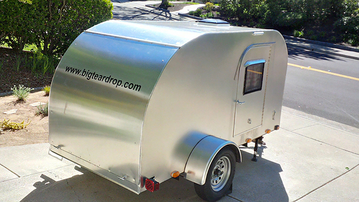

I did see plans for this design on eBay. This shape might work very well for my needs.
