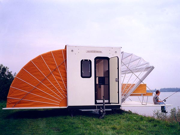

Postby AS115 » Wed Aug 19, 2020 10:02 am
Hi, I'm very interested in this concept!
I've been looking at the Slidavan, but I have a teen and pre-teen so just can't see how to sleep 3 in it unless there is a slideout in the front. I came across the De Markies and love the idea.
I will put it on a HF trailer, pulling with a minivan, so it has to be light. I have a 5x10 cargo trailer that is 6' height and the MPG is terrible when I pull even light loads.
To improve MPG, it would ideal to somehow marry the raised roof concept of the Slidavan with the fold out concept you found or the De Markies. I'm probably going to buy the Slidevan plans for the walls, lift, roof, and how to plumbing/electrical since this is my first build. But the shape has to be something different to fit my family.
Anyone have any ideas? I'm ready to build this fall...

Just came across this. Less structure, but that would allow more windows in the sleeping area.
https://www.asme.org/topics-resources/c ... -displaced
