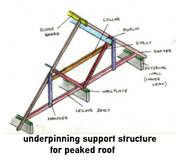

I can think of two reasons not to build a peaked roof trailer, especially a TD or TTT (a small home-built, not a standy, canned-ham, or humongous cargo conversion, of course):
  • 1) added work in construction...Most small TD's & TTT's use spars to support the roof, which is usually made of thin plywood with suitable covering materials. Easy to attach, without any purlins, hangers, collars, ridgeboard as extra supporting structure, and without a ridgeline seam to waterproof (a lot of sealant, paint, etc to maintain, as compared to a flat roof). Besides, the supporting members will diminish any headroom that may have been hoped-for with a peaked roof.

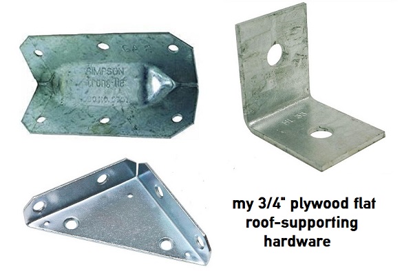

Granted, my little 4x8 squareback TTT is cramped inside, and just basically a box with a sloped front-end, but built as I designed it to fit in my garage (length & height restricted). I used 3/4" plywood with steel hardware (to support a flat 50"x 48" piece, requiring no spars underneath), and with no sag after 6.5 years, and capable of supporting double my weight.
