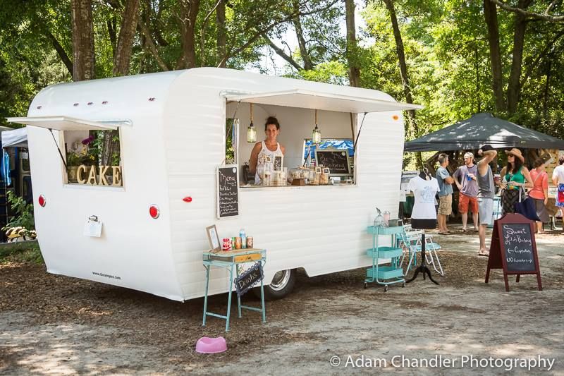

Postby MJWBuffalo » Wed Nov 20, 2019 9:02 am
retro camper food truck 1.jpg (106.45 KiB) Viewed 7676 times
So this is close to what I am planning on building.
Due to the weight and forces at play (wind, gravity, etc) on the awning windows, I was planning on using skeletonized construction with 2x4's laid flat (3.5" across") in the middle and 1/4" skins before aluminum on the outside (2" thick wall). I figured this would give me enough "meat" for my awnings to hang off of.
After continuing to read thread after thread, it seems the general consensus is that 3/4" ply construction is easier (my preference for first build) and up to the job for most small campers.
Here's the question du jour: Any suggestions on beefing up the 3/4" ply construction? Is it needed? Lag bolt the awning hinges through the ply? Maybe attach a long strip of metal or additional ply on the inside so I can use longer screws/lags and spread out the support?
Appreciate the help from the masters!
Matt

Re: Retro / Vintage Camper Food Truck?
Postby working on it » Wed Nov 20, 2019 11:09 am
MJWBuffalo wrote:... it seems the general consensus is that 3/4" ply construction is easier....Here's the question du jour: Any suggestions on beefing up the 3/4" ply construction? Is it needed? Lag bolt the awning hinges through the ply? Maybe attach a long strip of metal or additional ply on the inside so I can use longer screws/lags and spread out the support?....
Postby MJWBuffalo » Wed Nov 20, 2019 11:58 am
Thanks for your reply. It gives me a lot to think about.
Maybe I can glue/lam and screw a 2x4 above the awning windows and then bolt the hinges through that with the large fender washers.that would help spread the forces out along the entire length.
I might have a couple of spots where I could work a beam across the trailer to connect to the other side without getting in the way... just for extra support.
Thanks again,
Matt
MJWBuffalo
Posts: 33
Joined: Tue Oct 22, 2019 2:51 pm
Postby Pmullen503 » Wed Nov 20, 2019 3:08 pm
Look at how galley hatches are done. These are probably heavier than your awnings will be and they're subjected to the same forces. Also Think about how you can make those awnings as light as possible. Foam core rimmed with an aluminum extrusion and aluminum skin.
Postby MJWBuffalo » Thu Nov 21, 2019 9:46 am
Pmullen503 wrote:Look at how galley hatches are done. These are probably heavier than your awnings will be and they're subjected to the same forces. Also Think about how you can make those awnings as light as possible. Foam core rimmed with an aluminum extrusion and aluminum skin.
Good Idea! I hadn't been thinking of making them light, only secure. I've actually broken signage, etc on my hot dog cart from wind so I am especially sensitive to this now. The window will be around 6' Long at its longest.
I was considering 1"square aluminum tubing covered in the same metal skin as the trailer but maybe I can come up with something else that would be strong and light.
Thanks
Matt
Postby mallymal » Thu Nov 28, 2019 6:35 am
Are you considering insulation?
I’m assuming you won’t be sleeping in it, but it might help avoid consdensation.....
Also in the retro pic you posted, the lift up servery hatch is on gas struts.... defo the way to go, as they will obviously prevent it dropping down, but also prevent it being blown upwards and straining the fixings.
Good luck...,, look forward to seeing it progress...
Postby MJWBuffalo » Tue Dec 03, 2019 9:35 am
mallymal wrote:Are you considering insulation?
Thanks for the suggestion. Part of the reason to build this is to work in it throughout the winter. Even with windows open, having some insulation in the walls and ceiling will definitely help.
As for the struts, that is a definite.
