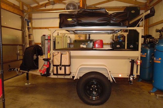

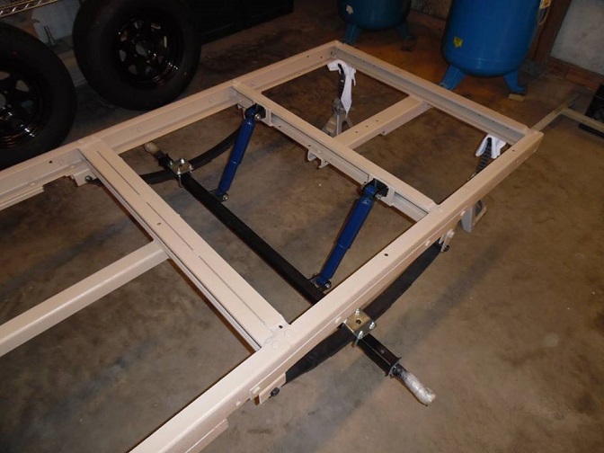

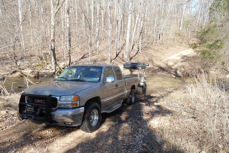

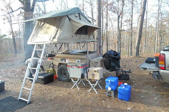

Postby ArkansasDon » Wed Feb 19, 2020 8:37 am
my 1st build (several years ago) was a roof top tent trailer. I used a Harbor Freight Super Duty trailer frame which I done a lot of modifcations to & fabricated a new tongue. I added new suspension w\ shocks using the 2000lb axle. The tub kit I purchased from Dinoot which was their M Series w\ CJ tail gate. The chassis size is 40 1\2" wide X 72" long, the tongue I fabricated is 5ft 9" long. The roof top tent I used was Smittybilt 2783, with a Teupi Roof Top Tent Insulator which made the tent 4 season & we camped in the 20's & was warm. The Teupi Roof Top Tent Insulator can be installed in the tent in 4 minutes & will take just as long to un-install it for warmer weather camping. The roof top tent sets up in minutes, it would take Sally & I from unbuckeling the cover to the tent fully set up in 5 minutes.
Only reason why I sold this trailer (last year) was the wife & I are in our 60's now & was afraid one us would be injured going in or out of the roof top tent at night for those late night bathroom runs. This trailer was a project that took me 10 months to build, I done all the work, electrical, solar, fabrication, paint work, truck bedliner. The Harbor freight Super Duty trailer chassis is a great platform to build off of "if" you weld it together, scrap the tongue & fabricate a new one with a 2" backbone. Scrap the original suspension (slipper springs) & go with Scott Chaney's Compact Camping Concepts Harbor Freight retrofit smooth ride spring kit. Scott Chaney also owns Dinoot Trailers were he sells tub kits on & offroad trailer parts.
Now we have a squaredrop trailer.
forum (10).jpg (102.52 KiB) Viewed 6843 times

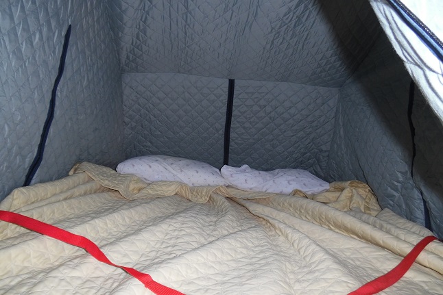

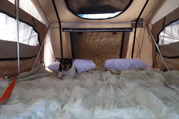

Postby ArkansasDon » Wed Feb 19, 2020 8:49 am
since I can only post 3 pic's per post the Tepui Roof Top Tent Insulator is pictured installed & w\o the Roof Top Tent Insulator. The Roof Top Tent is a great product & make for many good pro's than con's. The only con to a roof top tent "I" can find in several years of use is late night bathroom runs climbing out & back in.
