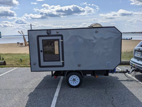

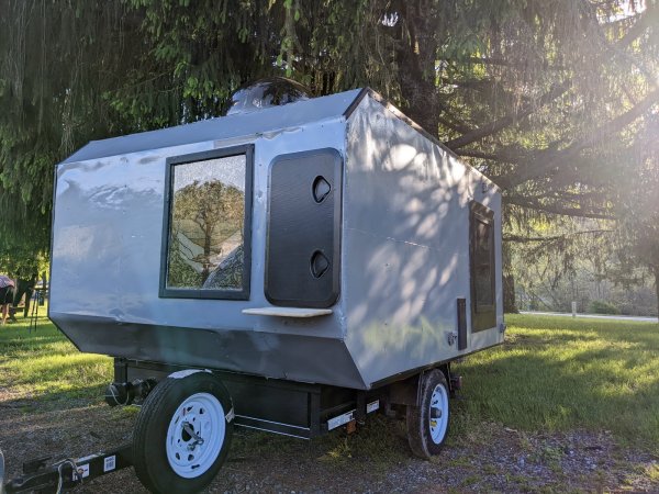

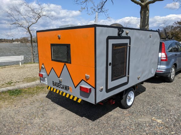

Hello all,
Completed a 6' x 9' "squaredrop" camper about six weeks ago. I think the design is a bit unusual in that it's actually got a bathroom with flush toilet, sink and shower. The "living" area is slightly under 6' x 6' and the bathroom is roughly 5' x 3' (2' at the floor then bumps out). Headroom is 4'.
The bathroom is separated from the living area by a wall and sliding door. The bathroom also has a 9" well in the center for standing with a dome in the roof which gives roughly 5'8" of standing room (but only dead center). It also has a bench.
It's got AC electric and water hookups. Also has a 12v battery, inverter, water pump, USB charger for off-grid. The camper sits on a Lowes utility trailer with a 4' x 6' bed and can be removed. I didn't buy the trailer for this build.
So far I've used it six nights, four nights in campgrounds and two nights off-grid (two nights with my wife), and I'm pretty happy with it. My main reason for having it is going to events called "Adventure Races" where you bike, paddle and trek over a course plotted on a map. Typically these races are several hours drive from where I live and start very early and sometimes end late (they can be 4 to 12 hours or longer).
The bathroom is actually very functional. Nice not having to get out and walk to a messy public restroom - especially when it's cold and rainy. It's got a traditional holding tank setup and flush toilet.
Build cost, not including trailer, was north of 2k but less than 3k. I may add up the costs at some point.

Postby Mark Williamson » Wed May 10, 2023 5:10 pm
Thanks! I've actually completely redesigned it and rebuilt it. Same concept. Website below. It was 6 x 9 but now it's only 4 x 9. Bathroom is a bit smaller but more headroom for sleeping. The reason I made it smaller was to try to stick within 4x8' lumber, foam and FRP size for an easier build (and less chance of leaks). Also it's much lighter so is much easier to tow with my Honda CRV 4 cylinder.
The walls are FRP outside, foam and 1/2"x2" wood frame core, and 1/4" ply on the inside. Naturally, the foam didn't adhere properly to the outside so it bubbles in the sun. Yep, I read about FRP and still went ahead with it. Don't mind the bubbles. Added a propane hot water heater (off grid, uses a few D batteries). The inside is also much nicer. Works well for one person. I've spent three nights in it. Will be camping with my wife in a couple of weeks so that'll be the test. It will be cozy at night and a challenge to get in and out of the bathroom. We'll see. Luckily we're both on the smaller side.
Check the link below for photos. I'll update it soon.

Postby Mark Williamson » Fri Jun 30, 2023 5:46 pm
Hey Evan,
I don't currently have any other photos of the bathroom. Will try to get some decent ones. Such a small space that it's difficult to photograph. Make sure you check out all the photos on this site if you haven't: https://basecampr.godaddysites.com/
For the framing I ripped 2x4s. 1/2" x 2" I believe. Some 2x2". I used FRP from Home Depot or Lowes. Really would not recommend or make sure you bond it very well. Mine bubbles up in the sun where it isn't bonded. I think it didn't stick to the foam. Should have known. I also used caulk and probably didn't get as much coverage as I could have. I've been thinking lately that I should have used fiberboard which is very cheap - $15/sheet - and painted it well - then stored the camper in my garage. The few times it's out in the rain wouldn't soak it enough to damage it. I have another project which is spray painted fiberboard that is actually out in the rain as I write this and is holding up well. That's my cheapskate solution FWIW.
My wife actually did pretty well. It's quite cozy at 4' wide. 6' would be much better. Getting in and out of the bathroom at night is a bit of a trick but do-able. An outside door to the bathroom might be better - especially in decent weather. But the bathroom is very functional. I may find a better solution for the sink which is on one side of the toilet. Maybe fold down in front of the toilet. Also, I currently have the dome over the toilet which really isn't necessary. Might move it to in front of the toilet so we can partially stand before sitting. Have a few inches bump over the toilet should be fine.
The previous iteration probably isn't worth looking at except as a cautionary tale. It was 1/2" plywood with some framing. Ugly on the inside. No insulation. The plywood does make it easier to construct. If you go that route then I'd recommend measuring and cutting very carefully and having a firm idea on the design. Otherwise, like building anything, ill-fitting corners and revisions are a pain.
One thing to note. If you plan on getting this thing off the trailer then plan accordingly and don't think it's an easy task. It's a lot of weight and if not planned, a serious PIA to get on and off. Not sure what the best way to do that is.
If I had a couple of kids I might consider putting a tent on the roof - or a tent next to the camper. Depends on the age of the kids. I think it would be a real space challenge inside. I guess there are other builders who have pulled it off and had it appear workable.
Hope that helps. Let me know if you have any other questions.
