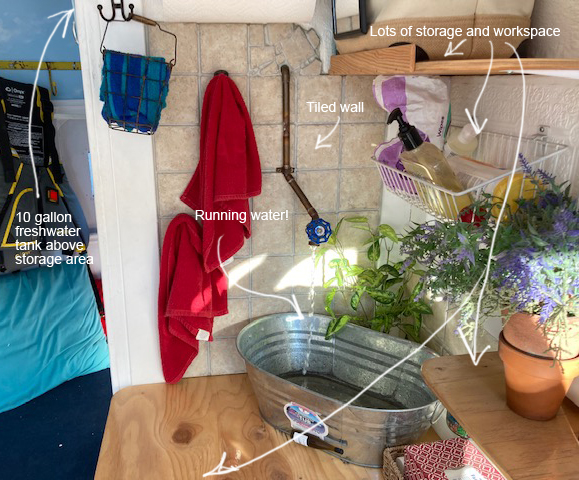

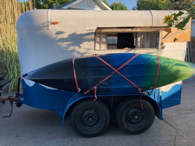

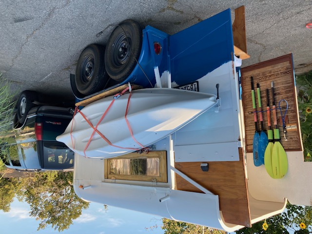

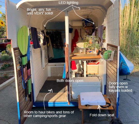

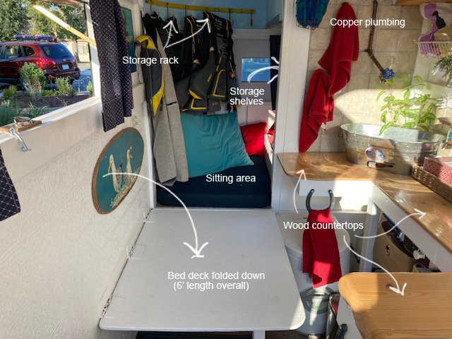

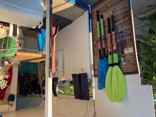

Yeah, I'm talking' horse trailer conversion! It was so damned much fun to do because there was no way you could accidentally damage anything during the first phase because it's a solid metal box! Cutting and grinding and welding and more grinding... then the fun part where the internal construction could be as heavy as necessary. Remember this thing was designed to carry two big horses and not warp when full. So, for $800 I took this baby off the local farm from a lady who saw no value in the thing.
I won't go into too much detail on the hollowing out suffice to say that I replaced the heavy duty floor boards, added wall panels (ply) and started in like a carpenter with a time limit.
The front area became a seating for one with storage and a shelf off to one side. Above the seating area I put a 10 gal water tank and ran a line for gravity feed to the sink on the other side and a fill tube that reaches out the front hatch to refill.

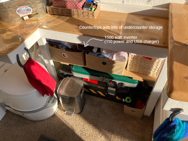

Made a fold down bed to extend the seating area and it reached a full 6 ft. Build a wraparound counter top with various levels, and shelving underneath. The inverter was staged under the counter for easy access and the battery lines were hidden as they reached the front compartment under the seating area and hooked to my deep cycle marine battery. The faucet was a hose bib at the end of the gravity fed copper pipe, and the sink was a galvanized tub with a water container catch below.
Had my portable toilet tucked under the counter area, a cooler space, storage bins, and the gas grill. U had mounts for all my kayaking/paddleboarding gear, towel/clothes space, and food storage. The walls were wallpapered with a beautiful textured paper, Italian tiles, and fully carpeted floor.

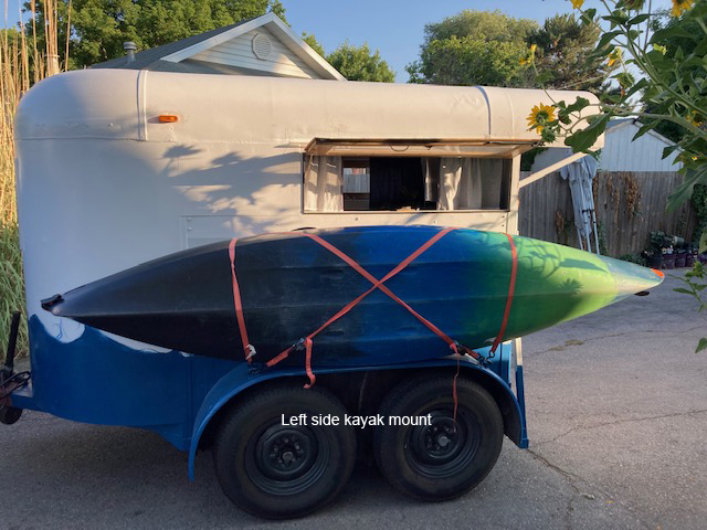

It was so useable and functional. I highly recommend you consider this option if you are seeking a new rig! It had twin axles so it was stable and pulled like a dream. I mounted hooks and loops and d-rings all over the place so I could haul my kayaks on the outside, or whatever I wanted to load up. I was going to add a solar panel or a roof deck to sit on and watch the World go by where ever I stopped.
Nothing required winterizing as all systems were removable (battery, water tanks, toilet)
Feel free to ask questions.
