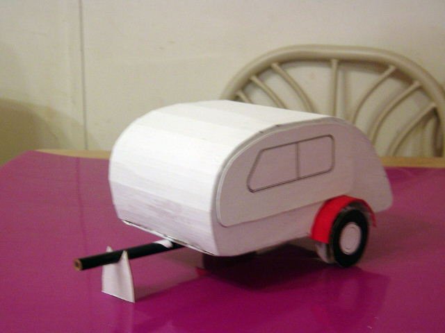

Postby Marck » Tue Aug 31, 2004 10:49 pm
Thinking about it a while, I came up with an idea.
Please check it out, and tell me what you think.
The idea and pictures are on my website.

Postby Nick Taylor » Wed Sep 01, 2004 12:32 am
Cool design. You'd certainly win the award for getting the most people in a teardrop at once. Only problem I could see is if one of the kids needs to go to the bathroom in the middle of the night.

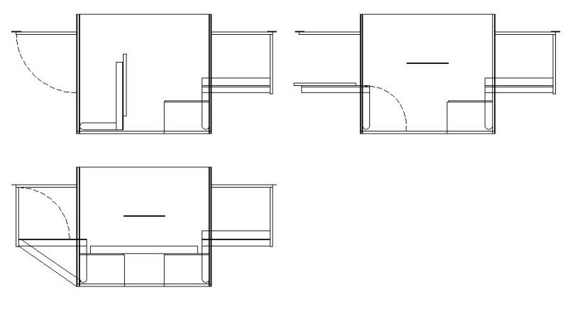

Postby mikeschn » Wed Sep 01, 2004 3:45 am
of-thestorm wrote:Thinking about it a while, I came up with an idea.
http://users.adelphia.net/~marckm/teardrop.html
That is a good way to add sleeping arrangements for your children. Very nice, I like it!!!
P.S. The slider should be on the street side, and the door should be on the curb side! :wink:
Like this...
Postby BufordT » Wed Sep 01, 2004 4:24 am
I also like the idea very much.
How are you going to build the slider part?
How wide is the slider part going to be? appears to be around 4 ft.

Postby Marck » Wed Sep 01, 2004 6:56 am
Ok first off, mike how'd you do that??? never was great with graphics myself, but I do agree, I didn't think of the fact that I was putting the door out in the street.
As for how I will do the slider, I have been looking at a roller set up, it's like a very heavy duty drawer slider setup.
The slider will be about 4' X 5', not quite sure yet, will let you know when I get it all figured out.

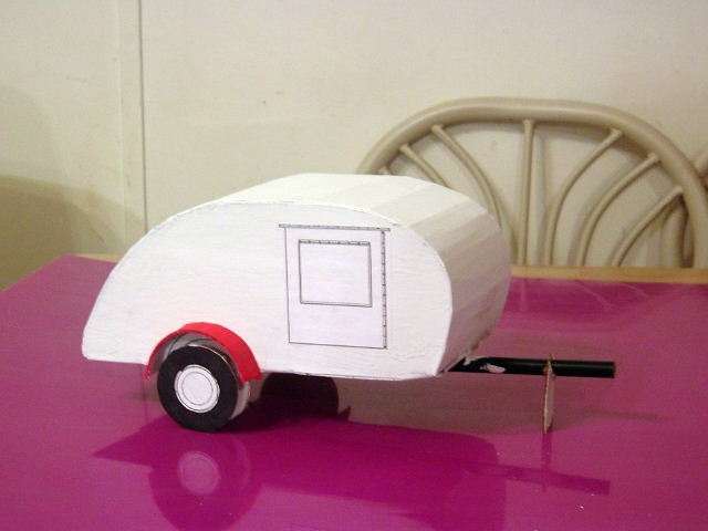

Postby Marck » Sat Oct 09, 2004 9:41 pm
More updates on the six-pack tear model.
http://users.adelphia.net/~marckm/teardrop2.html

Postby Flyfisher » Mon Oct 11, 2004 7:06 am
It looks pretty good to me. The problem I had when looking at doing a pullout that size was the cost of the slides. When I designed my own slides, they were bulky but that was because they were made of wood, if you are an accomplished welder, then you could make a small enough slide I believe. One thing I did notice and liked is how you had taken into account that part of the slides frames left on the inside could run the entire length of the bunks on one side and cabinetry on the other.

Postby DANL » Mon Oct 11, 2004 7:48 pm
Hey Mike, Your fold out is very much along the lines of what I'm thinking about for my next trailer. The difference is that the floor of the extension is hinged at the point where the wall and bed platform meet. To provide strength the frame of the opening is welded up from rectangular section aluminum.
The roof of the extension is hinged with a hurricane hinge and is slanted and protrudes further than the floor in order to allow rain runoff. The outside wall works about the same as the one you have drawn but the endwalls fold up and have flanges that lock into place against the frame of the opening to keep the floor perpendicular to the trailer wall.
This foldout is intended for use with either of two trailer designs--both are five feet wide, five feet high, and eight feet long on the trailer deck but hanging out over the tongue about two additional feet. Popups are optional and, if used, would be hinged at the front and pop up at the back. They would have solid walls similar to the Compact design that Angib is working on.
The first trailer is shaped basically like a vertical wedge front cargo trailer with the door in the curbside wedge, full width galley in back, dinette type berth on the street side and foldout on the curb side. The other design is a "rimple" sort of shape with a vertical back, the two foot wide door in the back wall on the street side and hinged on the street side next to a galley only three feet wide. This one has the dinette on the curb side and the foldout on the street side.
Pretty complicated explanation but I haven't had time to draw these up yet. With cold weather coming, my wife wants to get her car into the garage so it's time to clean up the mess from trailer construction.
