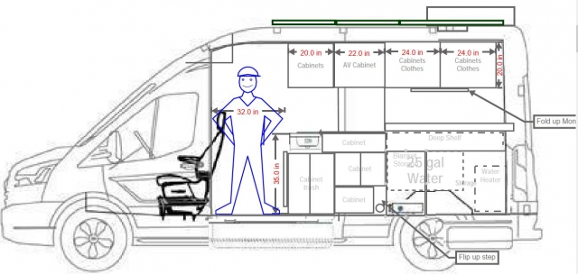

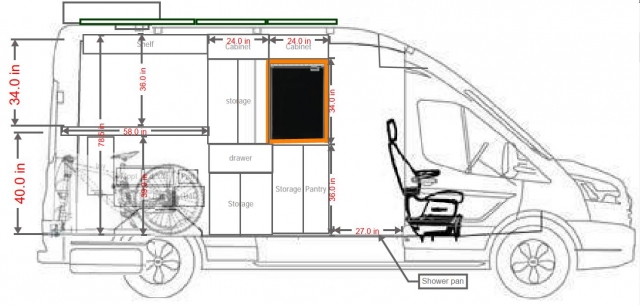

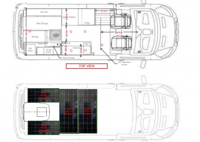

Postby bdosborn » Fri Feb 18, 2022 10:26 am
The resolution is low but here's my van plan:

Postby noseoil » Fri Feb 18, 2022 10:59 am
Looks good on the design, do you have access to some honeycomb or maybe balsa-core to build the cabinets? Would be a bit more expensive, but it would shave off a lot of weight if you can find some...

Postby bdosborn » Fri Feb 18, 2022 2:17 pm
noseoil wrote:Looks good on the design, do you have access to some honeycomb or maybe balsa-core to build the cabinets? Would be a bit more expensive, but it would shave off a lot of weight if you can find some...
Yeah, weight is something I'm really trying to watch. I plan on making the cabinets out of 1x2s and 1/8" plywood. That's how I made the trailer cabinets and they came out pretty light.

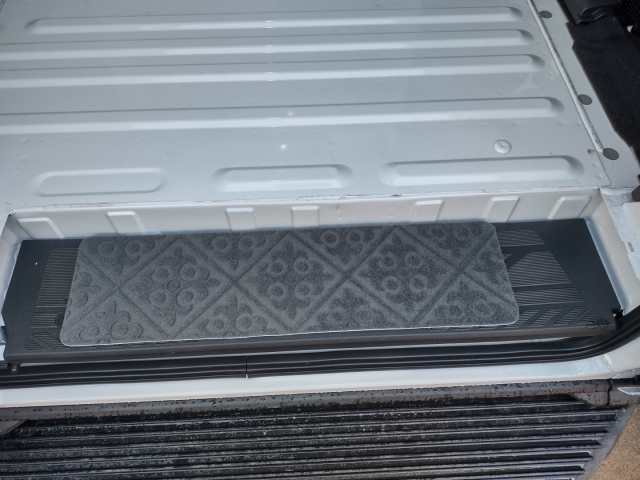

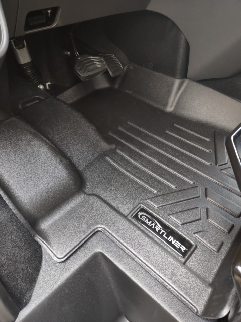

Postby bdosborn » Sat Feb 19, 2022 9:49 am

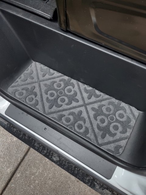

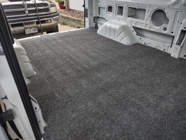

First step in the conversion is to try and protect our expensive new van from bumps and scrapes.
Floor mats. I always get floor mats in all my vehicles, even with the factory floor mats.
These are stair runners on the entry steps. The plastic steps look terrible after a few dirty shoes hit them so I thought we'd try this to to keep it nice for awhile:
I bought a bed rug carpet to protect the shiny new floor during construction. The fit was better than I expected; it's molded into the corrugation of the floor and the sides fit flush with the protrusion of the van:
I plan to build up the floor with insulation in the front part of the van but not in the garage (under the bed). This will give a nice finished floor to the garage. I'll lay the insulation right over the carpet when I build up the floor.
