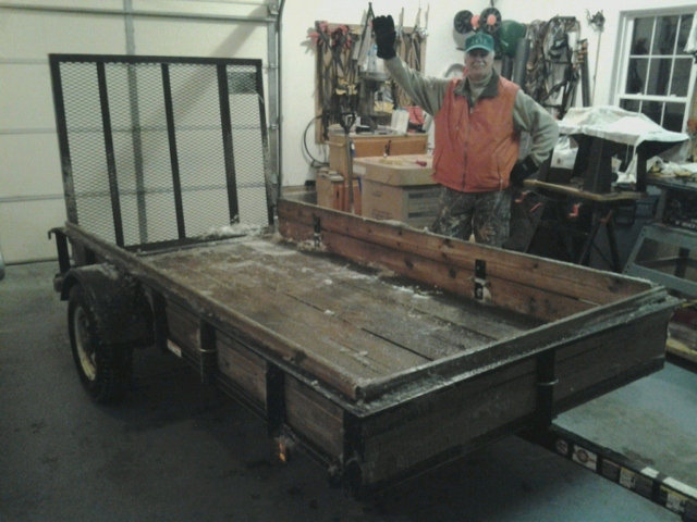

Postby lfrazer98 » Tue Nov 26, 2013 6:40 pm
Hello! My Dad and I picked up our 5 x 10 trailer today (11/26/13) after a snow storm started, but we got it back to his house, wiped off, and stored away for the night. He jokingly asked if I wanted towels to wipe it dry. I thought about it :roll: but I will save that for after it is built. Smiles all around since we finally found the trailer size we wanted at a fair price. I am hoping to take some metal off tomorrow, but it might have to wait until after the holidays. So for now, here is a hello from my Dad (Jim), my partner in crime during this very exciting project.

Postby wyldesyde007 » Tue Nov 26, 2013 6:48 pm
Hi Jim!
Hurry up and post some pics of what you guys intend to do with your find! ;)

Postby RandyG » Tue Nov 26, 2013 7:11 pm
Hi, nice trailer. Looks like Jim has a nice shop and knows a thing about craftsmanship. What type of build are you going for?

Postby oakinteriors1 » Tue Nov 26, 2013 7:16 pm
Looks exactly like my 5x8 I started with only I had the steel mesh floor .... Looks like a decent sized shop to work in their Jim.. :thumbsup:

Postby jffrazer » Sat Nov 30, 2013 10:34 am
We are excited to get going with our project. Particularly excited about the support and encouragement from all of you on this site. I am sure we will have ample questions as time wears on and we thank you in advance for any advice you can tender.
We had to take a break from starting due to Thanksgiving and travel. As mentioned in an earlier post we have a carry-on trailer frame at 5 x 10 ft. Axle situated at approximately 63 percent of frame length - we'll within the 60/40 percent guideline I have seen. Frame height is 15 1/2 inches (13 in tires/ wheel).
Next will be stripping and cleaning up the frame including removing excess steel rail and ramp.

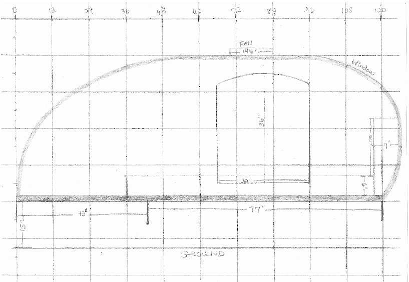

Postby lfrazer98 » Sun Dec 01, 2013 7:43 pm
I hope everyone had a great holiday. I spent it with my family, but had numerous hours to sketch out a scaled drawing and read some posts. Below is my first draft. I printed out the profiles of the Grumman 2, Superleggera, and Kenskill and this is what I came up with. I have some measurements in the drawing, but having touched the galley yet. I shaded the perimeter for ~2" wall/insulation and added in a queen size mattress, door(s), headboard storage, fan and overhead window. Here is the sketch and I will reply to the other messages after. Thoughts?! :D

Re: Father-Daughter Build 2013-14
Postby lfrazer98 » Sun Dec 01, 2013 7:54 pm
Esteban wrote:Steve Fredericks www.campingclassics.com has an inspiring gallery of woodie trailers he has built. His shop manual and his "inside out" construction method are both time (and back discomfort) savers. It is well worth buying one.
The profile you like looks nice. :thinking: Maybe it could use some additional framing where cabinets and or shelves will need support? The cut outs suggest you are considering insulating your walls by using an internal framework that will have plywood skins outside and inside. 1/4" outside and 1/8" inside are good. Epoxy and/or fiberglass can protect the wood. Then protect the epoxy from sun damage with varnish. Raka.com is a good epoxy supplier.
:thumbsup: If you do decide to put in an electrical converter the Progressive Dynamics PD4045 is a good one to consider. bestconverter.com/4000-Series-Compact-Power-Center
:thumbsup: I wish I'd thought ahead to add an electrical junction box under my trailer to make it easy to wire my trailers running lights and to trouble shoot and/or make upgrades in the future. delcity.net/Stud-Type-Junction-Box
:thinking: Is your trailer licensed now? (It probably is.) If not it can be easier, and less expensive, to license it with just a floor rather than waiting to license it when the camper is completed.
:thinking: Another question, will you want a tongue box? If so now is a good time to add/weld support(s) for one to the straight tongue. Maybe steel from the loading ramp could be reused for the supports?
Hello! Funny, my Dad just mentioned building the woodie sides from the "inside out" so that any attachment points could be hidden by the exterior skin. I wonder if what he was describing is the same as in the link. I will definitely read it and pass it on to him. Last night we also both agreed we would probably use 1/8th" skin inside and 1/4th" outside as you mentioned. I also mentioned the epoxy to him today in the car on the drive back home. Looks like we are on the same page as you! The trailer is licensed, but I will need to transfer it officially at the DMV still. We did talk about the tongue box (because we do want one) and thought we could use the ramp and modify it for the box. Is it necessary to put supports under it? We saw a picture of a rectangular one that was bolted to the frame and had two "U" bolts to attach it to the tongue. If I need to, I will ask someone to weld on some steel to make the tongue an "A", because I think we need someone to weld on stabilizer jacks and an accessory or two anyway.
Off to read more posts!
