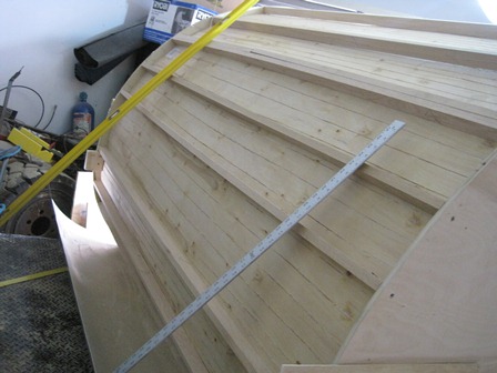

Postby BuildingForFun » Tue Sep 02, 2014 8:03 am

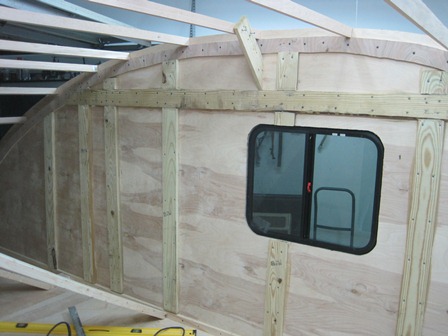

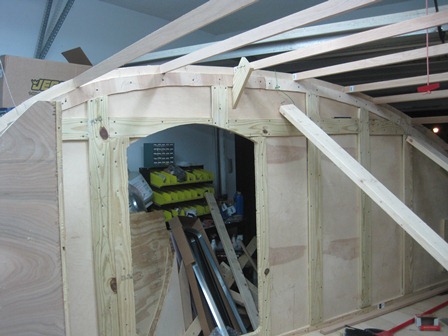

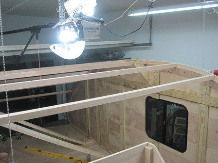

Last night I was able to fasten some more roof joist, cut out the window opening for the drivers side, and mock up the closet space in the front.

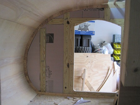

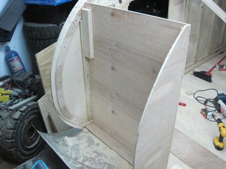

Postby BuildingForFun » Tue Sep 02, 2014 8:06 am

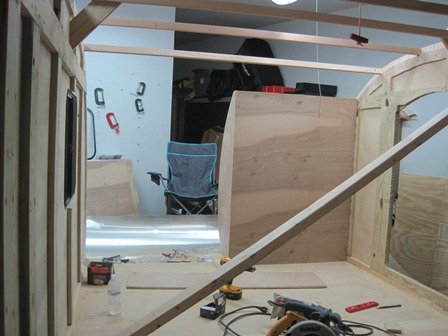

Photos below are of the front closet mock up space...(no door cut yet)

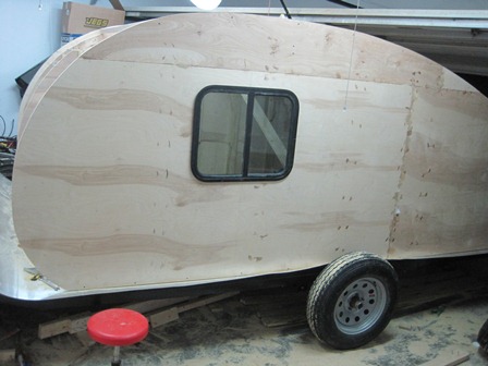

Postby BuildingForFun » Tue Sep 02, 2014 8:07 am

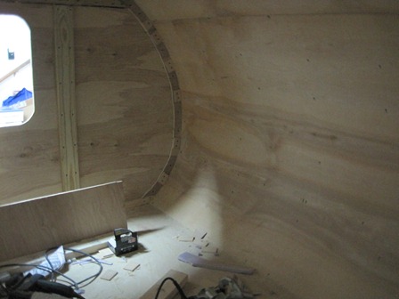

More photos with the window......

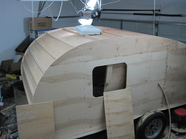

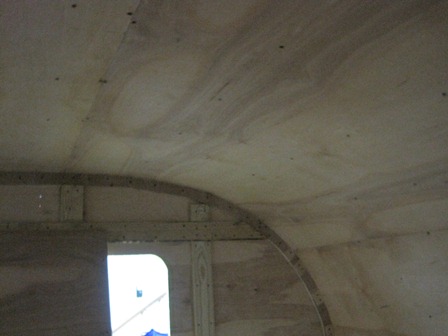

Postby BuildingForFun » Mon Sep 08, 2014 11:06 am

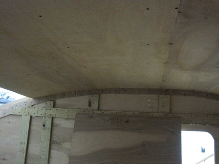

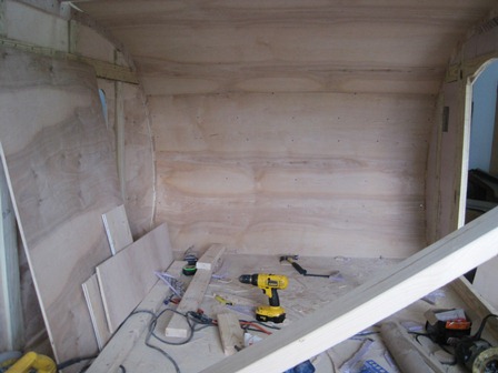

I have added the interior panels to the roof, and should be adding a interior wall panel tonight, or soon.

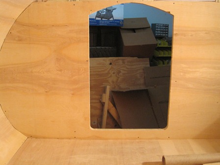

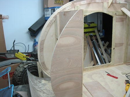

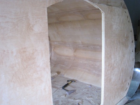

Postby BuildingForFun » Mon Sep 08, 2014 11:09 am

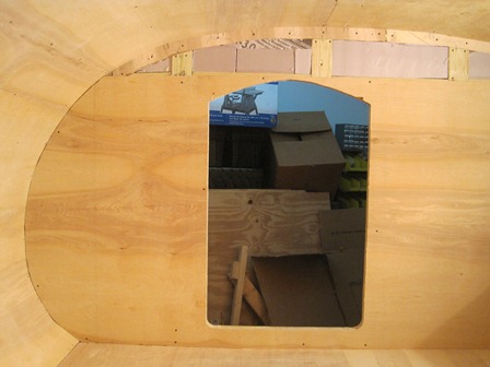

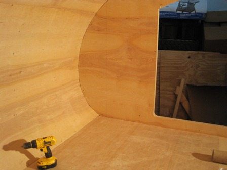

More photos of work.
To bend the ply wood panels, I first tried soaking beach towels, and putting them in the dryer to get them hot and moist. But as soon as I put them on the plywood, they turned cold, and were drying out. So in the end, I cut the plywood about a 16th of an inch as shown. This seems to have worked great.

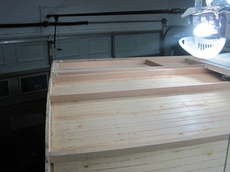

Postby S. Heisley » Mon Sep 08, 2014 8:21 pm
You certainly are doing a nice, neat job on that teardrop! :thumbsup:
It looks like that vent is going to be awfully close to your overhead garage light. Are you going to be okay on that? :NC

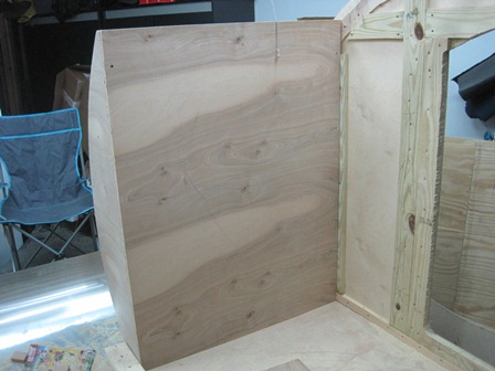

Postby BuildingForFun » Wed Sep 10, 2014 10:37 am
Last nite I cut and added one of the wall panels. Unfortunently this will probably be the last progress I make on it for a while, due to the fact I will be working out of state for over a month. :cry:
