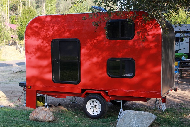

We took the camper out for our first camping trip. All worked as planned, and we had a great time! It towed very easily (weighing in at about 1000 lbs), and was a comfortable sleep for my family. for this first trip we kept it pretty close to home travelling only a total of 200 miles. Her is a pic from the campsite...again thanks Sharon, KC and all who helped and provided advice and encouragement during the build.

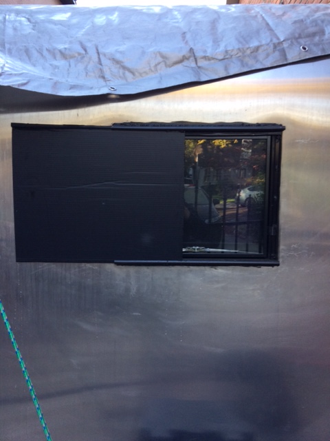

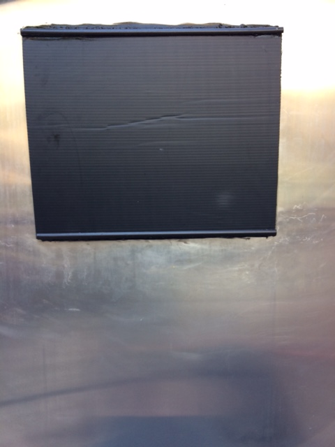

For the front facing window I made a very simple rock guard. I bought a cord guard like this one: https://www.wayfair.com/Wiremold-CordMa ... .html?PiID[]=9405292&source=hotdeals

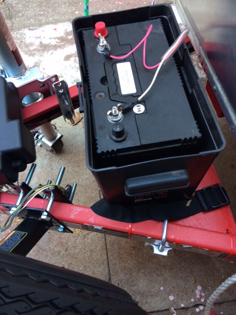

And cut it, painted it black and silicone caulked it into place at the top and bottom of the window frame. I bought a piece of corrugated plastic and cut it to size and just slide it into the Channel created with the cord guard. It cost about 18 dollars and took about an hour to do. Also as KC suggested I secured the board that holds the battery box to the tongue with square shoulders u bolts on either side.

pick of battery box board secured to tongue with square shouldered u bolts.

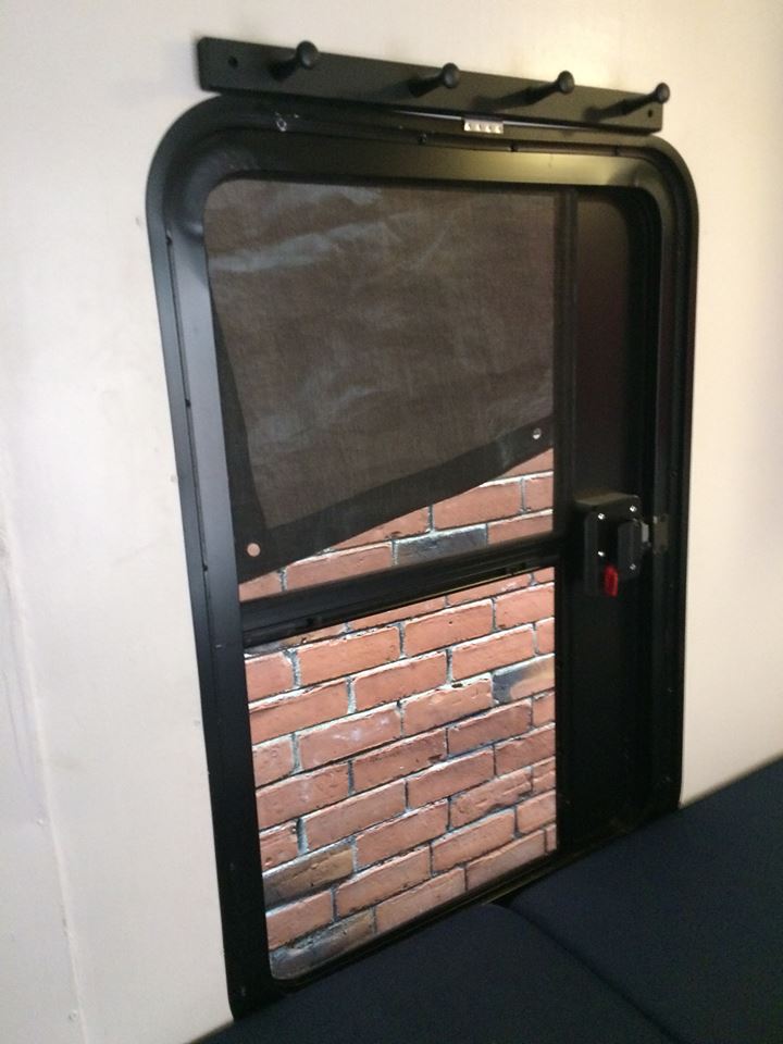

I made a couple of updates since I needed more storage, and in cooler weather camping we don't want to have to leave the camper at night for bio needs:

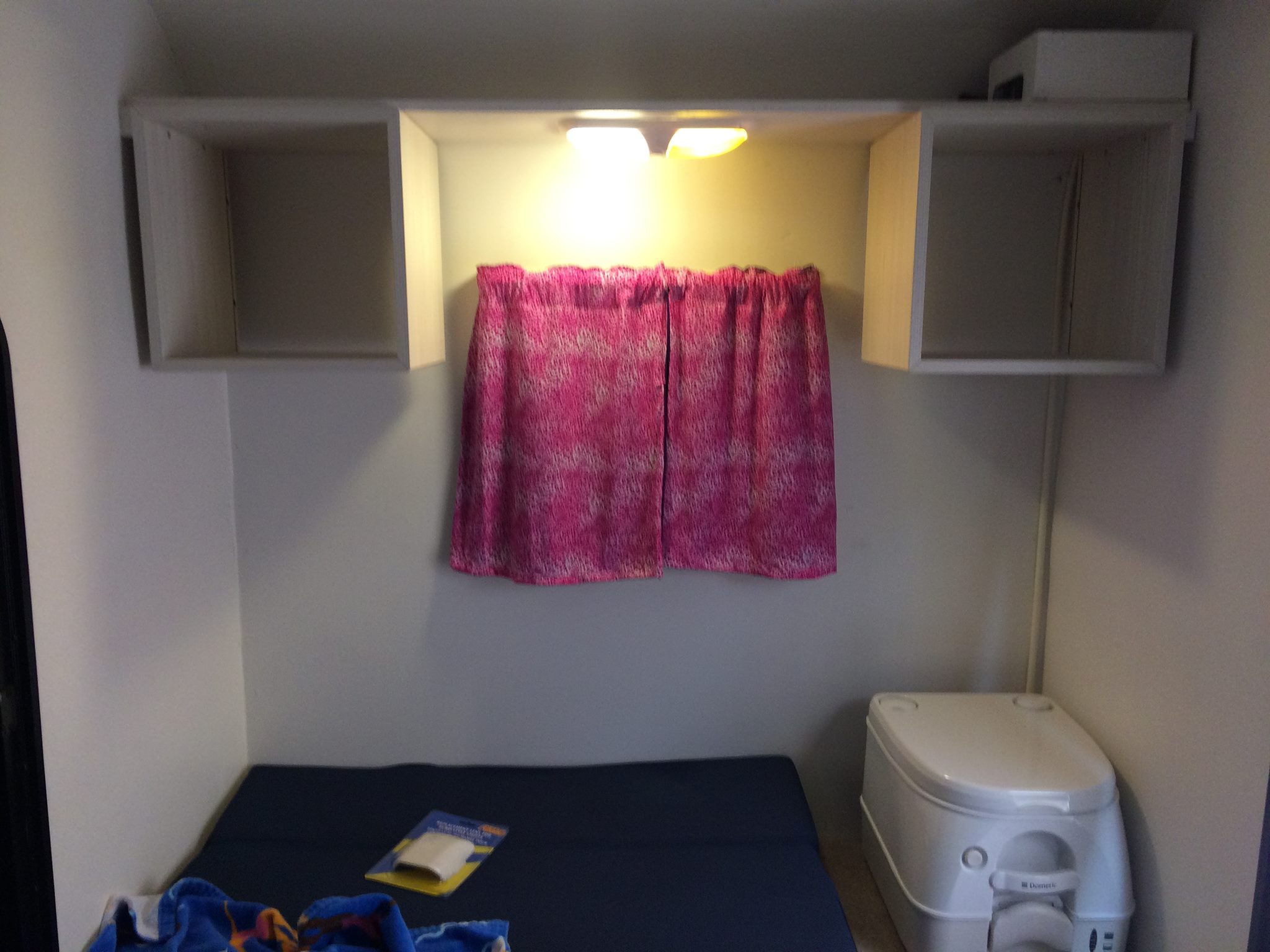

I added two cabinets/storage cubes (bought at IKEA) and attached to the underside of the front shelf. they are simply screwed in from the bottom up into the shelf and also screwed into the shelf framing.
I added coat hangers (wood bars with pegs) above each entry door. This adds storage capacity and acts as curtains at nights

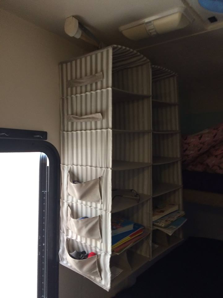

I hung two cloth wardrobes (also from ikea) by means of installing a hanging curtain rod (cut down to size) into the roof spars.
I swapped out my queen size folding mattress for an xl twin size and bought a dometic porta potty that stay in the camper at night
