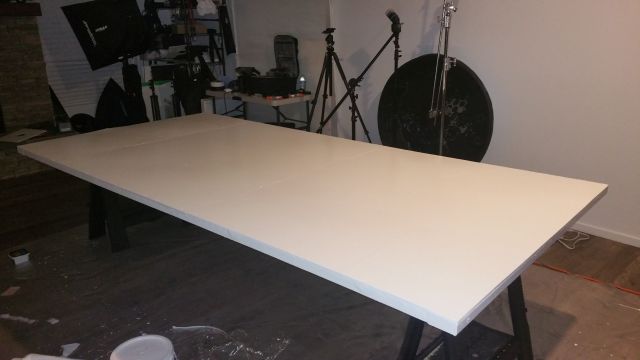

Low temperatures forced me to haul the floor inside to paint the underside. Dry and back on the trailer (this side down) I can start building the walls onto it.

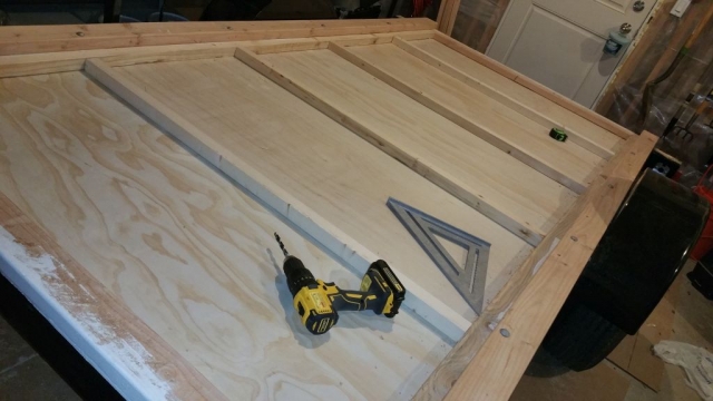

Back in the garage and bolted down. It probably doesn't look like a lot of progress but it was a good amount of work. I think I did it the hard way, by drilling the bolt down holes in the frame first and then trying to match the holes in the floor to them but I didn't want to risk drilling the wrong part of the steel frame.
The second 2x4x10s are the base of the walls, they're spaced for the outer ply from the fenders and the carriage bolts will remain exposed as part of removable teardrop box from utility trailer design.
