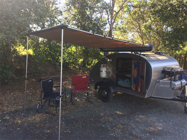

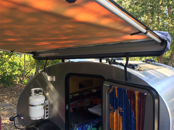

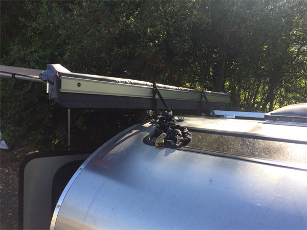

Postby drewh1 » Sat Jun 09, 2018 3:49 pm
latest edition before heading off to eastern Oregon - ARB 2000 Awning System. It is mounted with removable brackets so I can move to either side of the TD.

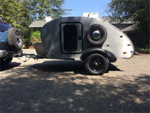

Postby drewh1 » Wed Aug 15, 2018 4:58 pm
Continuing to upgrade for more off-road travel. I added a Lock & Roll hitch and larger wheels and tires. Wish I had done all this sooner. The wheels and tires look so much better and give me almost 20" of clearance. I used one of my 14" wheels for the spare as it is smaller and lighter.
The hitch seems great, super easy to connect, actually much easier than the ball hitch. It backs up well and seems very solid and added about a foot of extra clearance between the car and the TD. I'll test it out in Utah in September. All that's left is new wiring connector (the old one is too short now).
