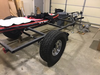

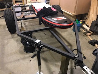

Here is some pics of the frame at the moment. still a work in progress but mostly how i bought the frame off the guy.
I added 10" dexter brakes and changed the hubs out to 6 lug to match the spare on the 4runner.
The wheels came off one of my Land cruiser builds many years ago and I'm pretty happy how the old school chrome came out.
