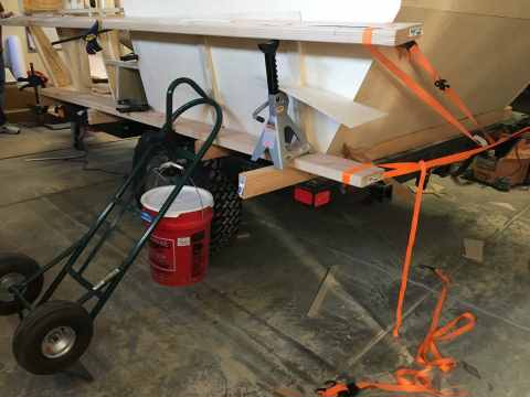

Postby FLFLYIN » Tue Jan 01, 2019 9:57 pm

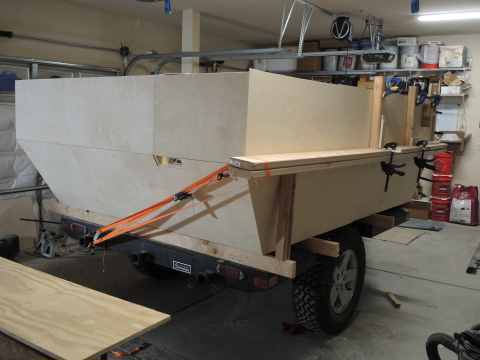

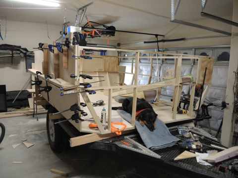

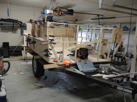

Most Importantly Piper has approved of the work so far!
Note the 2x8's we are using for clamping with lots of shims.
Not to mention a lot of regular clamps

Re: Piper's Cub House
Postby FLFLYIN » Tue Jan 01, 2019 10:02 pm

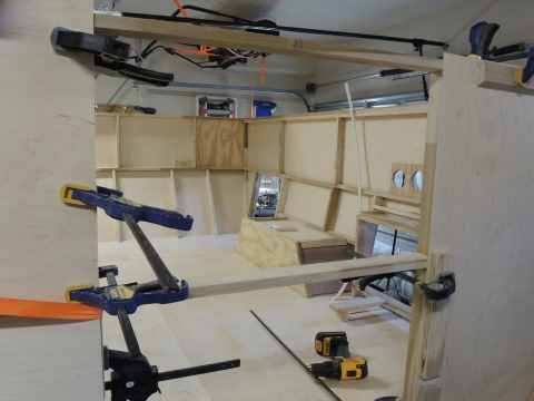

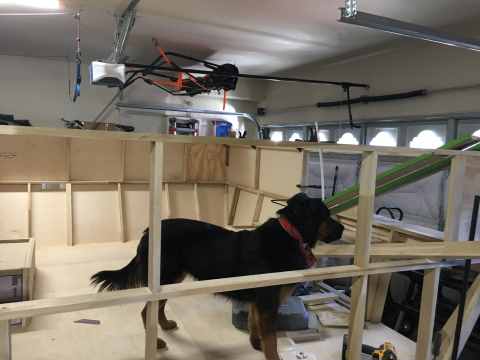

... a view from the back
note the rachet straps used to hold the 2x8's
Also, the Cabin is setting on 2x4's to allow us to set the side walls at the same level as the bottom of the floor section.

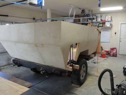

Postby FLFLYIN » Thu Jan 03, 2019 7:49 pm

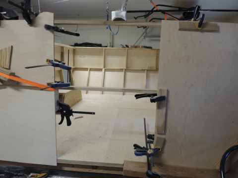

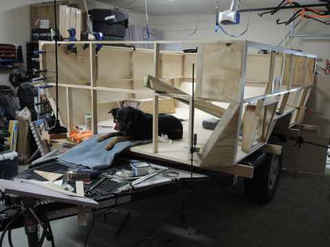

Moving onto the right rear skin...
More Creative Bracing...
Bending and Securing the top of the skin
Piper is inspecting the work!
Postby FLFLYIN » Thu Jan 03, 2019 7:58 pm

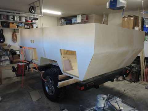

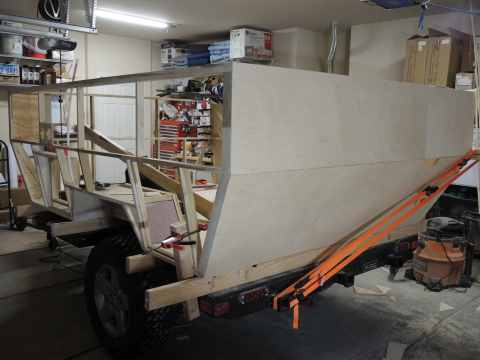

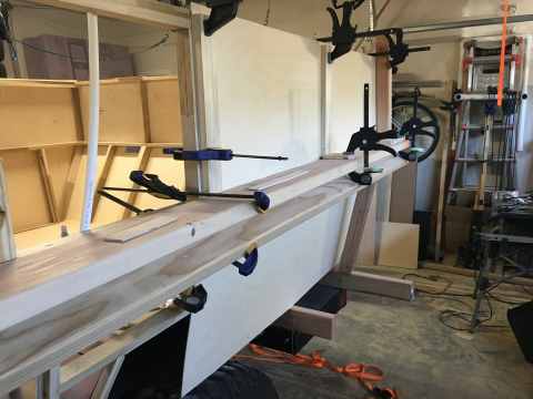

The lower body is fully skinned! Now it's starting to look like I imagined.
Top right of the front wall is finally glued and clamped.
The Water heater access, city, and gravity water port cutouts along with the rear cargo door cutouts on the Drivers side.

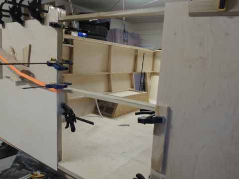

Here's a view from where the door will be located. Obviously the cross braces will be cut out before installing the door. I think it's time for a tall cold one!

Passenger side, showing the cargo compartment cutout in the rear
Drivers side, showing the cutouts for the water inputs, the water heater compartment, and the other Cargo Compartment cutout.
