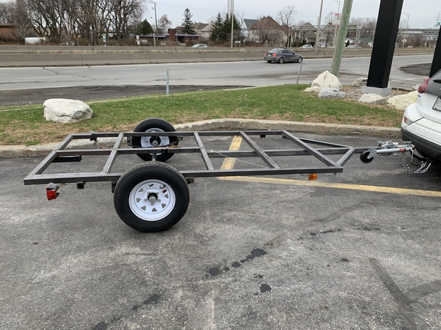

- In December I finally found someone to build the 5x9 chassis. He had it ready in 2 wks.

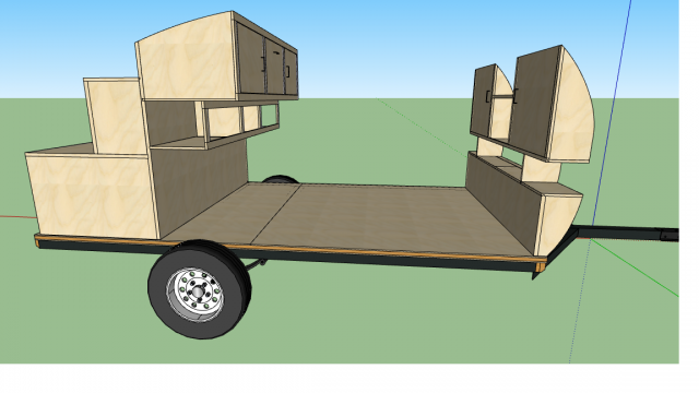

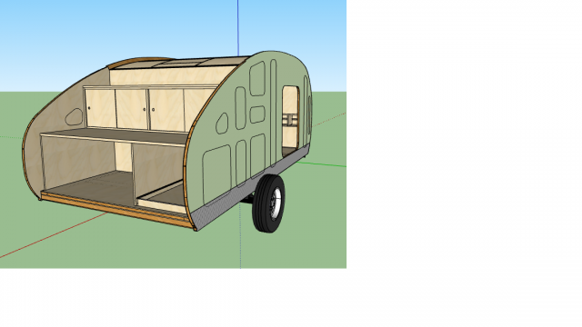

- I'm using Sketchup to come up with the design and its based on the plans from Ryan's http://teardropbuilder.com/. Mine is longer and a little taller.
- I dont have a garage. This is my biggest pain point and will continue to be while I build. So I'm borrowing garages and working outdoors. BTW, I live in Montreal, Canada. We get snow.
A few screenshot from Sketchup:
I havent finished the roof outside skin. Having trouble figuring out how to do it. Also I need to add the hatch.
I had a friend help me bring the trailer home. UHaul didnt have my trailer hitch in time.

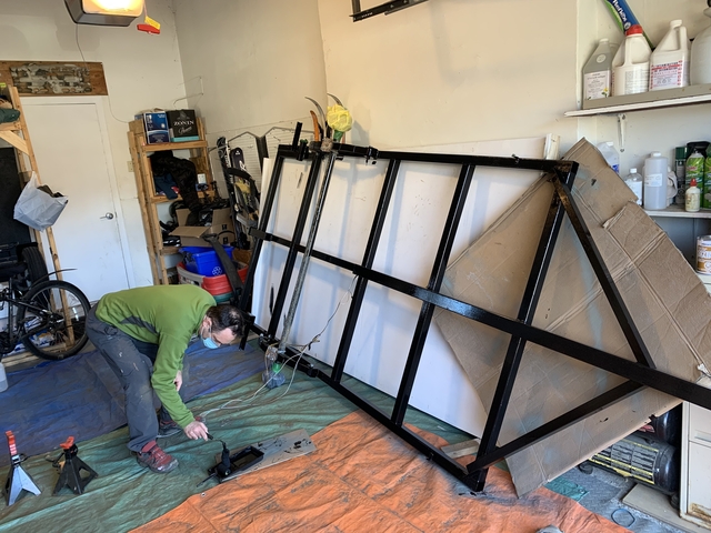

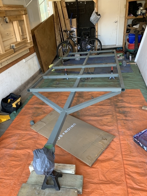

Used self etching primer first. My friend JF, lent me his garage for a few days.
Two coats of enamel paint.

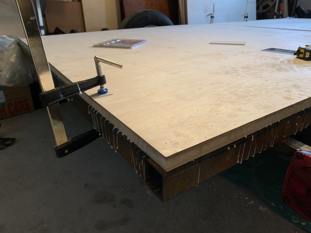

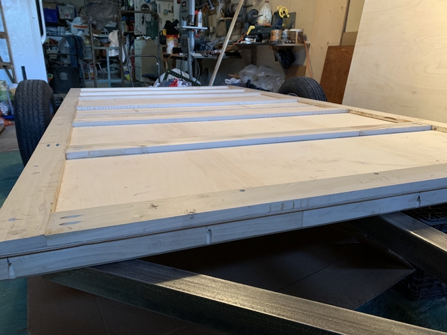

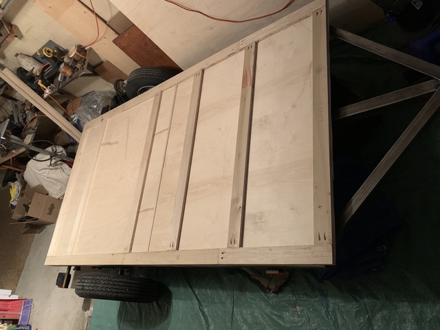

I started building the deck in my Moms garage.
I let the glue dry too much and had to spend some time scrapping it off the chassis.

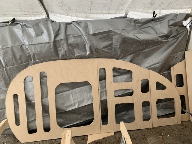

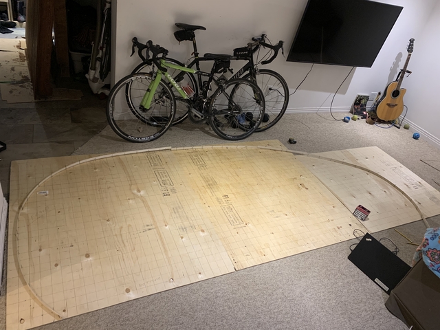

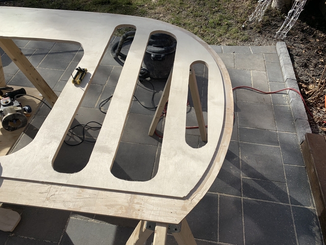

At home in the basement I started to work on the template. Used the method many members of this forum described. When I was happy with the curve, I trace it out and cut the template. Used 3/8 plywood.

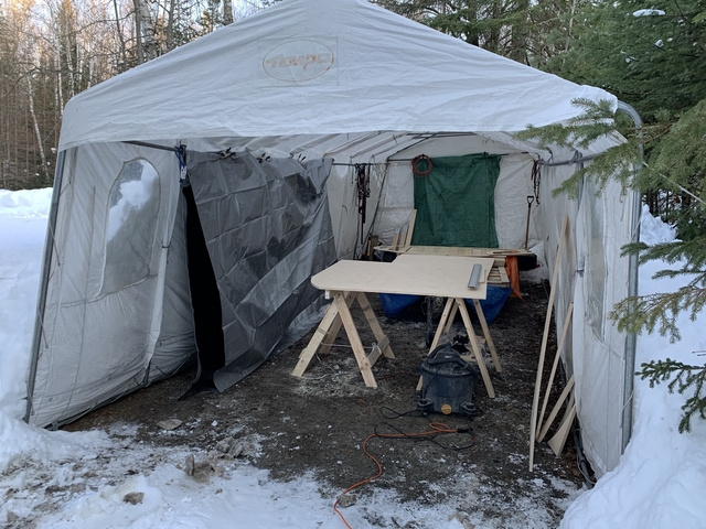

This March, my daughter had her spring break and we rented a country place up north for a week. I ended up using the "Tempo", the tent as the workshop. It was cold out but not too bad when sheltered from the wind.
Got most of the wall frames built using 5 x 5 x 3/4 Russian Birch. I looked at 4x8 ACX at Home depot but they all look warped. I was afraid of having walls that warp and then trying to straighten them. The Russian birch is probably a bit heavier. I weighed each wall frame at about 52lbs. The wall frame is made using 3 section of 5x5 birch. I used a 2" lap joint to connect them. Final length is 10' 2".
I rough cut a door opening to lighten the wall. I still need to figure out what door I will order and then I will make the proper cutout.

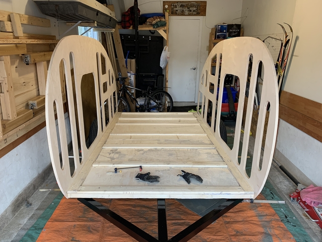

Here's a pic of the walls temporarily clamped to the trailer chassis. Starting to look like a teardrop?
Next I need to work on skinning the inside of the walls and start on the cabinets.
It is. A lot.
Are you building or buying your doors? (Why so short?)
