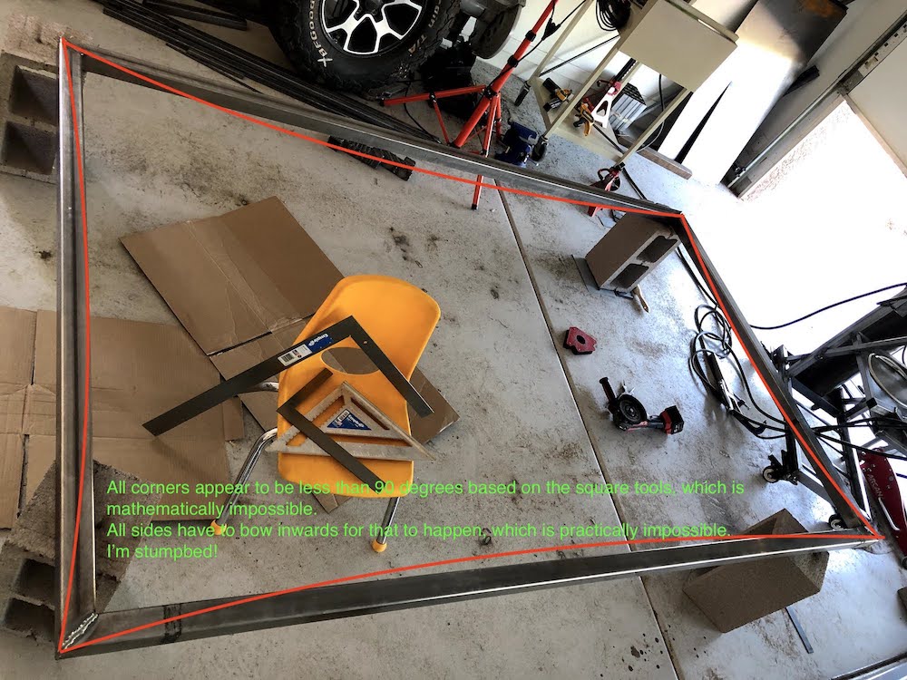

Barely one day into the build, I already came to a halt. The frame doesn't appear to be a true square :( This is my first time welding for real.
I have a big decision to make: should I cut it up and redo it? That's what I lean towards. I'd like to hear advice.

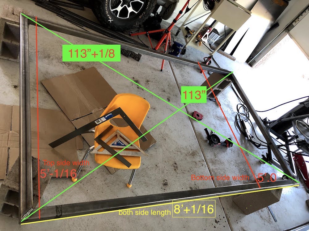

It's a big decision, let me list all the details here. Assuming my measuring tools are "accurate" and I have taken the correct measurements, here is what I got:
Distance measurements - width: top side 5'-1/16, bottom side 5', length is 8'+1/16 for either side. Diagonals are 1/8 off. Details are below:
Width:
top of the frame is 5' - 1/16
bottom of the frame is 5'
Length:
both left and right are 8' + 1/16 (same)
Diagonal:
One is 113", the other is 113" + 1/8. That's 1/8 off.
Square angle measurements - the square tools indicate all corners are less than 90 deg, which is impossible. I tried 3 different square tools, they all indicate the same :( All sides have to be bowed inward for that to happen, that's practically impossible (I have attached an exaggerated illustration). I have manually "verified" the square tools, they all seem to be correct (drawing two overlapping vertical lines while flipping the square tool horizontally).
I'm stumped. I'm leaning towards cutting it up. Any advice is appreciated!

Well... 1/8" on the diagonals is fine for the frame.
What's most important is getting the axle squared with the tongue.
I use three plumb bobs for this. Clamp one side of the axle in place and adjust the other side. Don't try to fight both ends.

You know 1 eighth inch/3mm across the diagonals is actually only 1 sixteenth inch / 1.5mm out of square, right? i.e. you'd only have to pull the long diagonal 1/16 of an inch to get the two sides to match.
As square as you'll ever get.
As for the potentially bowed in sides, don't stress.
Run a string line and see if the long sides are straight.
If the long sides bow in a bit, cut your cross members long enough to spread the sides back to straight. They'd have to be a very long way out to be unable to flex the long sides straight.

Weld shrinks when it cools. This usually winds up pulling both pieces towards the welded side. If you welded the inside of the corners first then, yes, it would bow all the bars inwards. I'd bet the longer measured length was one of the corners you started on.
https://www.youtube.com/watch?v=2vuGlcbDwKY
I would not sweat 1/8" on the diagonals. That is very close. That method of measurement exaggerates how out of square it actually is IMO.

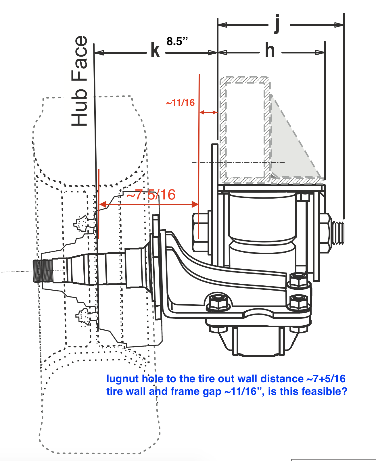

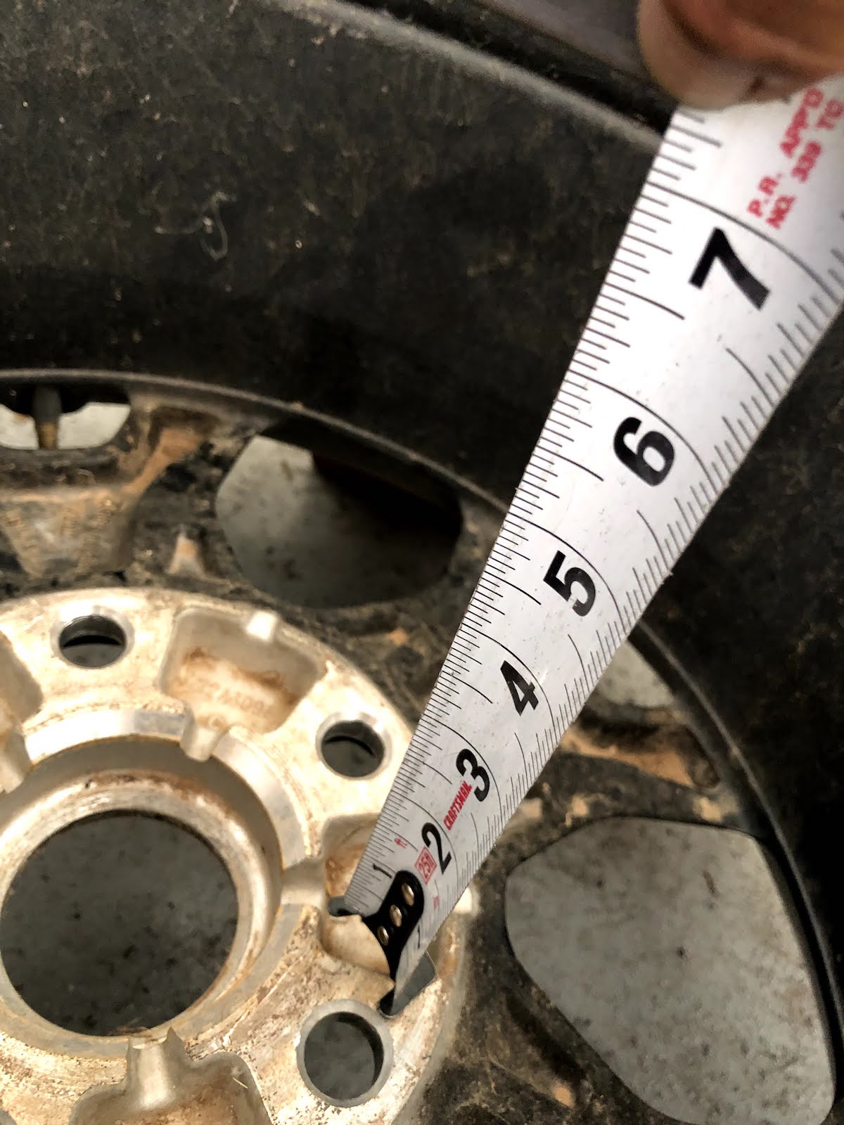

I plan to use my Rubicon JL factory 33" tires for the trailer. That was actually part of the motivation I started this project after I lifted my Jeep to 37" tires. I ordered the Timbren axle-less suspension with hubs/brakes. According to the Timbren document, the distance between the trailer and the lug nut thread hole (indicated as "K" in the diagram) is 8.5". I just measured my wheel, from the lug nut thread hole to the tire outside wall, it's 7+5/16". Theoretically, the gap between the tire and trailer frame is ~11/16". The fender wall also need to fit into this space. Is this feasible?
I'm worried the gap is too narrow.

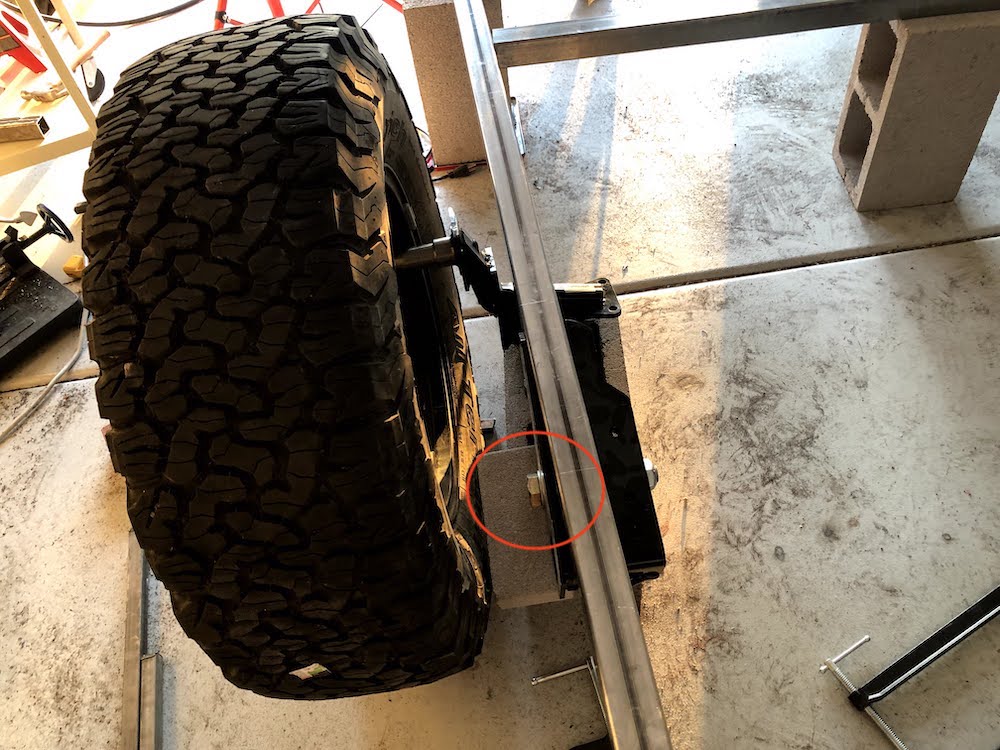

Postby DesertApprentice » Thu Aug 05, 2021 9:32 pm
gee, it's getting worse. I tried to do a mockup dry fit, I noticed a bolt sticks out 3/4" from the frame with the Timbren assembly, the spindle is 14" away, so this bolt lines up exactly against the tire wall.
I'm not sure if I can even fit the tire in, let alone any gap between the tire and the frame. Any possible workaround other than going to smaller tire? I swear I saw in youtube, some teardrop was using Timbren axle with 33". Not sure how they did it. Maybe my tire is just too fat, i have 285/70/R17.
I did some quick reading on wheel spacers, not sure I want to go that route.
