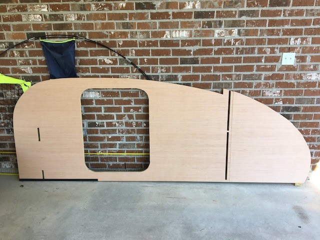

I’m Mike in Baton Rouge, building my first teardrop. I am mostly following Tony Latham’s book, but it’s going to be part woody. I built a wood strip kayak a few years ago and plan to translate those techniques. If you’re familiar with the cover of Matt Berger’s book, you’ll see kinda what I have in mind…the exterior sidewalls will be aluminum sheathing on the bottom, and fiberglassed wood strips on the top half. I plan the whole hatch to be a wood strip design. Still don’t know about the roof exterior….but I know I can avoid a lot of upkeep if I don’t go with wood up top.
I started out by building the Paulk workbench on rolling casters....it is so nice to have a big workbench that I can rollout outside or break down as needed, as I have a shop with a one-car rollup door. Space is always a consideration.
I have already built the sidewalls, finished the interior side, and am now stripping. I couldn’t find any 1/8” Baltic birch anywhere around here, so the interior walls are poplar ply. I found a shop in Houston that gets the 1/8” in, and hope to find 10 sheets or so to do the headliner and roof and make the 4-hr trip over next month. I plan to build the cabin first and then the chassis later (though I’m not a welder).
Here are a few pics
Looking forward to being a part of this forum. There is an incredible amount of info here...the key is being able to figure out how to access it efficiently....! I have studied the build journals of Tony, JoeGrz, and GarthB...impressive!

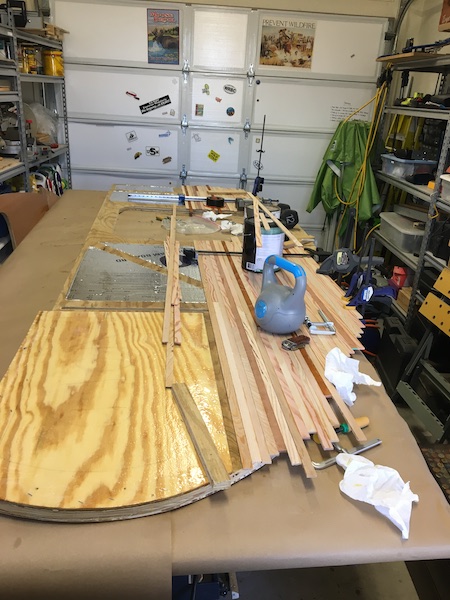

Today I finished stripping one exterior wall. I temporarily reinstalled the roof shelf to cut the strips flush. Over the next few days I’ll fair and sand, then I’ll fiberglasss once the temperature cooperates. I can only run one 1500W heater on my circuit, and can generally raise temp by 10F. We should be in the 60s here next week, so I think It’ll hold up long enough to be ok. I can run an extension cord from the house for a second heater during the day, I’ll do the nerve-wracking hatch cut after. Does anybody know if I should do it while the epoxy is still green? I guess it only saves a blade…
Also got my doors yesterday from Challenger, which I ordered Dec 1. They fit my opening great, but some of the styrofoam packaging bags popped open, and it was a mess everywhere. Every crevice on the doors had the small circus peanuts, and I spent an hour fishing them out with a pencil. More worrisome is the way some of the peanuts stuck/melted (?) to the door interior…like they de-polymerized or something…and left a mottled surface. Still trying to figure what cleaner/solvent will work without ruining the surface. I have to say I’m a little disappointed with some of the fit and finish…poorly cut seams with exposed aluminum underneath the black exterior. I’ll figure out something.
Overall, a good couple of days. Maybe in a week or two we’ll have another weather window for the second wall. It’ll take some time to strip the second wall, and perhaps I can start on the floor….but shuffling all these big pieces around is a little bit of a challenge with the edge strips not fiberglassed…they are only 3/16” thick.

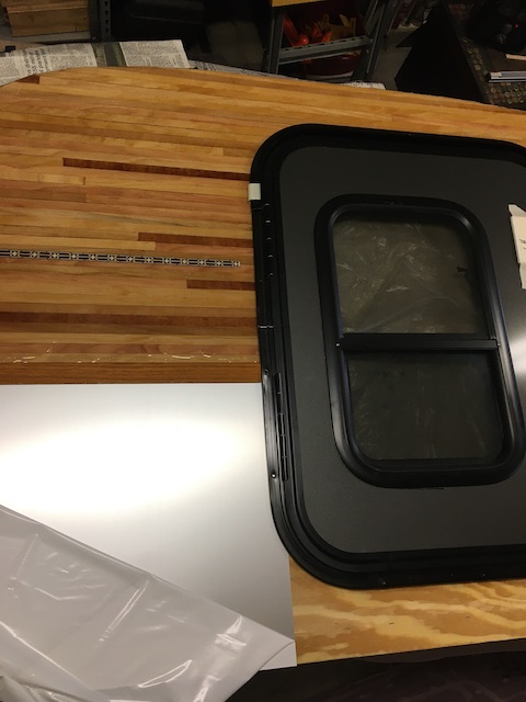

I've fiberglassed one wall but still have sanding and varnishing to do...yet I couldn't help but get a preview of what it's going to look like. I just dropped the door in, and slid the aluminum in while peeling back a corner of the protective plastic...nothing is attached except the strips. I also just laid down the oak transition board. The aluminum is shinier that I'd like. I know Matt Berger did a light sanding on his, but this is anodized 0.040". We'll see what it looks like when I finally one day get to roll it out of the shop.

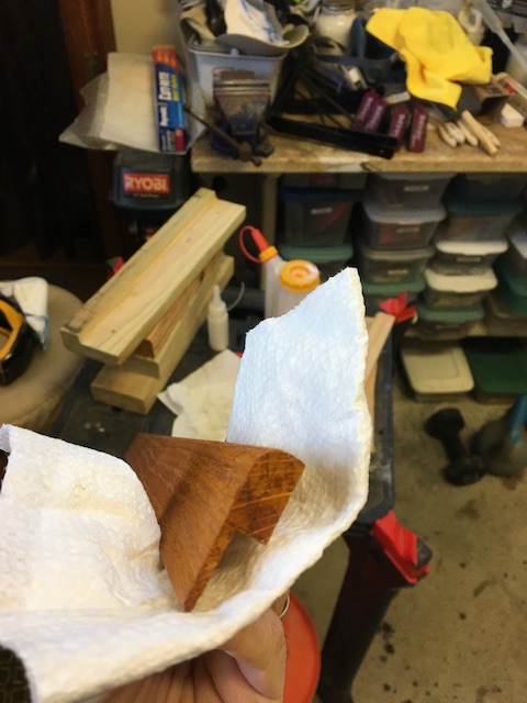

I routed the "transition board" so that it would overlap the aluminum and snug up against the wood strips. I will PL Premium it to the aluminum, Titebond III it to the skeleton, and then put a thin line of epoxy at the top edge...I feel pretty confident about not getting a leak here. Here is what the profile of the transition board looks like:

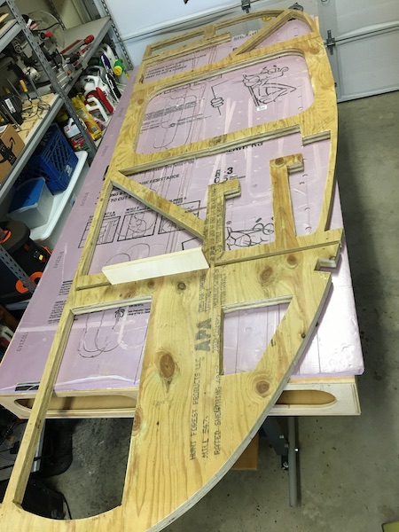

One other note...I did use 3/4" foam board insulation, but it was those little beads instead of compressed foam (PolyPro by Perma"R"Products....no blue board or pink board was available in 3/4"). Cutting made a mess, but also, I put the foil side out...which I then had to cover with tape in case there were any gaps with the seams (which there were...I thought laying these strips on a flat bed would be easier than a curved kayak...but nothing that a little thickened epoxy can't cure!)
