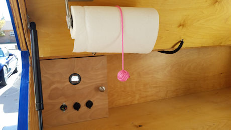

I got to try Western Traveler's idea for keeping the paper towels from unrolling. I used a wooden ball and some lead fishing weights and tied a monkey fist with some cord I had laying around.
20211114_142746 Small.jpg (44.79 KiB) Viewed 1084 times

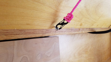

So that I can remove the ball if it starts to bounce around, I used one of the Nite-Ize S-clips hooked on an eye
20211114_142800 Small.jpg (41.29 KiB) Viewed 1084 times
Thanks for the idea Ralph. It worked well even in the gusts

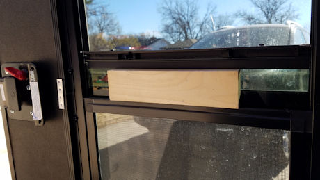

The third refinement to the camping experience was a window prop. One of the posts I read in the past had someone looking for a way to prop their window open on the manufactured doors to vent the condensation. I had condensation on my windows in September and it never occurred to me to open the windows, only the roof vent. Now I know. The problem is the window latches only in the open or closed position. Nothing in the middle. My solution was to put a small cut off from my spars under the ledge I lift to open the window. Here's what it looked like.
20211211_132727 Small.jpg (47.89 KiB) Viewed 1084 times
I was going to post this as a follow on to his post/question but I can't remember who asked when or where. I hope whoever asked the question stumbles on this post. Anyhow, I don't know if it prevented the condensation or not. It held the window open just fine but I don't know if the condensation was vented or the windows didn't get cold enough to condense moisture.

Nice monkey fist Joe!
You can probably shorten the main line a 1/3 if it bothers you how it hangs. Glad it worked for you.
As to the window prop for the opening I figured it out while on my trip one night when I needed less than completely open. Still wondering what took me so long to figure it out. I’ve been using a dental floss case since. Just the right amount of opening and stays put. It was the first thing I found to use in the middle of the night :laughter:

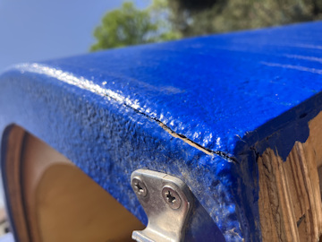

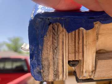

We had a great trip and the trailer held up well in the rain and water crossings. Or so I thought. After I got home and cleaned the mud off the trailer, I found the top finish of the hatch separating at the side wall. Here is a picture of the split of the Monstaliner.
IMG_0020 small.jpg (64.63 KiB) Viewed 960 times
This split has continued up a little distance and I have another further up the hatch. I think this is water that got in to the wood. Looking at it, I think the water entered at the bottom of the hatch ends
IMG_0019 small.jpg (61.7 KiB) Viewed 960 times
As I said, there was more separation of the Monstaliner as time went on. I think my problem is two fold. First, the obvious, I needed to do a better job sealing the bottom of the hatch. If I had done a better job of sealing, number two may not have mattered. My second thought as to what went wrong is that the glue did not go to edge and squeeze out. After time, it looks like the sheets started separating. The glue would have prevented the layers from separating and only some swelling would have occured.
What did I do about this? I looked for what was readily available and decided that JB Weld Clearweld would suit my needs. It also came with a nozzle that mixed the epoxy as I squeezed it out. I built up a layer of epoxy on the bottom of the hatch. Hopefully, the epoxy went into the crevices and will hold the bottom together as well as keep water out. The cracks in the finish presented another problem. I wanted to repair the finish and paint it. I found that regular JB Weld is sandable and paintable. I put a bit of the JB Weld in each finish crack. It appears that it held up well. The next step is to sand and paint the repair. If my memory is correct, Monstaliner has paint for trim. I am hoping to get some to match the my Smurfadelic exterior.

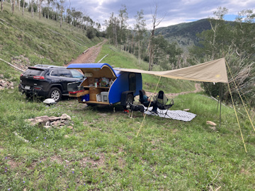

Last month I took a quick trip to the Cuchara, CO area. This was the disaster that always sits around the corner. To start our conversation, here is the good.
Rather then spend the twenty some odd dollars a night to stay in the campground, we opted to go up the mountain a bit. The road was very rough so I pulled off at one of the switchbacks. The site was pleasant and the sound of the stream below was relaxing. I put up the tarp since it was supposed to rain. It is a Slumberjack Roadhouse tarp that was designed to hook to the wheels and provide coverage out the back of a SUV. Since I rarely sit behind teardrop but off to the side, I cut a piece of EMT into three sections and when I got to site, put the sections together with couplings, attached the vehicle side of the tarp to the conduit and tied it off to the wheel and the frame at the front of the tear. It worked well, but I think it would have worked better if I had a roof rack to attach it to. That's the good.

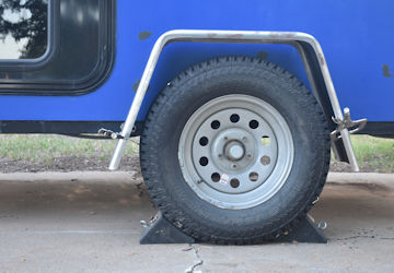

This weekend I started the fender replacement. I welded the brackets, Bolted them on using the existing holes, and notched the fender. I could not remember exactly what I had done as far as attachments. Fortunately, I recorded the fastener sizes and how I put it all together in the write up the first time around
Fender small.jpg (42.37 KiB) Viewed 760 times
Here is the repair in its current state. The next step is to drill the fender in three places on each side to bolt the fender to the bracket. To do that, I will need to pull the wheel off so that I can gain access. Unfortunately, I ran out of day today.
Changes that are incorporated or are going to be incorporated are the lengthening of the bracket. Originally, the bracket was 9-1/2 inches. The brackets have been increased to 10-1/2 inches to get a better spread on the screws. The other difference will be that I am going to screw the bracket end down instead of welding it down as I did originally. Too much wood, too close to where I would be welding.
The other thing I am thinking through is KC's comment concerning vibration. His recommendation is to add bracing to the bracket. Unfortunately, my skills are not sufficient to allow me to fabricate the attachments necessary for something like that. I am working through the possibility of attaching the top of the fender to the cabin. What I have in mind is to drill a hole in the fender, then, drill a hole through the cabin wall :frightened:. Inside the cabin, thread a carriage bolt through the wall, through a washer, then through a pipe spacer/sleeve, through another washer, through the fender, a third washer and secure it all with a nut. I figure the spacer will allow me to tighten everything down without too much deformation as well as keep everything lined up. this will need to happen in two or four places. I'm hoping that the additional restraint will reduce the vibration as well as stress on the brackets. This restraint should be fairly easy to install on the opposite side to keep that one from failing as well. Also, there is Smufadelic paint on the way to cover the dark spots on the side of the cabin from the finish repairs
I have three nights and six full days to get this finished, painted and ready to go. I plan on heading out for a long weekend next Thursday. Nothing like a deadline to motivate me!
On a side note, the teardrop is a year old :P last week. It has truly been a fun toy and I can't think of anything that I would change. Well, maybe a fender attachment.

Postby KCStudly » Fri Sep 09, 2022 12:24 pm
That sounds like a good plan from where I sit. Even just one of the extra bolts with pipe spacer at the top center would be way better than none. If possible, size the pipe spacer length to include a washer between it and your finished wall, and another at the point where the pipe would contact the inner edge of the fender (weld the washers on either end of the pipe if possible). This will help keep the pipe from turning into a cookie cutter. Keep it from wallowing into the wall and loosening the carriage bolt.
