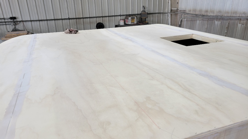

Looking good! I see you are using the rear lights that came with the trailer chassis. How did you attach them to the back?
Posts: 8872
Re: Wonder 10 build
Postby cdlwingnut » Thu May 18, 2023 7:57 pm
Seams are filled with body putty, Lots of sanding, I also took a flap sander and another sander to round the corners off just a little that little bit makes the lines look better. Should be ready for fiber glass.
I still need to stain and varnish the inside but that can wait until camping season is over. I also plan to insulate it a little and use upholstery for the inside walls but again a project for the off season.
As for the tail lights I used some longer bolts to attach them to the wood at the bottom.
