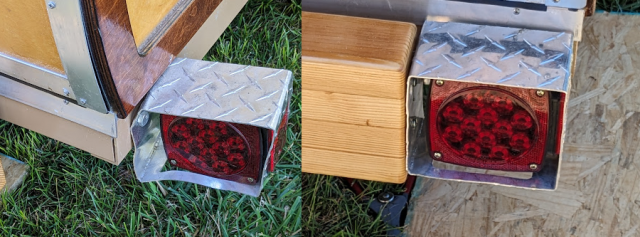

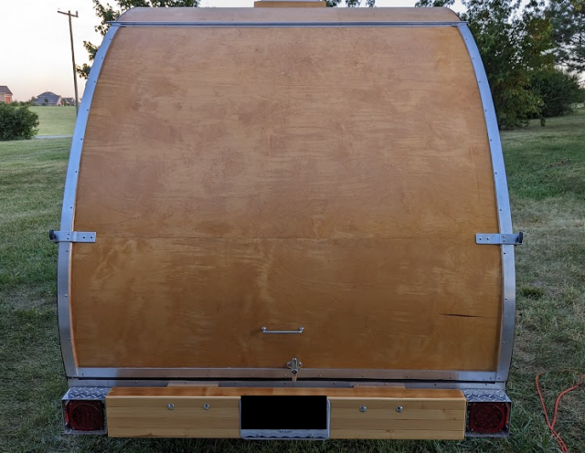

1. The tail lights were relocated to the rear of the trailer and I made a bumper to give it a finished look as well as a better place to mount the license plate. The camper hasn't gone anywhere yet and I've managed to bend the plate because it was too low hanging below the stock light location and I keep hitting the tail lights on the garage when I put it away. It would be better not to have a bumper at all, but it doesn't seem to get in the way much and solves more irritating issues.

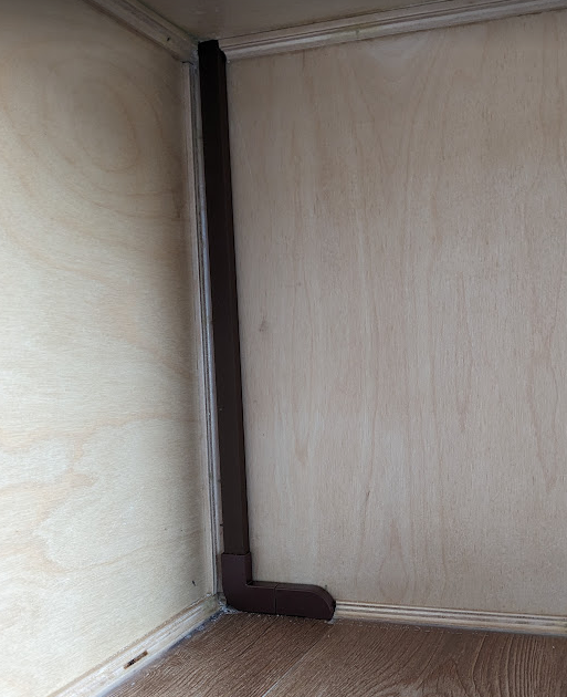

3. Hacked the wiring runs into the galley. Since the Camper wasn't really designed for wiring, I had to surface mount the wiring runs. I thought about trying to get fancy and craft some wood runs but in the end I just selected some plastic runs from Amazon that I think look OK, and plastic is probably a better choice to enclose the wire. The adhesive worked well on the finished birch, and I'll add some silicone around the ends to make sure it stays put.

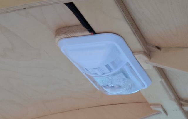

4. I picked up a dome light and installed it while I was running the wiring up to the fan vent wiring run.

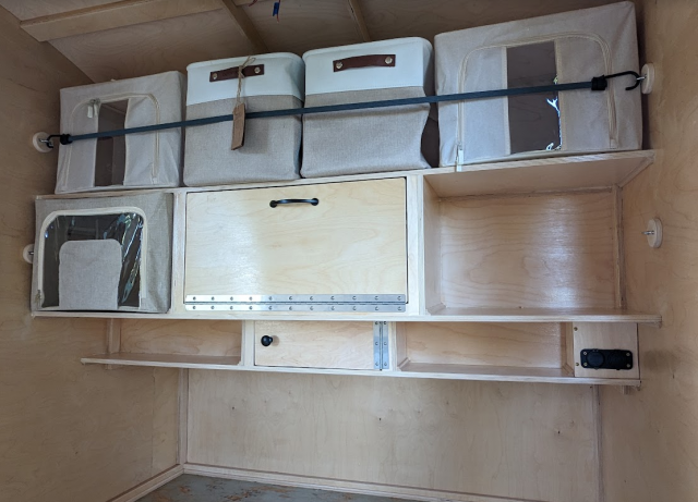

Well, I'm getting close to the end of the build. The last two weeks we had some rain here in Liberty, MO, so I didn't get as much done as I would have liked. My main goal for the last two weeks was to finish the interior shelving and put two coats of acrylic urethane on. I kept the cabinets pretty basic and after much internet searching decided I liked the fold out desk cabinet and open shelves for closet storage organizers. I did use the stainless piano hinge that came with the kit for the cabinet doors. It looks a little industrial but I think they'll be stronger since it doubles as a desk. Next week I plan to finish the electric wiring and flooring and get it ready for short trip in October!

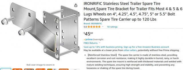

I had a little time before the rain one day and got the spare tire mount installed. I overcame my cheapness and went with a nice stainless mount even though is was 3 times as much (ouch - I still picked the cheapest one I could find).

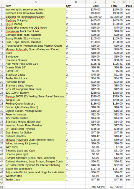

The total cost for what I consider the complete build (up to this point) is approximately $7740. There are still some things I want to do, but they are extras for next year. I did not include the cost of new tools (since I will use them on other projects) or supplies that I already had on hand (sand paper, chip brushes, glue, finish, hardware etc..), but only new items that I purchased specifically for the build. I definitely could have spent less, but in some cases I was just particular in what I wanted, and in others it was buy versus build and the juice wasn't worth the squeeze to build. There are probably some things I missed adding to the list along the way so a ballpark figure would be $8000, which is about $1500 more than I guesstimated at the start.

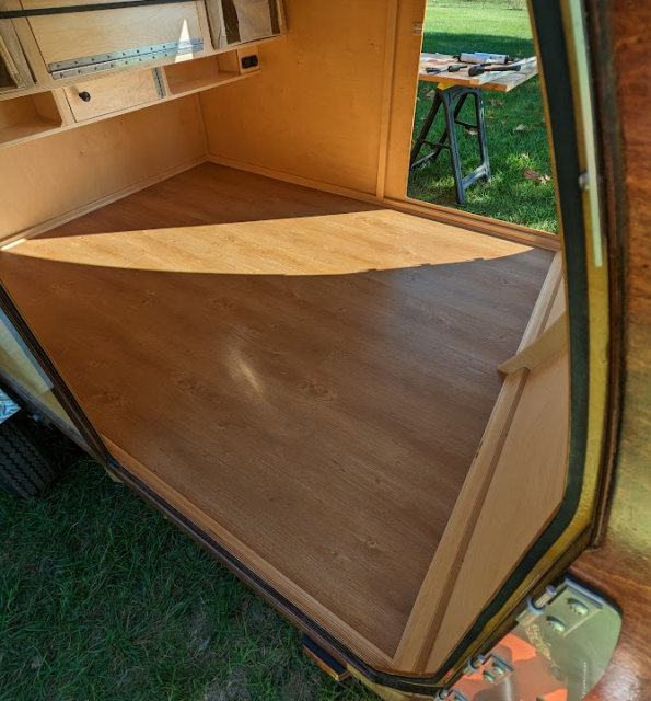

This weekend was finishing touches. The 12V electrical systems is done and everything checked out on the first try. The last few things I had to do was get the floor finished and put silicone around the bottom of the Teardrop where it slightly overhangs the trailer. It's as complete as I can get it for now, and I gave it a short shakedown run to make sure everything is in working order. I'll be taking it on a trip to Pulltite Ozark National Scenic Riverway (https://www.recreation.gov/camping/campgrounds/234357) for a float trip this week. It'll be a short trip just work the bugs out and it should be some nice Fall weather along the Current river. I'm looking forward to it, since I haven't been canoeing for quite a while.

The Birch camper survived it's maiden voyage. It rained for two out of the 3 days we were traveling and the porthole windows did better than I thought they would, but one of the door seals needs some work. This is the first time I've done a float trip this late in the year and it was a nice experience. We had the river to ourselves (normally in mid-summer it's bank to bank with canoes), and the early morning mist made it look pretty cool. It kept raining and sprinkling the 1st and 2nd day all the way until we finished the float trip and turned in the canoes (about 2pm), and then the sun came out.
Lessons learned
1. Make a list. It's been a few years since I've been on a float trip and I was in a hurry and forgot about as much as I remembered to bring. Coffee was the one thing I forgot that really made me sad. Fortunately a buddy brought some.
2. Don't use self adhesive vinyl flooring planks. They look OK and I figured it would be a tough easy to clean floor, but they don't stick and stay down well at all. Those will be replaced next year.
3. This is a fairly light camper and I used an Aluminum trailer, but my little Jeep Renegade struggled some when it was rainy and windy. Other than that it did OK but I think I'll be upgrading the vehicle.

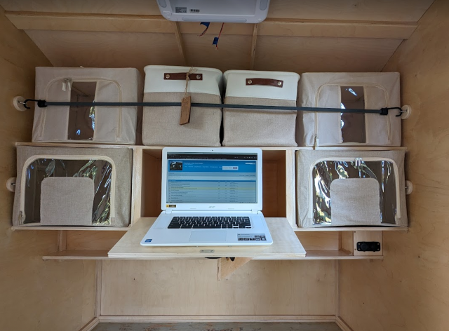

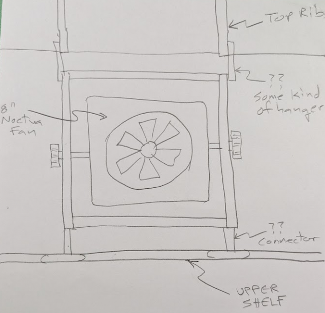

Thanks Karl, I will definitely post some changes next spring. Two issues that I forgot to mention from the trip are:
1. The upper shelving storage organizers don't stay put. Everything launched off the shelf over the bungee pretty quick. The lower storage organizers didn't have a problem because they fit tighter on the shelf.
2. I want a 12v fan to move some air around the camper. The vent works OK, and is quiet but doesn't seem to move much air. I bought an automotive clip on fan from Amazon that turned out to be a piece of junk, so it was sent back.
I could move the bungee up, but what I'm thinking now is to kill two birds with one stone and make a removable fan frame. I want to make the frame so that it that can be clipped on, or slide into some brackets so that it can easily be moved out of the way. I think this should help the bungee keep the organizers in place during travel. The fan will be a high quality 8" computer fan with a speed controller to move the air. The wood frame should help hold the the center storage organizers in place and shorten the length of bungee so it can't stretch as much. I have a basic idea but will spend the Winter mulling around how to design the frame and get it to clip in front of the organizers.
Here's a quick sketch
I plan to use an 200mm Noctua fan. These are known for good quality and the Noctua colors will match the wood camper (not a fan of glow in the dark bright colors).
