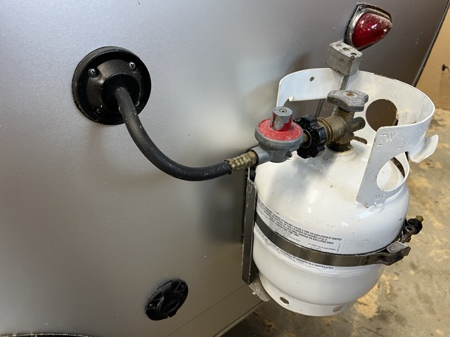

I am building a slide out for my Cook Partner stove just like you did - what kind of connector did you use of the pass through on the shell out to the tank - any info/pics you can share is appreciated! Also hoses and connectors as well, thanks!!

abarkume wrote: what kind of connector did you use of the pass through on the shell out to the tank - any info/pics you can share is appreciated! Also hoses and connectors as well,
Abarkume, I did not use any "special" fittings to hook up the stove. I used the 5 foot (I think that's the length) propane line that came with the stove. It was just long enough. I've attached a pict of a fixture I made up to attach to the outside of the trailer's side from the propane tank where the line passes through outside wall of the trailer (black fixture). Tony's trailer has a similar stove sliding feature. You might also get some inspiration from looking at his set up. When ordering your stove just make sure your propane inlet to the stove is on the side that will work for your setup.

Postby tony.latham » Tue Aug 06, 2024 11:07 am
My propane tank is on the tongue, and the rubber lines run under the frame. (The Partner has a high-pressure regulator, and my Propex has a standard one, thus two lines.)
The hose that came with the Partner stove goes through the floor and allows for the slider. This video shows a glimpse of the hose at about 3:25. The holes are sealed with PL adhesive.
