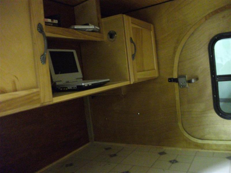

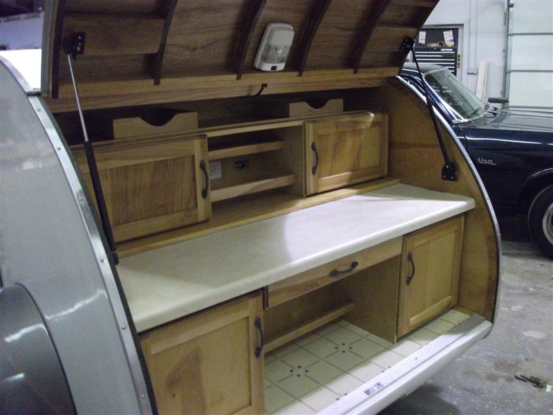

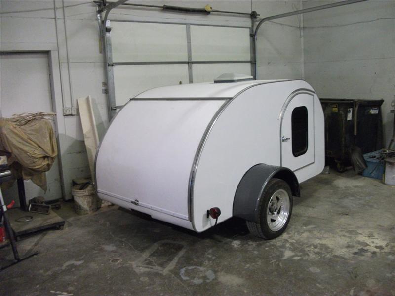

Finally got a new camera. Thought I had better post some pictures although I am almost finished building.
This is my fourth attempt at building a teardrop. I don't think I will ever be completly happy with what I have built. With each one I expect to do better but always run into a different set of problems.
.While this is the same profile and basic cabinet layout as my previous builds, it is lighter, has two doors and is sealed much better before skinning.
For the most part I am satisfied with this one but will find it hard to part with my "Boar's Nest" I know one of them will have to go

Postby CAJUN LADY » Wed Jan 13, 2010 8:57 am
Very nice work Randy. I really like your galley! :thumbsup:

Postby kludge » Wed Jan 13, 2010 10:03 am
What is the skin?
kludge
Posts: 177
Joined: Fri Dec 11, 2009 9:41 am
Location: Indy
Postby Bodyman » Wed Jan 13, 2010 11:03 am
Sides are smooth FRP. Painted white with automotive clear coat. Ordered from small local lumber yard.
Roof is TPO commercial roofing from local roofing contractor
