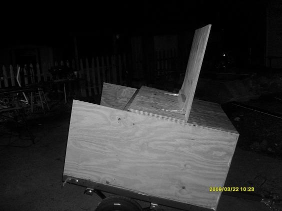

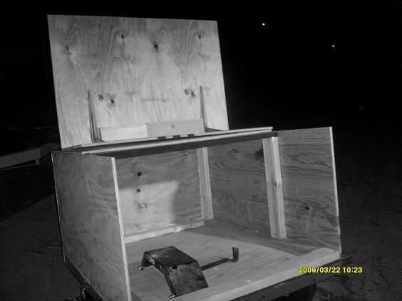

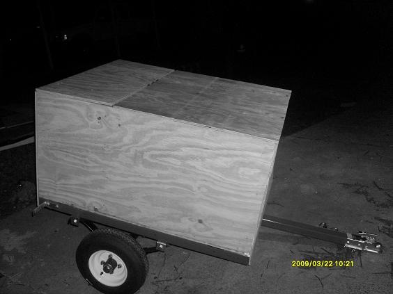

Ivar the Red wrote:I got a little more done today...
This will be the hatch, it's not attached yet...but it will open all the way like that...
And here are both of my trailers all tucked in for bed...and waiting for "The Man" to loosen up his wallet...
Do ya like how I got all "artsy" and shot them in b&w? :lol:
This will not be the final version of this tear...this is the hurry and get something together before the Palo-Duro Gathering version. In the future I'm gonna take Bob's advise and lengthen the tongue. That'll give me a little more room to add more to the front. My goal is to make both trailers have the same shape, kind of.

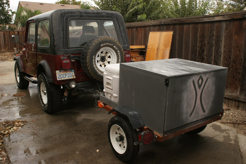

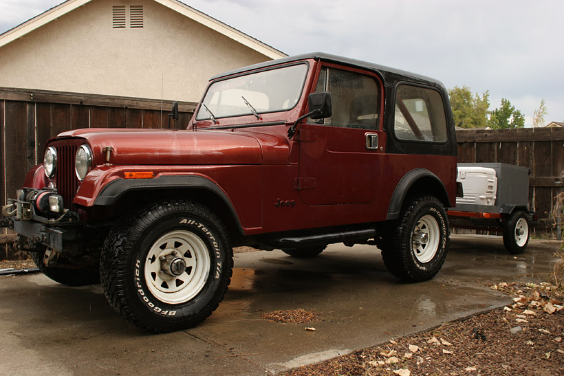

davkrat wrote:Looks like my trailer:
I deffinately second the problem backing up, it is a total pain. I have been towing and backing boat and ATV trailers for work for the last 12 years and I can't get this thing to go straight for more than 10'. I also picked up larger 12" tires and wheels from HF, those dinky 8" scared me.
And my "Barbie" tow rig:
I built the trailer to help carry camping gear, having two kids the space in the car starts to get limited. I actually finished it up just in time to go to Burning Man, hence the mural ;) I actually saw a few teardrops there. If anyone doesn't know what Burning Man is about:
Image[/list]

Ivar the Red wrote:
davkrat wrote:I built the trailer to help carry camping gear, having two kids the space in the car starts to get limited.
That's what the little one will be for exactly. Short camping trips to spots around close where the teardrop will be too much.(did I just say that?)
:lol:
I haven't towed it anywhere yet...but yes the 8" wheels are on the hit list, if only to get a little more height. I also want to take the advise of a longer towbar. Eventually I want to make it look similar to the bigger trailer.
Very cool picture.

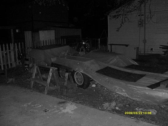

I think I have screwed up. I went the "cheap" route and put a plastic sheet over my unfinished wood. Over the course of time, I guess the plastic has gone bad, and during this last few days of wind and rain, the wood has been thoroughly soaked...
I'm wondering if I can just give it a good sanding and recover it (with something better) and everything will be ok?
