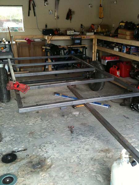

I officially started building today. It was a pretty lazy day for me but I still managed to make a trip to the dump with the utility trailer and then on the way home I stopped to pick up the steel for the frame.
Im using 2x2x.125" for the basic frame, 2x2x.250 for the tongue and using 2x2x.250" angle for a couple cross-members within the frame.
I dont really have much of a plan yet, just kinda winging it. The outside dimensions of the frame are 114"x64". The width was chosen by the axle I happened to find cheap. This build is most DEFINITELY a budget build. I'll spend where I have to or where I think it's important, but anything I can do for free or cheap is great.
Squaring up the frame took a little bit of effort but wasnt too bad. It's within a 1/16th or so. I still have some welding on the inside corners to do, but it's sturdy as it is.
I've picked up a Dometic RM2201 (free) that works pretty good but it has issues with staying lit with gas. Im sure a good cleaning will fix it. Also grabbed a wedgewood 3 burner stove (free) that should work pretty well in the galley. So far the fridge and 120-12v converter(free) have been tested. I have a hydro-flame furnace (free) that I picked up also but havent been able to test it thus far.
Im hoping to have a SAWTOOTH type design, but obviously larger.
Here's a few pictures of the progress so far. I need to buy some spring perches to get the axle ready to mount up and get the cross-members in and she'll be ready for some tongue work.
Anyone have any tips?

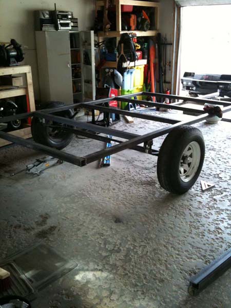

I worked on it for an hour or so after my 12hr shift at work today. Got the cross-members welded in. Spacing is approx 27-28". Front two cross members are the 2x2x.125 while the rear cross member is the 1/4 angle.
Also welded on the tongue, but was rushing and didnt double check my measurements after tacking it in place. It's off a bit so I'll have to do some grinding tomorrow and make it right. Live and learn! Atleast it's a mistake that's easily fixed. Wont do that again.
Now that I've got the cross members in place I really need to go buy the stabilizers so I know how to weld up the mounts. I've also got a few ideas for using 2" long pieces of 2x2x1/4 angle to brace the the tongue for additional strength. I dont like relying on just a few welds for the tongue and I want to avoid an A-Frame tongue if at all possible (except maybe a SMALL A for bracing.
Got 3 days off work now so I should have some decent progress as long as I dont need to purchase any big items. I'd like to atleast get it rolling and towable.

I've now got a rolling frame. I've gotta tighten up the suspension bolts and run a couple more welds, but it's insanely sturdy. Unfortunately it also weighs a bloody ton, haha.
Gonna do some bracket and gusset work tomorrow.

Frame is completely welded (minus frame plugs, tongue jack and stabilizers). Mounting holes are drilled in the brackets for the mounting of the floor.
Tomorrow I'll do some budgeting and likely start making sawdust.
I modified the tongue from what those pictures show. I made it a composite tongue with a short A-frame and a hitch receiver to make the tongue removable.
I plan on having a couple different tongues with differing lengths to adjust the distance from the tow vehicle. This will allow me to use a dual receiver hitch on the tow vehicle and strap the dirtbike down overtop of the trailer tongue and not have to worry about the trailer contacting the dirtbike on jackknife turns. You'll see when it's done, haha.
If it werent so late at night I'd go out and take pictures, but the frame is flipped upside down at the moment because I was welding the underside. Im afraid I'll wake my neighbours up if I try to flip it back over, so it will have to wait until tomorrow.
