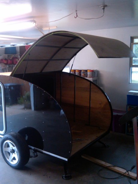

Starting my 2nd Cargo Tear tomorrow!

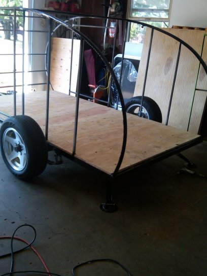

hatch mounted with shocks
Postby greglaw » Thu Jul 08, 2010 1:02 pm

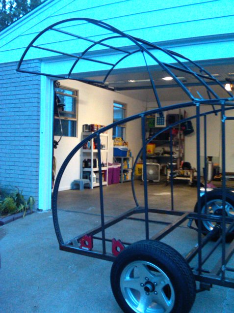

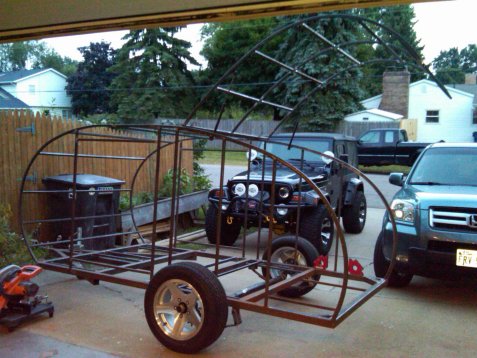

Finished up with the last of the tie down supports and mounted the hatch on some temporary hinges so I could mount the gas shocks last night.
The chassis will be bead blasted this weekend and painted next week and then I will skin it.

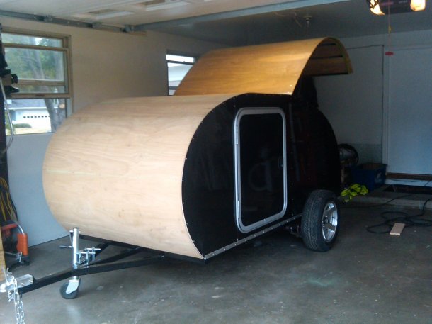

Postby greglaw » Mon Jul 19, 2010 10:12 am
Got some more done, time is getting close for us to be heading back down to Texas for good.
blasted the chassis last weekend and sent it off to my painter to seal her up.

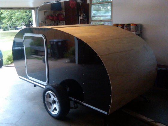

Back from paint with all the parts that will be exposed to the elements painted.

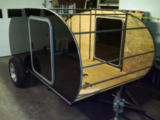

got the floor in, glued and screwed and leveling jacks mounted.

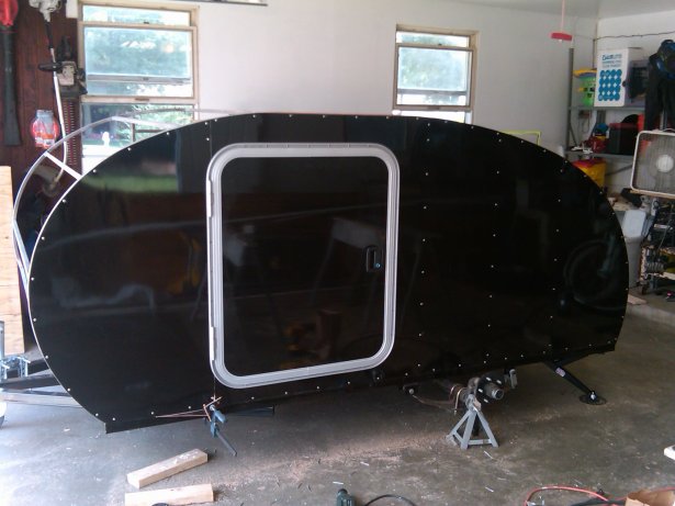

First side on and side door mounted.
Both sides done and doors in.
Decking for the roof is in place, should be cutting Al to skin it tomorrow.

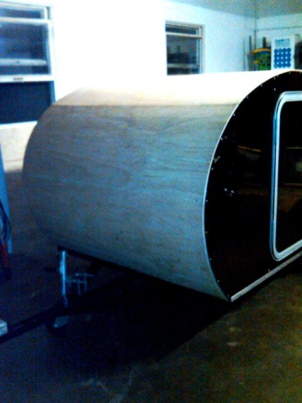

more done tonight
Postby greglaw » Mon Jul 19, 2010 9:15 pm
got the hatch deck put on tonight and fitted.

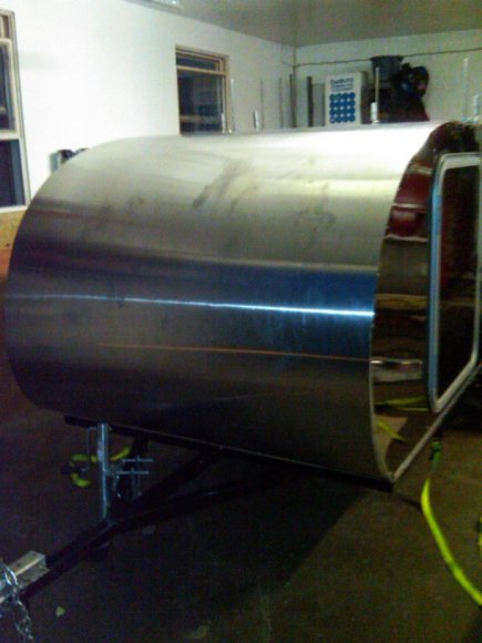

more progress last night but not where I wanted to be.
Postby greglaw » Wed Jul 21, 2010 8:09 am

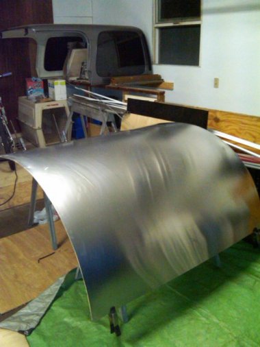

Started working on the skin for the roof and hatch last night. Wow that was a PITA, nothing like trying to manhandle a 20'x103" piece of aluminum by yourself. I got the two pieces cut that I need for the roof and hatch and trimmed them to fit. I will hopefully get them attach tonight.
I also got the roof edge trim cut to length and bent around the profile.

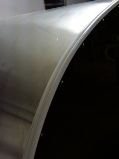

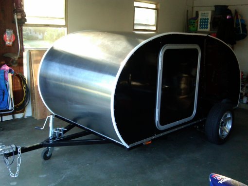

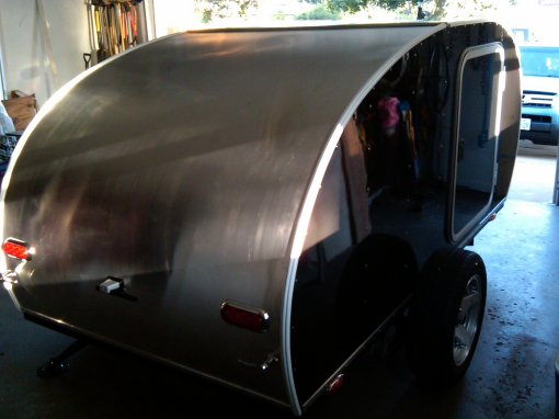

Roof skin on and trimmed
Postby greglaw » Fri Jul 23, 2010 6:23 am

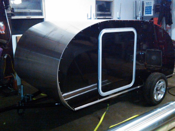

Got the roof skin on and trimmed, hatch is mounted and Al fitted but not attached. Started trying to fit the flush mount RV door latches but it got way to complicated and I do not have time for that right now so I ordered 2 latches and 2 L handles won't be as slick looking but will work for now.
Here is a close up of the edge.

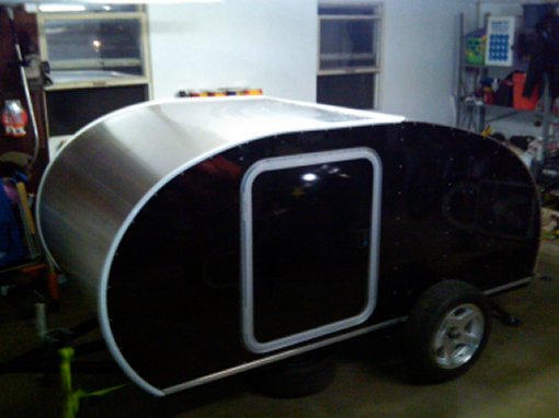

done
Postby greglaw » Wed Jul 28, 2010 9:29 pm

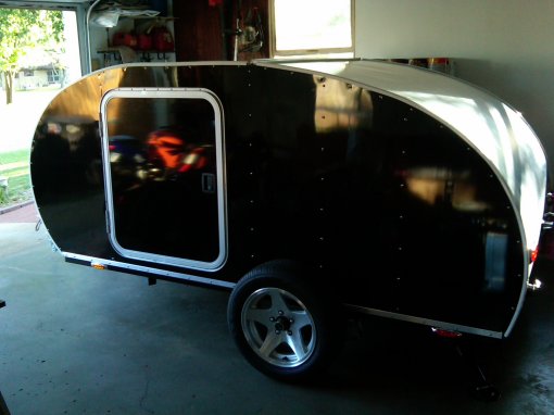

All the major stuff is done ready for her maden voyage south.
