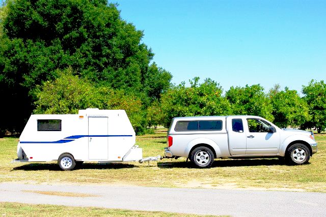

As promised, the Pop Top was taken out of the portable garage and cleaned up for a photo session. Below is one shot of the PT behind my ’06 Frontier so you can see the size of the camper with the truck as a reference. The other photos are on the Build WEB Site. http://www.thesquidget.com/ptbuild/exterior.html
I did some checking while it was out on pavement. Even with a 12" ground clearance, the overall height is even lower than I'd planned. My goal was to make a trailer that will fit inside a garage with a 7' (84") door sill. The overall height at the top of the fan dome is only 81 1/2", so I was under my goal height ty 2 12". The tongue weight without a deep cycle battery in the box is heavier than I'd planned, at 229 lbs. I think I have underestimated the total weight. I plan to get it weighed tomorrow and then I'll see if my tongue weight is more than 15% of the total weight.

Postby S. Heisley » Tue May 17, 2011 7:48 pm
:thumbsup: :applause: Beautiful! :applause: :thumbsup:
Posts: 8866
Postby bdosborn » Tue May 17, 2011 10:36 pm
Looks great Dale! Just like your rendering...

Postby cracker39 » Wed May 18, 2011 10:01 am
Thanks all.
I took the PT up to a truck stop to get a certified weight slip. The trip was about 20-25 miles, 1/3 of it on the interstate where I drove mostly at 65, but did a mile or two at 70. Except for a little slower acceleration in 6th gear (manual trans) and slightly longer stopping distance, most of the time I could hardly tell I was towing a trailer. On the secondary roads, with dips and irregularities, I could feel the load on the rear bumper when the trailer rocked forward or backward. Overall, it tows beautifully, even better than the Squidget if that’s possible.
The weight is more than I expected. But, with more materials in the top, a foot longer chassis adding to the weight of the steel used, and the extras that the Squidget didn’t have (propane tank, stove, sink and plumbing, icebox and more cabinets) I guess I shouldn’t have been surprised.
The weight on the axle is slightly more than the Squidget’s overall weight if they didn’t weigh it before I got it unhitched from the truck (and I’m still not certain they didn’t). I just left the PT connected and got only the axle weight of 1440 lbs. Yesterday I weighed the tongue at 229 lbs at the hitch with the nearly full propane tank and lawn mower battery in the box. That brings the subtotal weight up to 1669 lbs. Add the weights of the AC, Microwave, deep cycle battery and cushions, the overall weight will be between 1770 and 1780 lbs.
I used a 2200 lb capacity axle, so even with some supplies inside it will still be well under axle capacity. My tires are only load range B (1100 lbs each) so they match the axle capacity. Most of the heavy stuff will be carried inside the truck bed anyway, protected by the cap. I’ll only have some kitchen utensils, clothes and small equipment items inside the trailer while traveling. I find that I have much more storage space than I’ll need.
I just computed the tongue weight percentage based on my total weight estimate of 1780 and tongue weight of 265 when the larger battery is added. It calculated to be at 14.8%, right in the ballpark of where it should be. I lucked out again with my design calculations for weight distribution.
