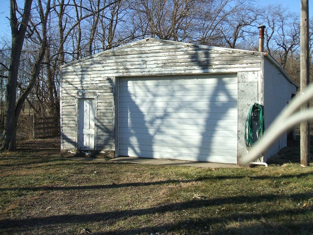

I have a fairly good place to do this, but it has NO HEAT and heating it would cost a fortune. I can only stand about 2 hours at 36 degrees working out there and glue and paint usually require 45 degrees or so.
You might notice the barrel stove in the corner. It was all rusted out and unsafe when I got this place 6 years ago, so it is useless. I've just never taken the time to remove it or replace it.

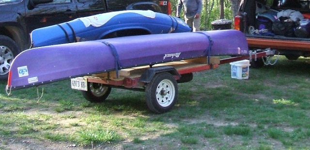

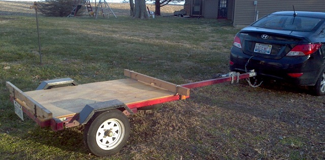

Here is a picture of the current trailer and my tow vehicle.
and a shot of it in use behind my old tow vehicle.
I have a canoe trip coming up in March, so I need to get the current trailer ready to haul two canoes. I began with a little destruction removing the current 54 inch canoe bars, the license plate, and the lights. Then I turned to cutting My Yakima cargo rack bars down from 78" to 68". Manufactured some brackets to mount the Yakima to the trailer from some scrap steel I had. I'll bolt those to the side of the frame. After much scratching of my head about how much width I really needed, I decided to cut the racks to 70" and give that a test fit, because you can't glue the steel bars back together once you've cut them. I also cut a 2X4 for the bumper/light mount. When I bought this frame kit they provided TWO license plate brackets that I didn't use so I'll use those to mount the lights to the bumper. The reason I need the bumper is to mount the lights out beyond the boats which will stick out 3.5 to 4 feet beyond the end of the trailer. It looks REALLY wide. They stick out 15" on each side from the frame. The car is 67 inches wide so it might be fine. The mirrors stick out another 5 inches each side.

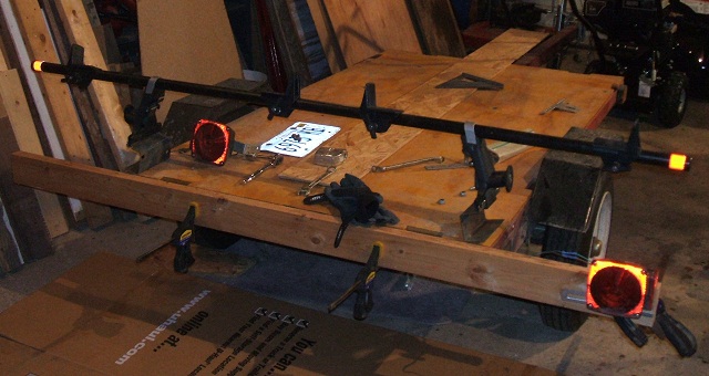

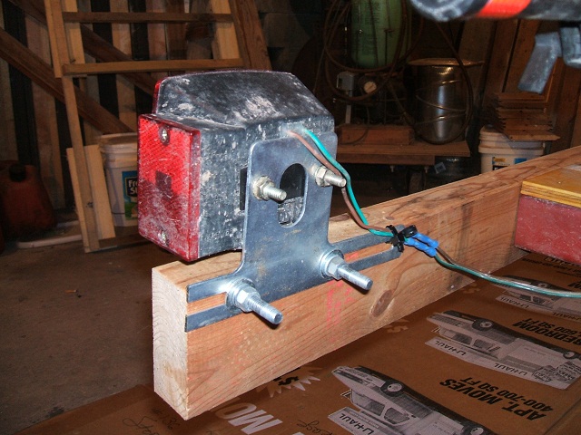

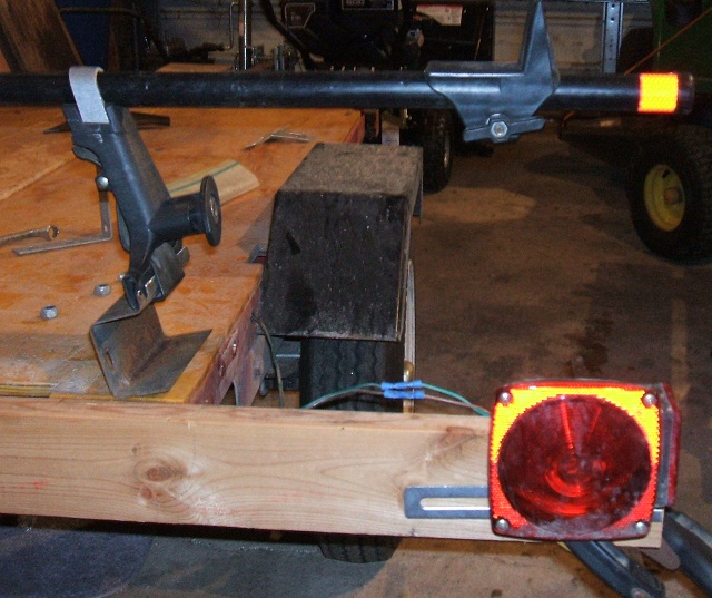

Question for the group...Should the lights be above or below the bumper??

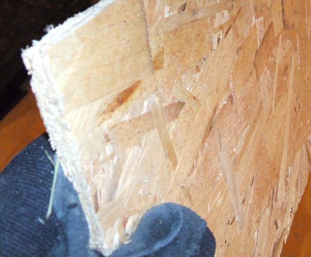

Also, I was thinking of using 1/4 wafer board instead of plywood. Less than half the cost.
If I water proof this real well do you think it will hold up??

Postby Martiangod » Tue Feb 14, 2012 9:51 pm
Waferboard is the demise of most manufactured trailers, its also heavier then ply.
Where are your wanting to use it on the trailer?
As for lighting there are DOT specifications that need followed
Tailights must be 15" to 72 inches off the ground
http://www.nhtsa.gov/cars/rules/standards/conspicuity/trlrpstr.html

Postby mckenney56 » Tue Feb 14, 2012 10:16 pm
I was thinking of most all of it in wafer board. Floor, walls, and door. I already have about a sheet and a half of that stuff. It would have saved me dollars. This stuff is around $6.50 a sheet. 1/4 inch ply is twice that I guess.
The trailer floor currently sits 17" off the ground. So I guess on top it is.
Thanks for the info.

Floors are an absolute no no, roof if you don't walk on it and use a good aluminum or membrane skin, and seal really really well.
Walls, umm wouldnt recomend it but if you treat it and edges very well, especially the bottom, you might get away with it.
My trailer sides are black right now, I knew it wouldn't get covered and have to go through rain and snow for a few months, i soaked it good with oil base stain, just happened to have ebony on hand

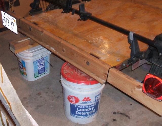

Postby mckenney56 » Sat Feb 18, 2012 9:37 pm

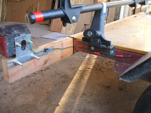

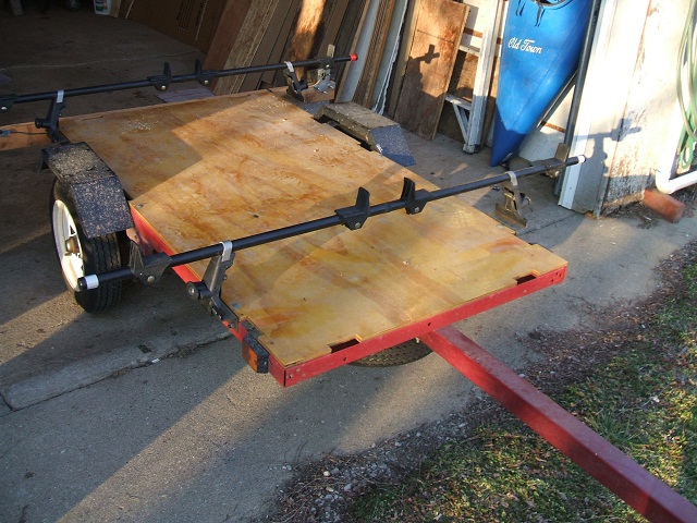

Got out to the shop for a few hours today. I drills some holes and put in some bolts and got the bumper, lights, and rear rack mounted.
Maybe tomorrow I'll get the front rack put on. Then I'll move on to repacking the bearings.

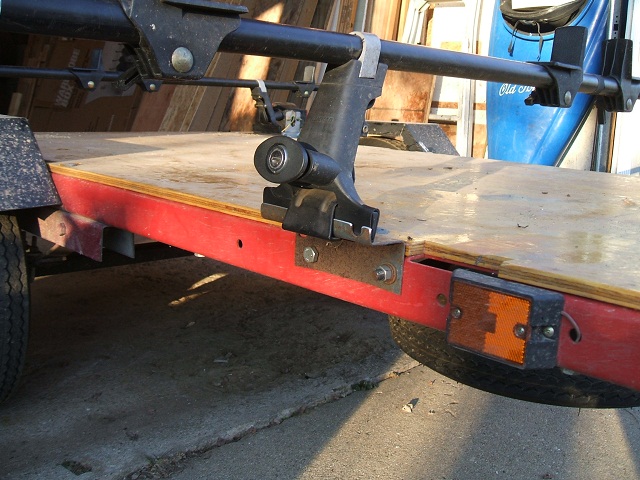

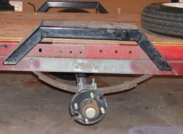

Postby mckenney56 » Mon Feb 20, 2012 1:58 am
I got the front rack mounted.

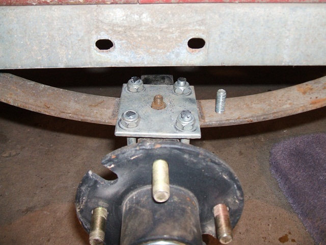

Decided to remove a leaf from the Springs. Only saved about 5 lbs according to my bathroom scale. After removing a spring I also decided to shorten the bolts.
Before
Then after.

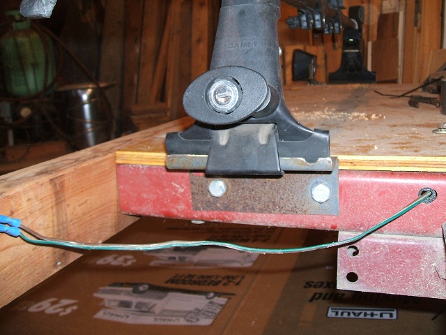

I Also lengthened the wires and tucked them out of harms way.

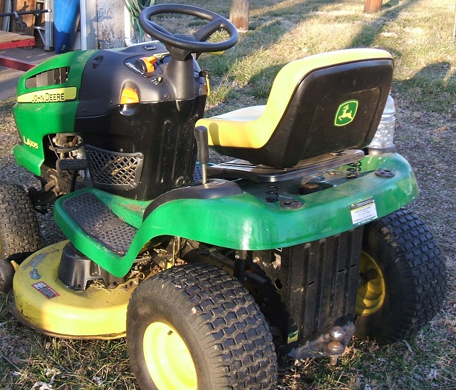

Here's a pic of my cheap jack stands.
And here's a pic of my alternative tow vehicle. A little slow though.

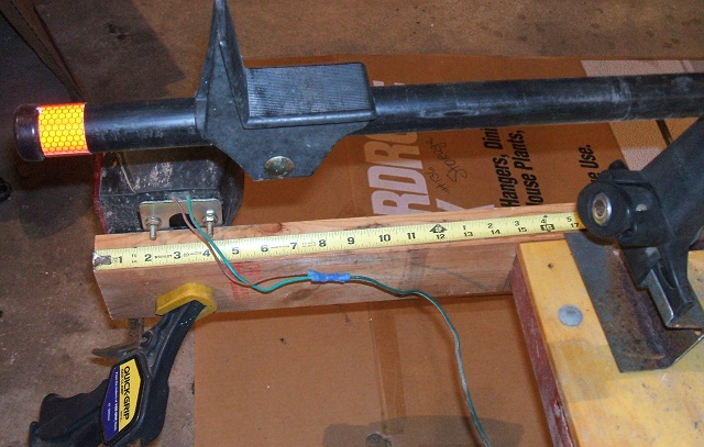

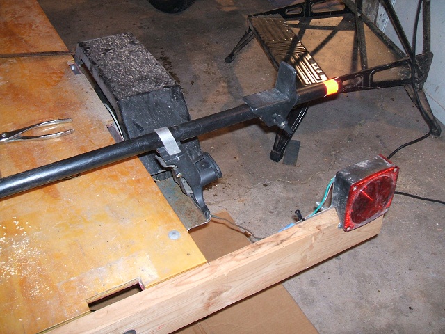

Postby mckenney56 » Mon Feb 20, 2012 11:45 pm

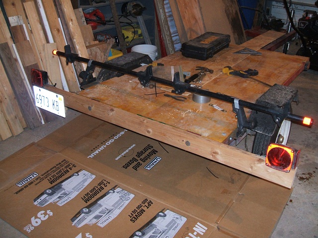

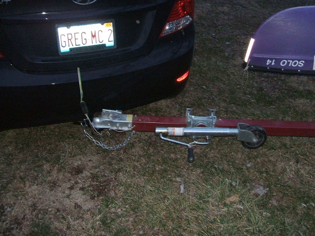

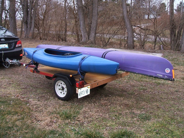

Got the wheel bearings repacked and decided a test run was in order. Loaded the canoe and kayak and hooked it up to the car.
Realized when testing the lights that the wood bumper doesn't conduct juice for the ground. That's why we test these things. Ran a ground wire from each light to a bolt on the frame. Problem solved. Test drove around the county roads near my house for a while and it seemed to tow just fine.

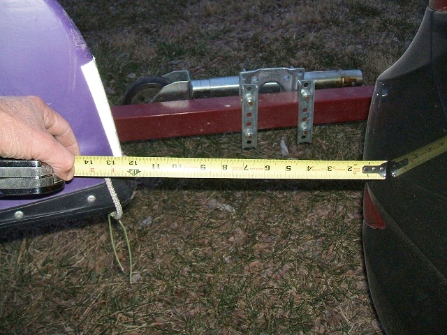

when I got back and was attempting to turn it around I hopped out to look at the turning clearance.
looks like I could either move the boat forward about 10 inches, or cut 10 inches off of the tongue. That would leave 2 inches to spare. Moving the boat forward might add to the tongue weight a little, but would cut down on the 4 foot overhang out the back.
Speaking of weight, I weighed it again with all the changes and the boats loaded on it. I had 54 lbs at the ball, 151 Left tire, and 155 right tire, for a grand total of 363 lbs. That was with all the paddles inside the kayak, which might amount to 7 or 8 lbs.

Postby Martiangod » Mon Feb 20, 2012 11:57 pm
I wouldn't shorten the tongue, longer tongue allows the trailer to track better.
Lot of people with early egg trailers actually have the tongue lengthened to settle down swaying, esentially adding tongue weight by leverage

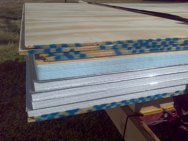

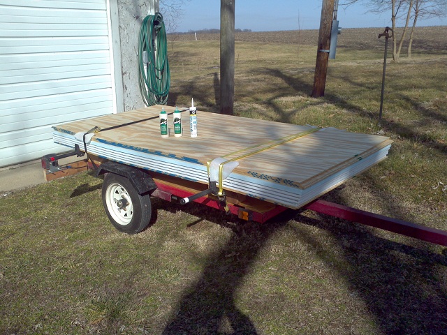

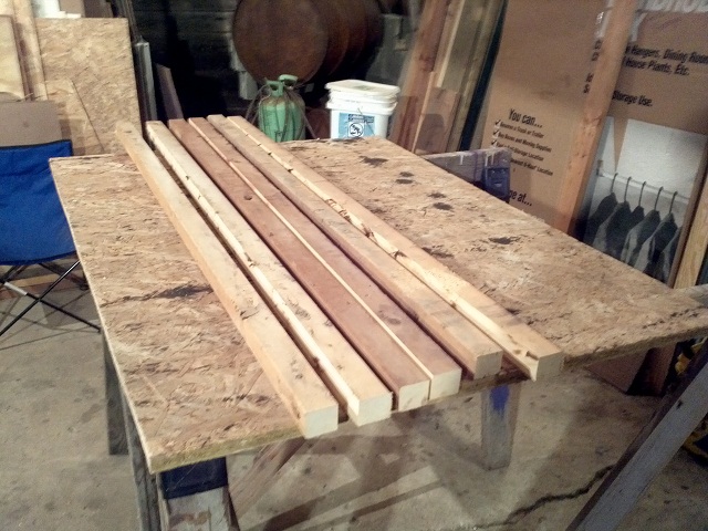

Postby mckenney56 » Thu Mar 01, 2012 10:48 pm

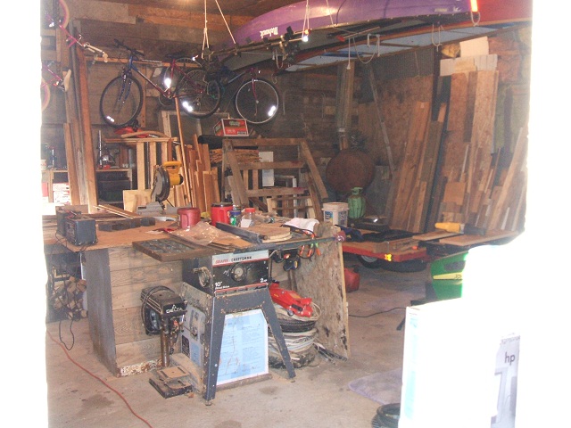

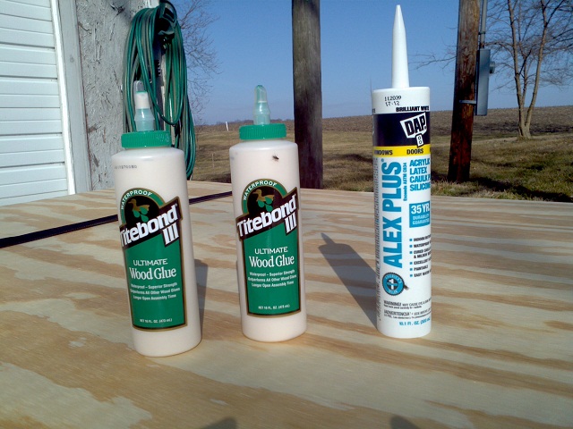

Really nice day here today, so I took the afternoon off to go buy some materials. For $198 I came home with this.
7 sheets of plywood, 5 sheets of insulation, glue, and caulk.
Worked for about 3 hours reorganizing the shop where I could use the table saw.
Searched through all my lumber and found enough straight 2X4s to rip some down for the floor.
Finally, the words we have all been waiting for.....Let there be SAW DUST!
