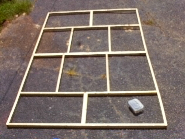

1st I cut my 1 x 2s for the floor.
Then I built my frame.
I had some scrap pieces left over and they were long enough, so I put some between the floor joists for added support.
floor joists

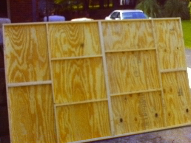

I cut down a couple of pieces of plywood then glued and screwed them into place.
plywood floor installed on frame

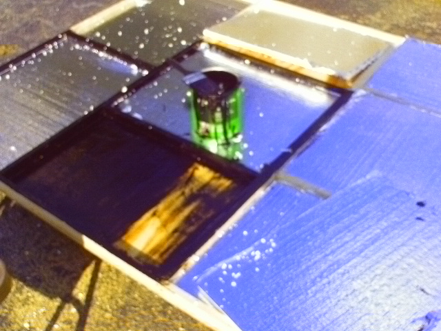

Next I cut some Styrofoam insulation to fit between the joists. After giving them all a dry fit, I removed them one at a time and sloped on the black roof tar and then pressed the foam boards into the wet tar.
Adding the roof tar and Insulation

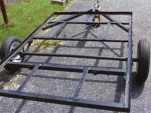

Worked a little on the frame. We got some angle welded to the sides of the tongue and under the frame. There is a huge difference in the amount of "play" and twist in the frame now. (pics to follow soon.)
There were several pieces of angle attached to the sides of the trailer frame that I assume were to be used for side boards on the trailer. I cut those off and ground them down pretty smooth.
The fenders were a "female dog" to get off. I finally got them removed but it left behind a lot of metal. I ground on the leftovers for awhile. Finally I decided to just leave it. When I dry fit my walls to the outside of the frame, I'll mark the wood at these spots, and then I'll use my router to remove just enough wood to allow the walls to lay flat against the frame.
I removed the tail lights/turn signals along with the metal brackets that held them in place.
Sometime this week my Brother-In-Law is supposed to add some angle supports down the middle of the floor between the cross members. Afterwards I'll touch up the paint and bring it home.
EDIT (8-25-12) Here are before and after pics of the trailer.
Before: Image
After:
trailer after modification

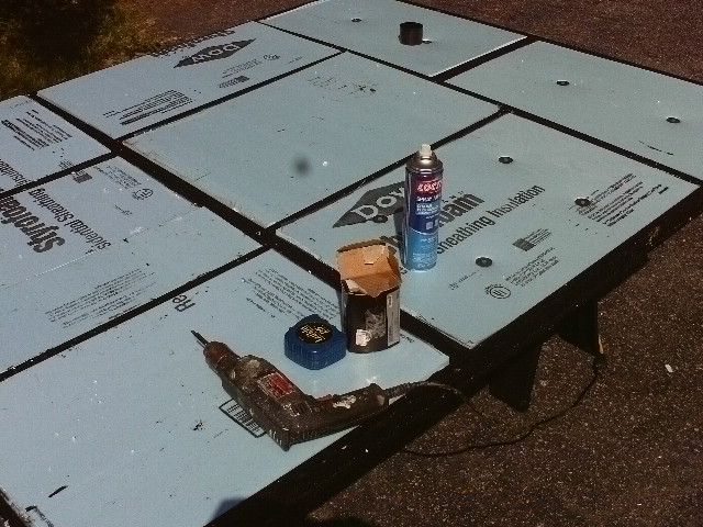

Anywhoo... I did get to work on Little Jo' a bit today. I installed a second layer of insulation to the floor. I used some solid Styrofoam this time with a coat of spray adhesive between the layers and a few screws and washers to hold it all in place.
teardrop trailer 016.JPG (166.01 KiB) Viewed 1054 times

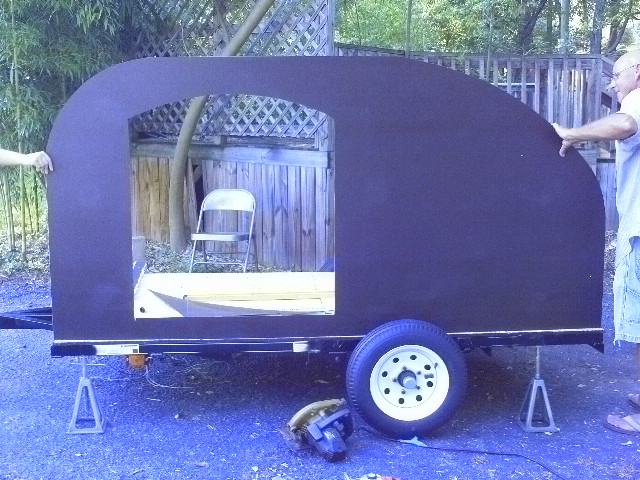

Then I cut my template out of a piece of 1/8" Masonite.
teardrop trailer 023.JPG (173.6 KiB) Viewed 1054 times
