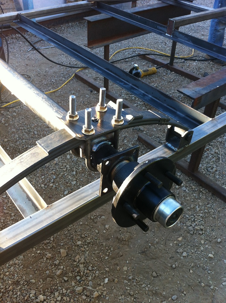

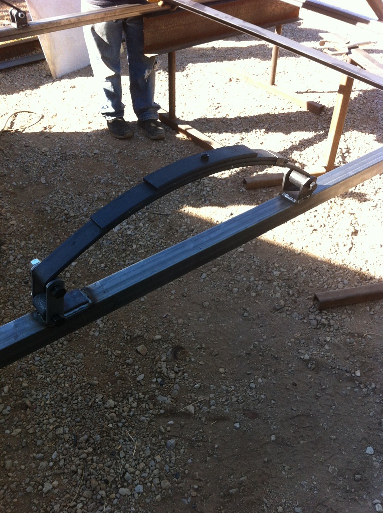

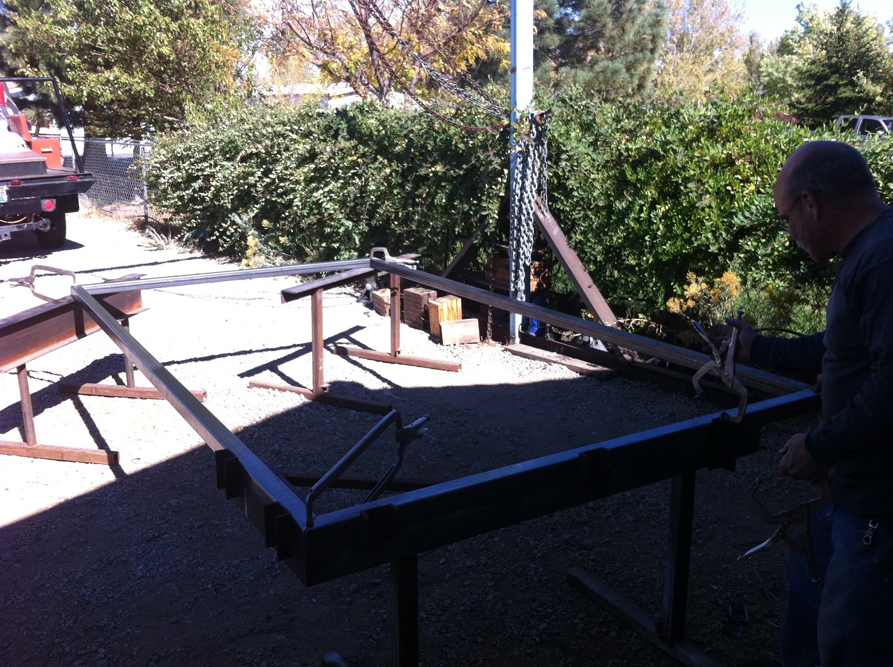

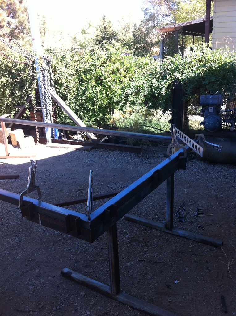

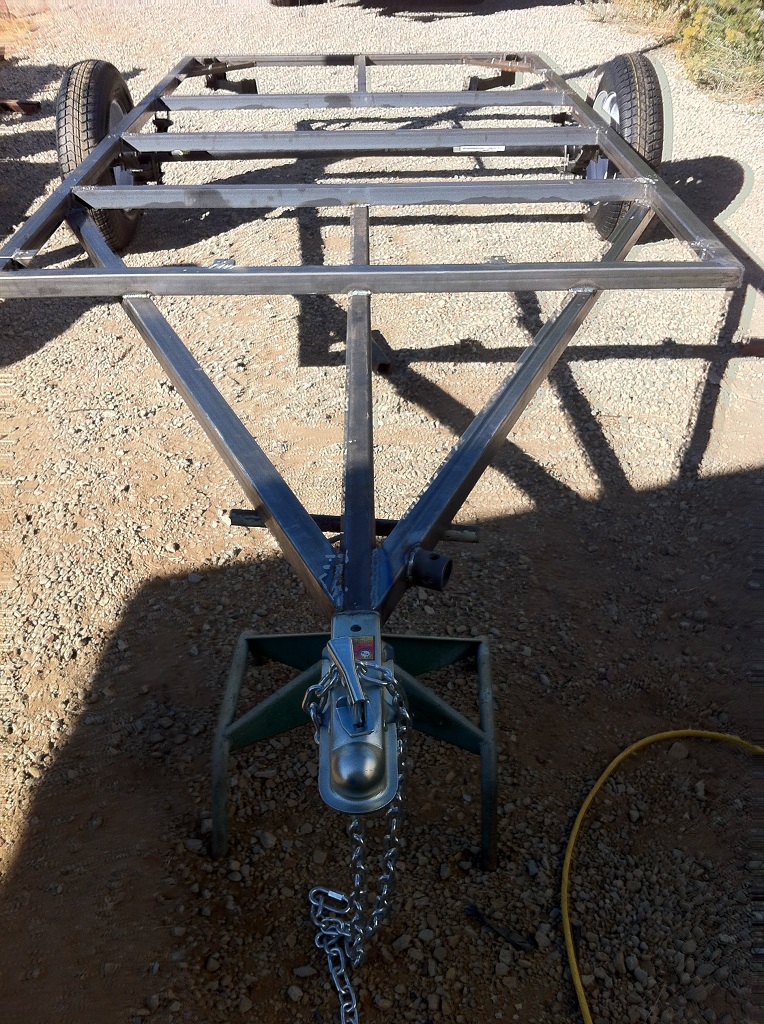

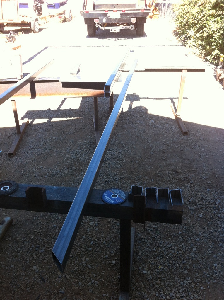

The Trailer Frame.
I spent a lot of time looking for a frame. I almost bought the 5x8 from Norther tool but its back ordered right now until December. I looked every day on Craigslist and even went and visited a few in person. I just couldn't see putting something we spend so much time building and thinking about and dreaming of on a puny little bolt together trailer. So I went in search of a welder. I'm paying about $1500 for a custom trailer by the time everything is done, but I feel that this is a good investment.
I met my new welder friend (found on Yellow Pages) at the trailer shop on Tuesday and we ordered all the parts we would need. Then we went to a metal supplier to get all the 2x2 square tubing and angle sticks. We met this morning at his home shop and the build is now a reality.
The tongue is actually completed with chains and jack mounted. We will be flipping the trailer over tomorrow and completing the welds. Also to be completed are the stabilizer jack mounts in the back corners and the bolt mounts.

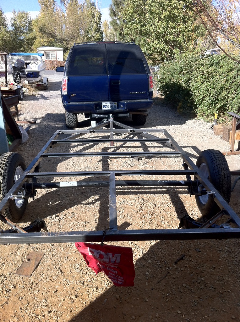

Postby Brodie » Sun Oct 21, 2012 7:46 pm
Trailer update.

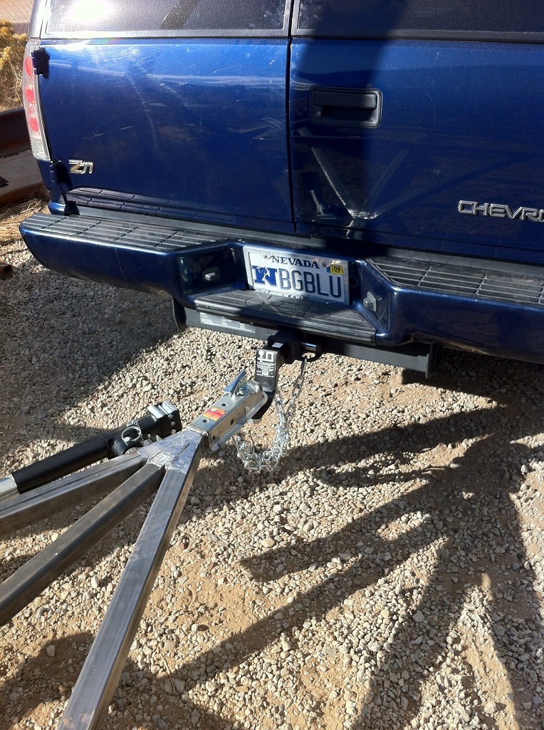

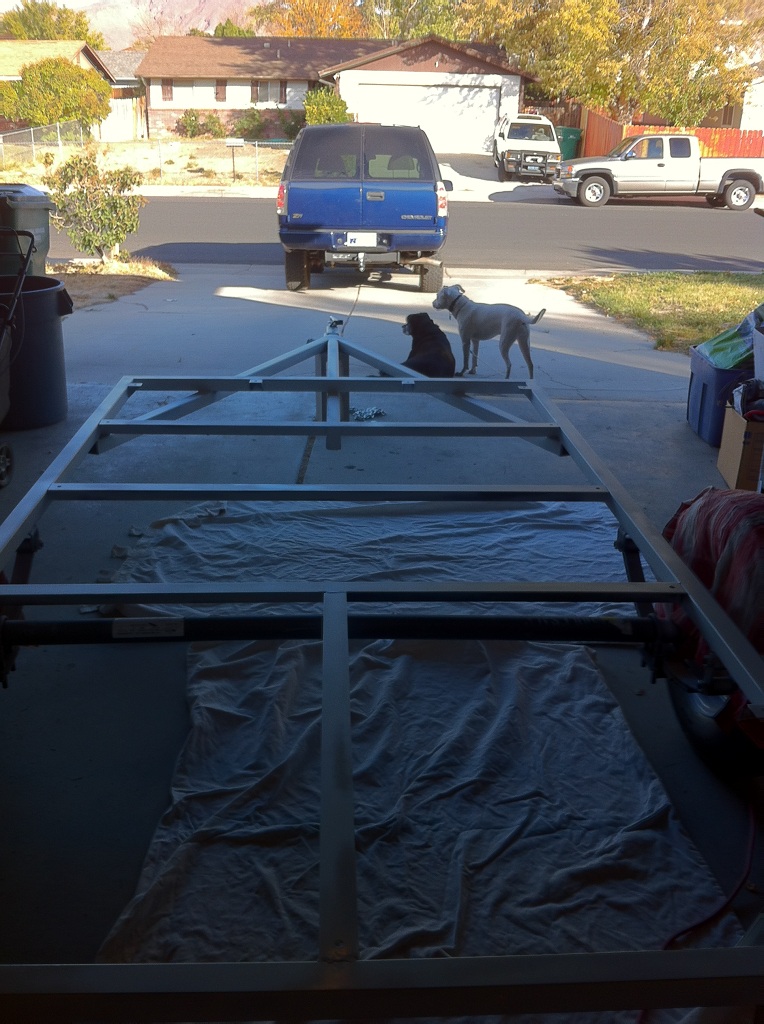

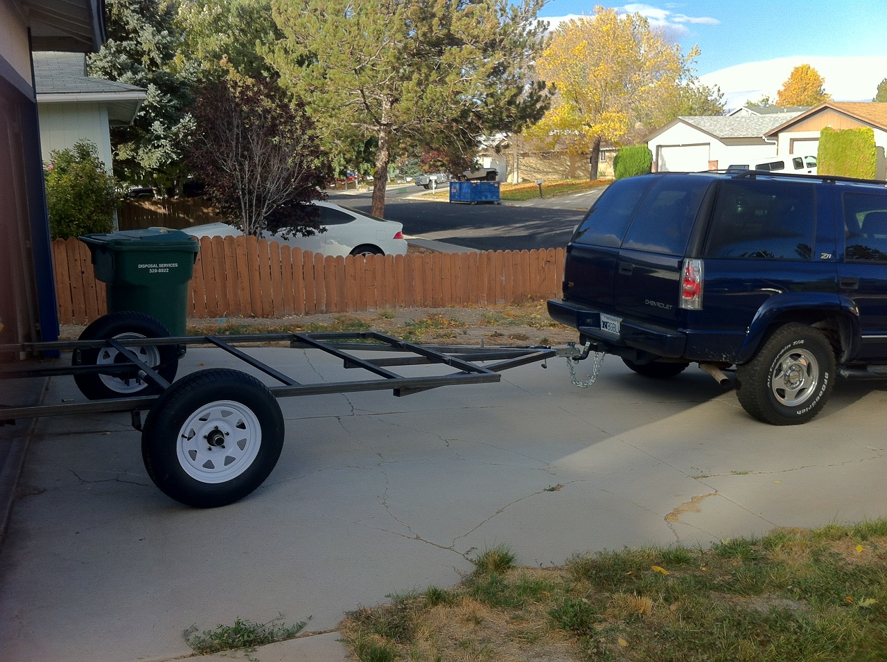

Here is the tow vehicle, 2000 Tahoe Z71 with the 5.7 V8. I have no weight issues other then for resale in a few years
I haven't decided if the project is going to happen in the garage or on the 10x30 patio with cover in the back of the house.
I need to cut the safety chains down and put different hooks on the end. And I'm not sold on the jack. It doesn't have a wheel to help move the trailer around, and it needs some sort of locking mechanism otherwise it will just walk away.
Now I wait for the Rust-Oleum Primer and Paint to arrive and we get it protected.

Postby nevadatear » Sun Oct 21, 2012 8:35 pm
I think we would agree with you about the jack. We push our trailer around a lot! And if you ever get to a big gathering like IRG or the DAM, you and several of your new best friends and campmates will be pushing your trailer in hitherto-fore directions you never expected. Your welder may not have realized how much teardroppers take advantage of their trailers light weight to move in a crosswise or other more favorable campsite location.

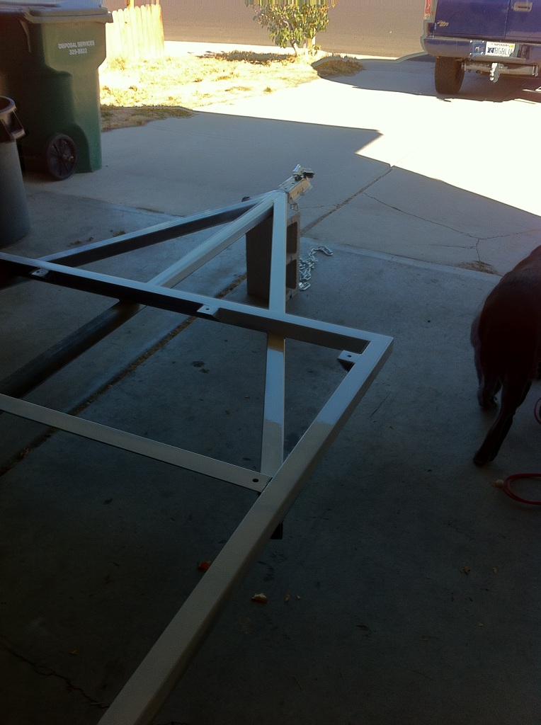

Postby Brodie » Sun Oct 28, 2012 11:36 pm
Trailer Paint
The primer is http://www.rustoleum.com/CBGProduct.asp?pid=154.
It doesn't go on easy. Really need to shake lots and start with a warm can. I put them near the heater vent overnight to help.
The finish coat is Metallic Cobalt Blue http://www.rustoleum.com/CBGProduct.asp?pid=30 .
Waiting for the bottom to dry then one more coat and flip it back down to put a final coat on the top and side.
