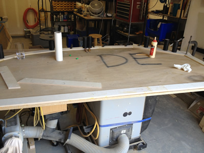

After I used my new profile template to draw an outline of the profile on a 1/8" ply side, I began piecing together 1/2" Baltic birch plywood (no voids) to form an edge around what will become the profile.

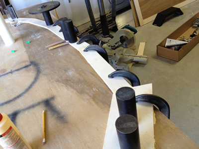

So, I glued down the edges, making sure to cover the line that I drew with the profile template. I did not care how much excess was going to be cut off, I only wanted to make sure there was between 2 1/2" - 3" inches left behind. The inside of the wall does not have to be beautiful, only the edge.
Gluing down the edge of the profile
2012-07-29 10.36.04-small.jpg (52.62 KiB) Viewed 1665 times
I clamped things down like crazy and used weights when I could.
Detail of edge glue down
2012-07-29 10.36.16-small.jpg (51.6 KiB) Viewed 1665 times

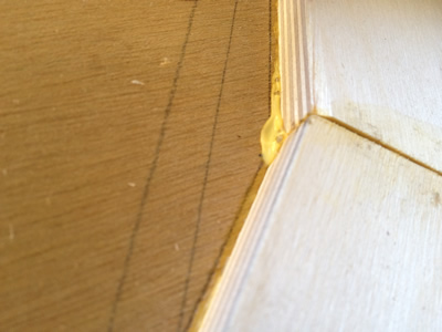

Even with all that, I had two joints that were a little less than perfect, so I sanded them down to level them out once it dried. I do not want to end up with a bump when I glue the skin on the other side.

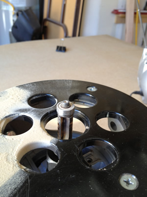

Cutting the sides...
I took my profile template and screwed it down to the side. I flipped it over and used a formica bit to cut the edge off... and forgot to take pictures of actually cutting the edge.
Formica bit
2012-07-25 18.10.24-small.jpg (40.32 KiB) Viewed 1664 times

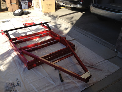

In between waiting for glue to dry, I decided to take advantage of the Harbor Freight sale that was going on for a couple of more days. I went to my local HF only to find they did not have the trailer in stock- folding trailer, 12" wheels. The woman behind the counter told me it was an Internet-only trailer and the sale price applied only if you bought it off the Internet. I live near Sacramento. There are several HF stores here, so I called the next one down the road. He told me she was absolutely wrong and they had exactly that trailer in stock... but could not sell them because of a problem with the title.
Reminding me of "Goldielocks and the Three Bears," I figured if the first bowl was too hot and the second was too cold, well, I should try the third...
Not giving up, I phoned the third store, half-way across Sacramento. They had three trailers. About 30 minutes later, they only had two!
Harbor Freight trailer
2012-07-28 18.16.32-small.jpg (52.79 KiB) Viewed 1663 times
At first I was going to build a trailer, then I decided to use HF, then I was going to build it again. I started thinking about it and decided I needed to commit. I want to keep this first trailer clean and simple, get it finished and go camping.

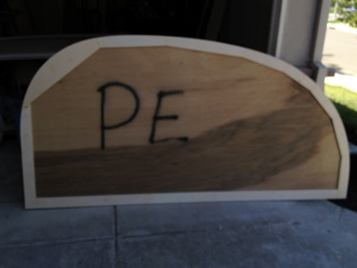

So, it has been a while since I last posted. I need to do a little catch up...

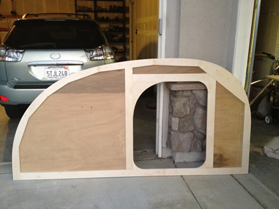

I finally cut out the shape of the doors. I took 1/2 baltic birch plywood and built a frame with the shape I wanted and then used a router with a formica bit (my favorite!) to cut the 1/8 luan to the exact shape.
Profile with door cut out.
profile with door cut.jpg (42.76 KiB) Viewed 1600 times

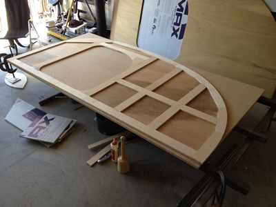

Then I added more bracing inside the wall. I am going to put foam insulation in the voids. I put the bracing in so that I would have solid wood to screw into when I attach the interior wall between the kitchen and the sleeping area. I am also going to attach some things on the outside using this bracing as well.
Interior bracing.jpg (57.53 KiB) Viewed 1600 times

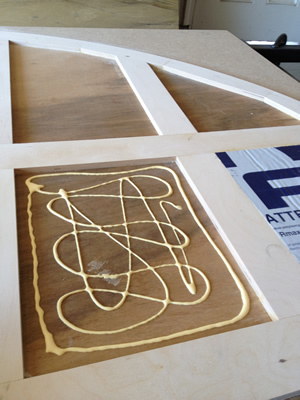

Postby Steven.Cox » Fri Sep 28, 2012 1:03 am

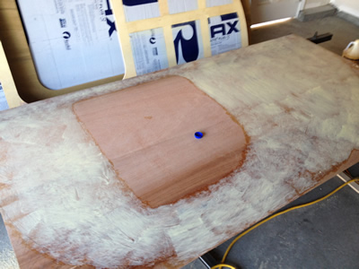

After I added some bracing, I cut foam to fit in the voids. I started out by dumping a bunch of glue where the foam would be attached.
Gluing the Foam.jpg (46.21 KiB) Viewed 1600 times

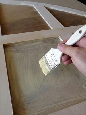

I quickly decided I needed a fast way to spread the glue, so I took a paintbrush I had for fiberglassing and sacrificed it.
Spreading the Glue.jpg (37.5 KiB) Viewed 1600 times
After the glue was spread evenly, I put in the foam.

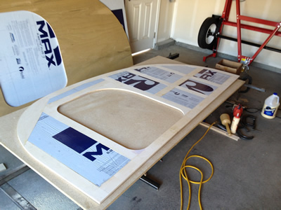

Re: L'Escargot
Postby Steven.Cox » Fri Sep 28, 2012 1:11 am
Time to glue the other side of the wall.

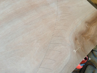

I traced the shape of the wall onto a piece of 1/8 luan so I would know where to put the glue and, more importantly, where not to put the glue.
Trace the Profile.jpg (36.9 KiB) Viewed 1599 times

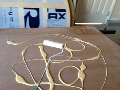

Then I started dumping glue. I used a 4" paint roller to spread the glue out evenly and quickly.
Dump lots of glue.jpg (41.07 KiB) Viewed 1599 times
Here is what it looked like before I glued it up. If you notice, the profile leaning up against the wall had glue on the plywood frame as well. So, when I stuck it down, it really stuck!
Smear it all over.jpg (46.91 KiB) Viewed 1599 times
I sandwiched everything together and put a piece of particle board on top of it to weight it down while it dried.

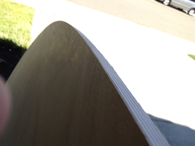

Wow, look at those sexy curves! Once I finished my walls, I had to stare at them for awhile and decided to take a close-up of the curve detail.
Sexy curves.jpg (48.48 KiB) Viewed 1598 times
