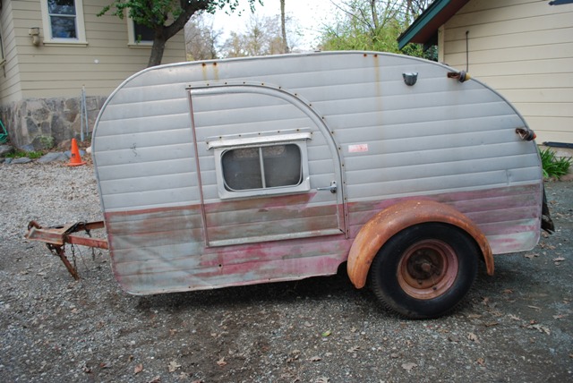

Postby OutsideArt » Mon Jan 17, 2011 4:19 pm

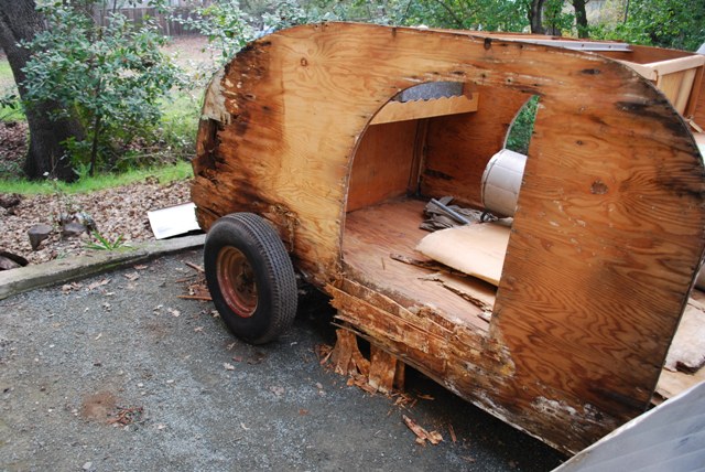

Well, I pulled the King Richard home on 1/8/11. Not too much info on it other than it went to auction and didn't sell so it wound up in wrecking yard. I firend of mine wound up with it and gave it to me. It has the number 123 stamped on the frame near the tounge. Still trying to figure out the year of production

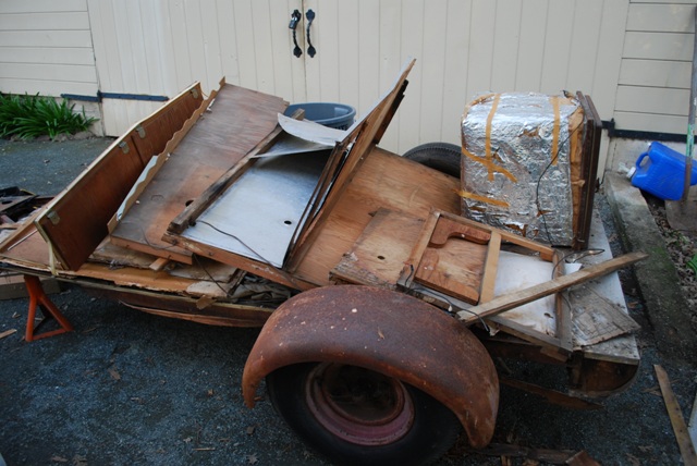

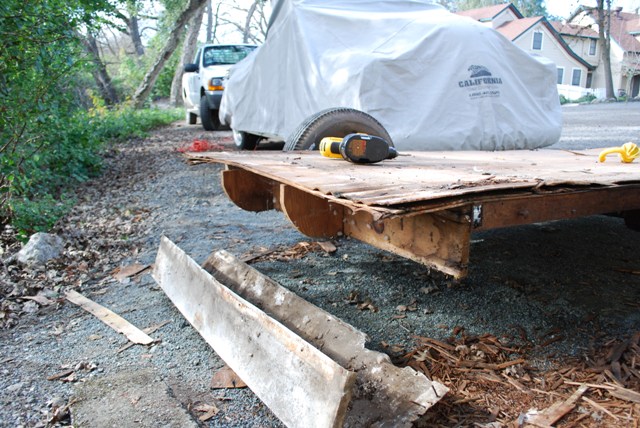

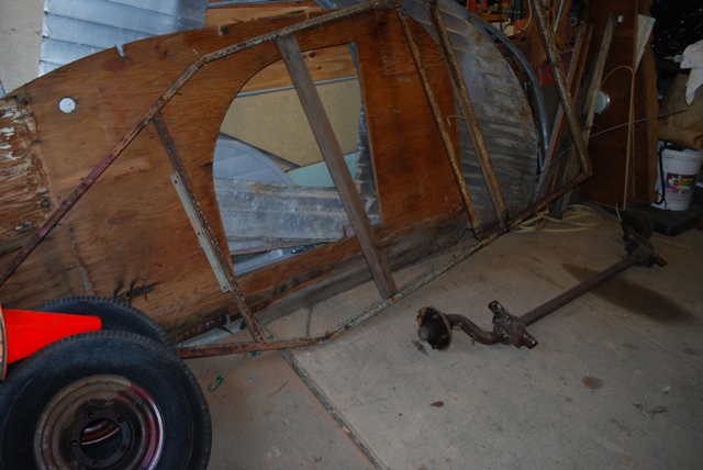

It might be too much with two little ones, but I've been picking the trailer apart whenever I have an hour or two. I am trying to save everything I can for templates.

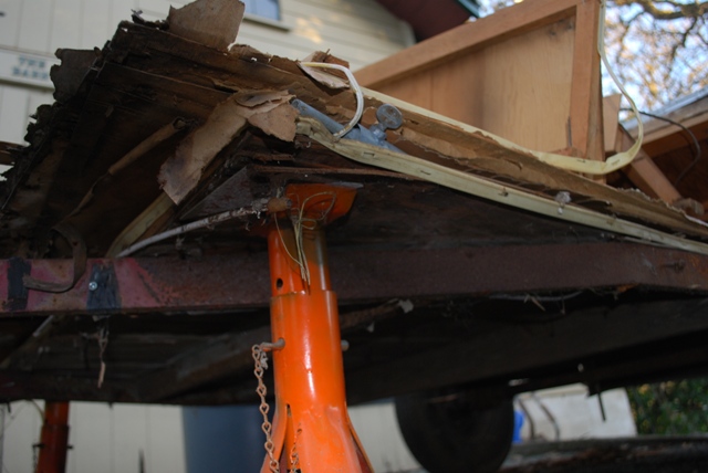

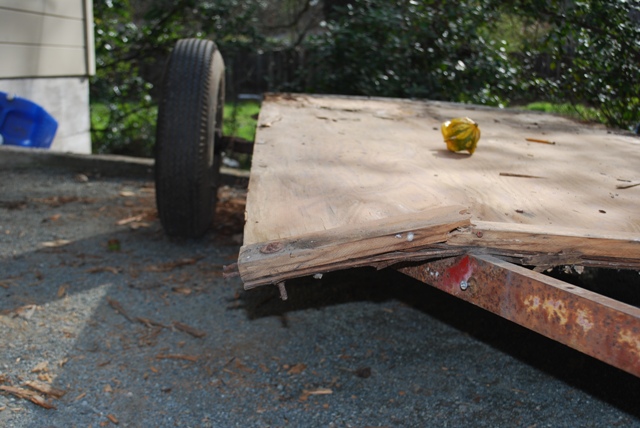

Its going to need all of the wood replaced. This side fell apart when I touched it. None of the aliminum siding was sealed on in any way except for the edging along the roof.

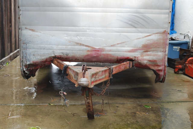

The whole front end was sagging and had been repaired numerous times
Why? because the metal frame didn't go under thaose corners. I plan on fixing the frame here so it doesn't happen again.

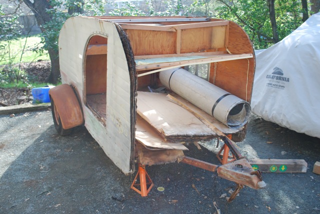

A pile of parts

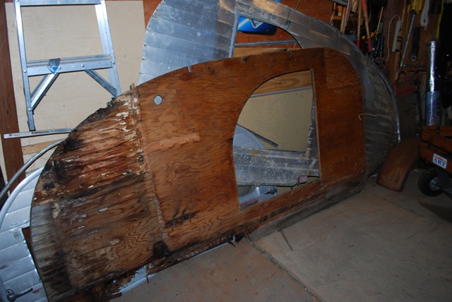

The left side was in better shape and should make a good template. The old aluminum and doors are stacked as well.
Just a little more work and it will be down to the frame, then the fun begins.

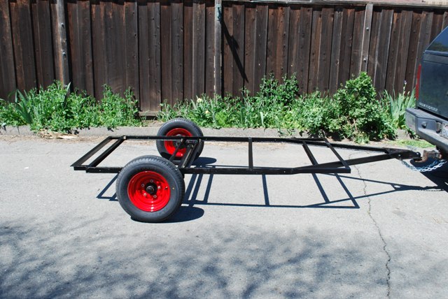

Postby OutsideArt » Thu Apr 07, 2011 4:04 pm
Finally got some work done

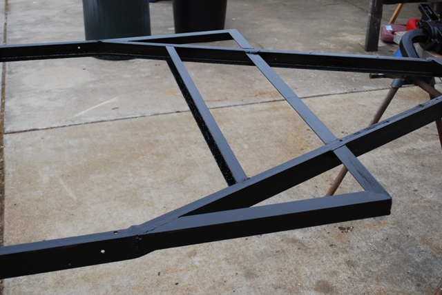

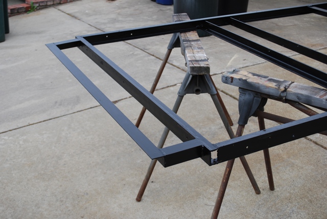

The frame has been cleaned and painted. There is a new hitch and chains. I also reinforced the corners where it failed before. The hubs have been rebuilt, and there are new tires with powdercoated rims. I've also done some bodywork smoothing the fenders and they are ready for paint. About half of the original trim peices have been polished out and one window has been rebuilt with new glass and screen. just picked up lumber today.
Here are the front corners
and an extension on back
