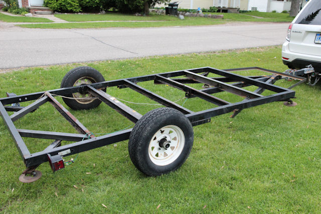

Picked up the chassis this morning. It almost looks like the axle is too far rearward, but it's exactly where I told the welder to put it. :shock:

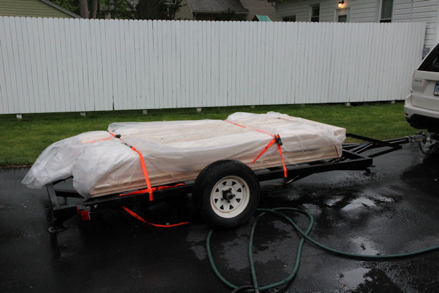

Well, tomorrow morning, if it's not raining, we are headed to Menards to get some of the underlayment stuff.
Here's where the design is at...
Re: Rockhopper
Postby mikeschn » Sat May 26, 2012 11:14 am
We've got wood!

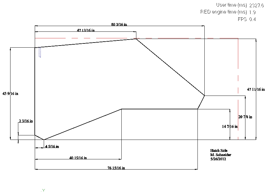

Postby mikeschn » Sat May 26, 2012 1:15 pm
First up, I am going to cut the hatch side. How about if I put the dimensions I use in this thread in case anyone else is interested in building this down the road? :D
Re: Rockhopper
Postby High Desert » Sat May 26, 2012 1:26 pm
mikeschn wrote:First up, I am going to cut the hatch side. How about if I put the dimensions I use in this thread in case anyone else is interested in building this down the road? :D
I think that is a stellar idea Mike 8) :D

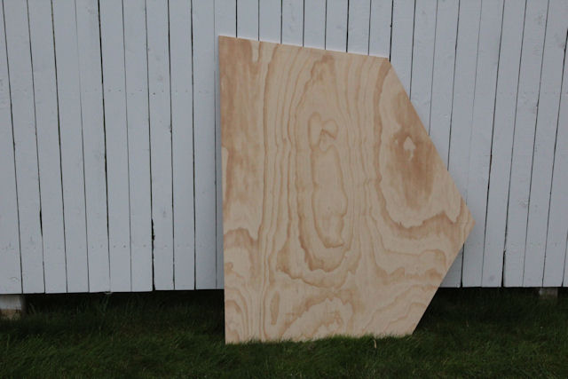

Postby mikeschn » Sat May 26, 2012 1:58 pm

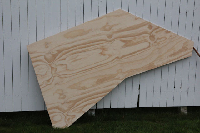

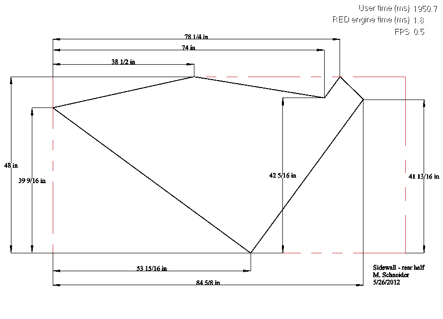

Next I am working on the sidewall. This will be made from 2 pieces of 1/2" plywood.
Here is the rear piece...
Don't let the angle throw you for a loop. I rotated it so you can see how it is cut out of a piece of 4x8! When it's assembled, the right line will be vertical.

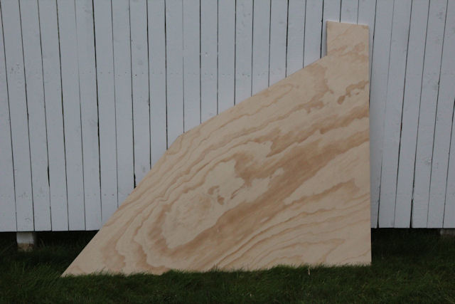

Postby mikeschn » Sat May 26, 2012 2:35 pm
Here's the front part of the sidewall, also cut from 1/2" plywood.

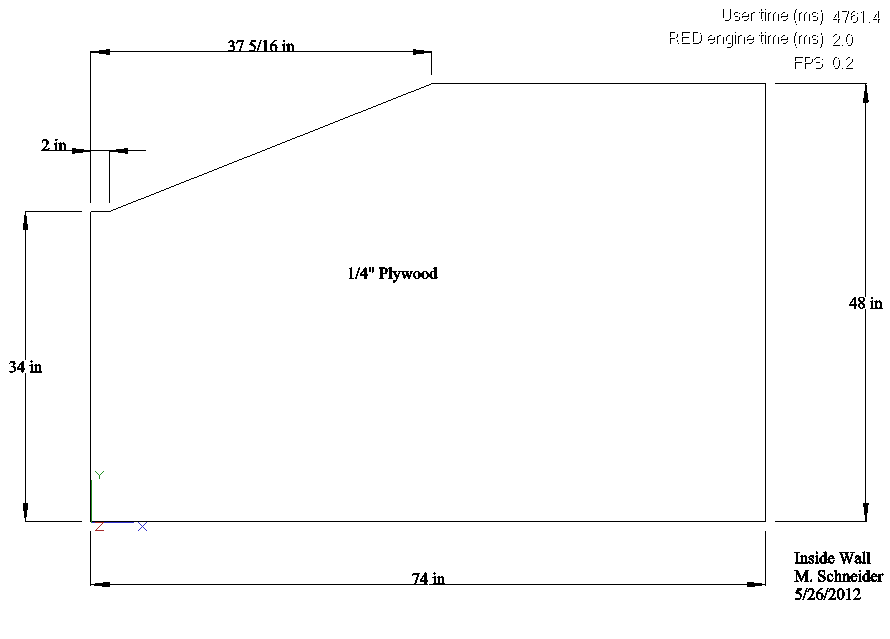

Re: Rockhopper
Postby mikeschn » Sat May 26, 2012 3:11 pm
Here is the inside of the sidewall. It's cut out of 1/4" plywood to save a little bit of weight.
