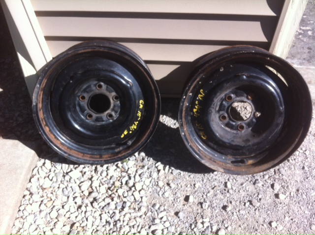

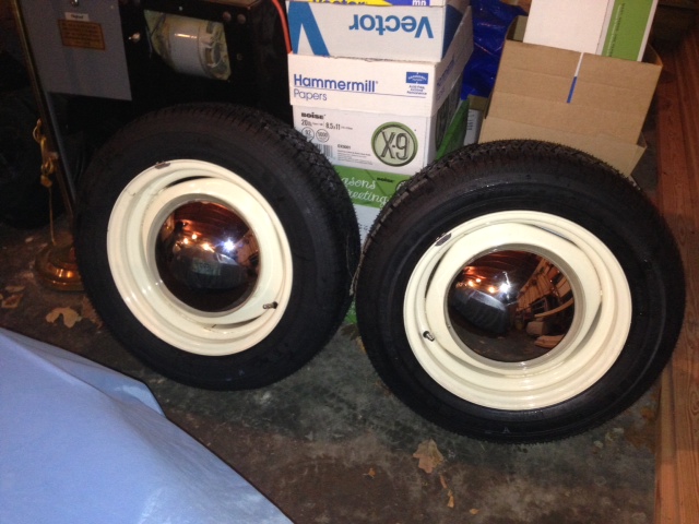

Postby bjeppson » Sat Oct 13, 2012 7:15 pm
The build saga begins. If I did this correctly it will have pictures of the wheels.
:D
Bob
Wheels after
Woodrows wheel after.JPG (120.04 KiB) Viewed 2848 times
Wheels before
Woodrow wheels before.JPG (143.3 KiB) Viewed 2848 times

Postby bigbendhiker » Sat Oct 13, 2012 7:41 pm
Your pictures showed up! :applause:
Your wheels look great. :thumbsup: What did you paint them with?

Postby bjeppson » Sat Oct 13, 2012 10:06 pm
Thanks,
Wheels from a junk yard, sandblasted and powder coated with the color classic ivory.
Bob

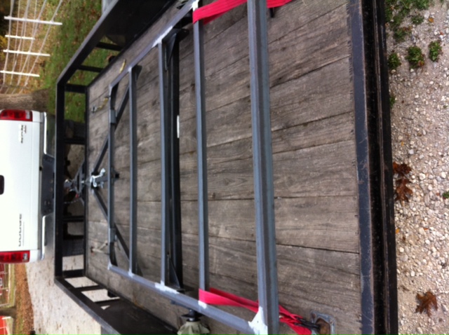

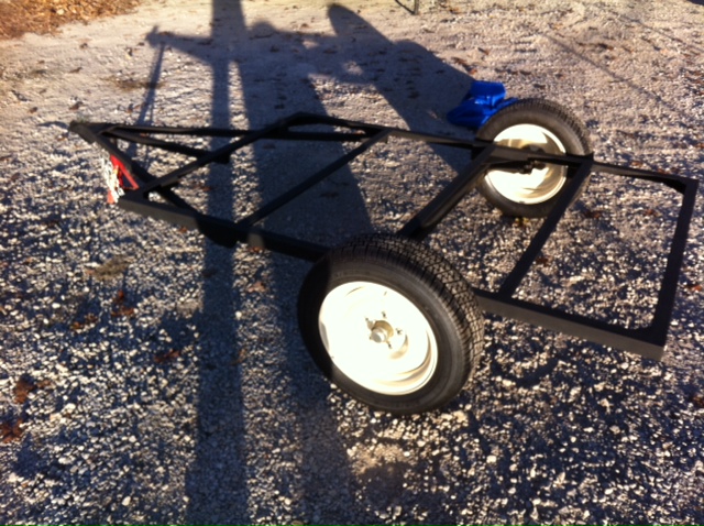

Postby bjeppson » Fri Oct 26, 2012 3:38 pm
Here's the frame with the Dexter axle for Woodrow's build. I guess it is too late to make it into a lamp. Next step, prime and paint. I had this welded as I am a sawdust guy.
Bob
bjeppson
Posts: 57
Joined: Wed Sep 26, 2012 12:22 pm
Location: Lone Jack, Mo
Re: Woodrow's Build
Postby bjeppson » Sat Oct 27, 2012 11:57 am
:) Forgot the picture
Woodrows trailer frame and axle.JPG (137.43 KiB) Viewed 2622 times

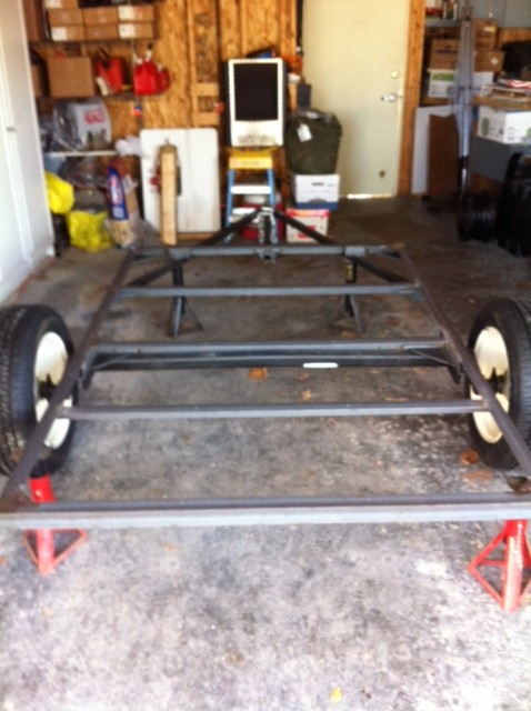

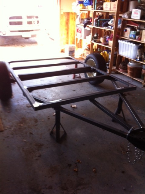

Woodrow's Build - Frame with wheels
Postby bjeppson » Wed Oct 31, 2012 10:40 am
Semi rolling stock. Trying to figure out how to get it warm enough to prime and paint the frame. A version of Murphy's law, it was warm enough to paint until I picked up the frame.

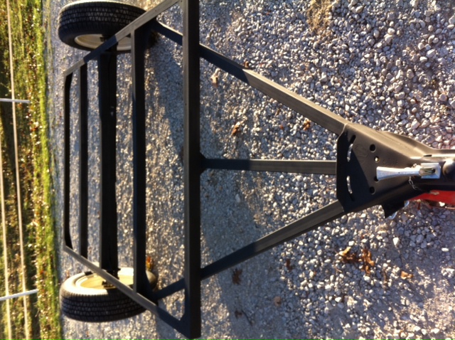

Re: Woodrow's Build - primed frame
Postby bjeppson » Thu Nov 01, 2012 5:31 pm
The weather cooperated and I got the frame primed.
