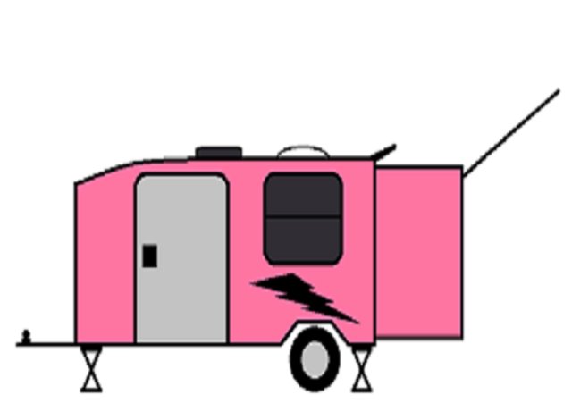

My youngest (27yo) child Cassie (we call her Boo) asked me over six months ago (that's when I started lurking here) if I could build her a small camp trailer to pull behind her 2011 Dodge Caliber (tow rating of 2000lbs). I told her I would but she would have to pony up $1000 to build it and I would take care of the rest??????? To my surprise she said she had the money! So I told her I don't build things in a rush (whenever I build anything, I collect all the parts needed first, after that, it happens quickly). I said to her, we would have to start collecting parts patiently, looking for deals. I asked her to start sketching up drawings of what she wanted. I have to tell you it was a lot of fun doing that with her, she was so excited! She like the shape of the Runaways built in Florida. But that's just a place to sleep nothing else. So we agreed on a plan (after collecting many parts).Image
I donated a factory built mini speed boat trailer for the build (I own a marine repair shop). Even though it was a 8" boat, the trailer was rated for 2000lbs. That trailer is built out of 3/16 2x3 box tube! Way overly built for such a small boat. It was easy for my son to square out the frame for this build. The trailer frame is 63" wide, so the camp trailer is going to be 63 and 3/8" wide by 8' long by 4" tall above the frame. It will have a 36" slide out on the back for the kitchen, This camp trailer will have 3/4" plywood sides and 1/4" roof. It will be pink in color!!!! I'm already three weekends into the build! Shame on me!

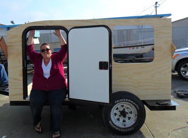

She definitely is! Hand and hand. She's telling me what to do??? This camp trailer (can't call it a teardrop or anything else) is being built with just a worm drive Skill saw, a sabre saw and my Dewalt drill and that's it for power tools. All free hand! She hand drew the front radius. I cut out the straight lines, but she wanted and did the radiuses for the roof, door. and windows. We screwed the two sheets 4x8 plywood together and made the cutouts at the same time. I have to say, this ACX plywood I bought for the walls, is the best ACX I've ever seen. No not's voids or fillers! Like marine plywood.Image

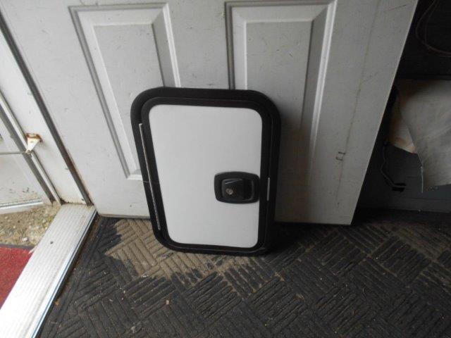

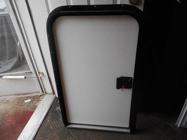

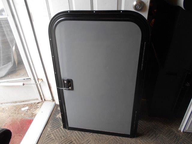

New, 44x29 insulated cargo doors with locks and door handles on the inside. EBay $130 for both shipped ( the cargo doors both open on the same side but for $130 shipped on budget. She'll have on one side a "suicide door").

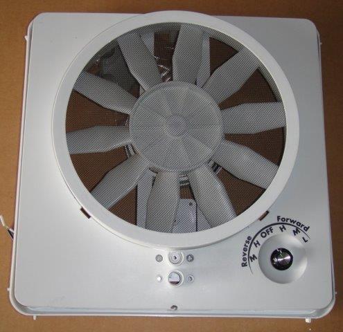

New, Vortex 2 vent/fan $65 shipped.

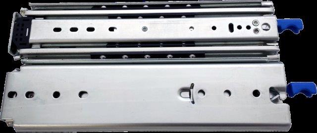

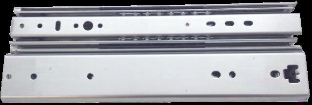

New, Raydon 36" 500lb locking in and out draw slides and 2 30" Raydon 250lb draw slides non locking $150 shipped.
The photos below are all from the sellers websites.

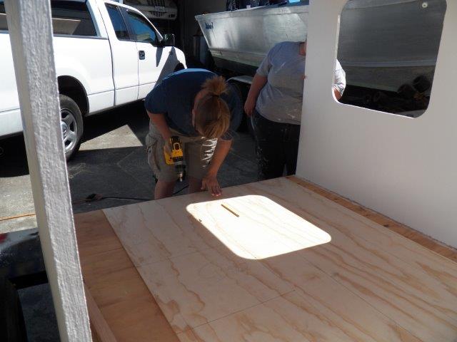

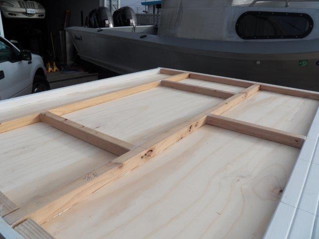

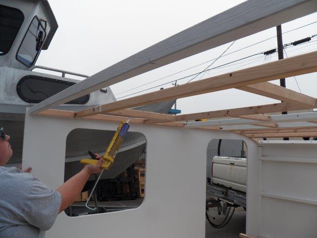

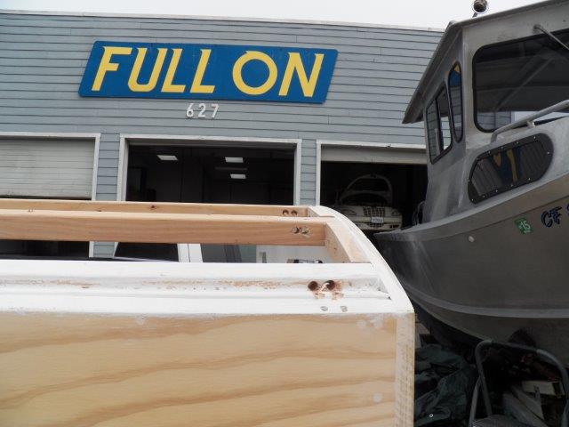

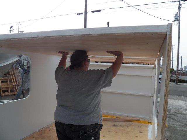

Thanks' PC, It's budget based. Built on the fly as we go. Built around the parts we bought. But we don't dwell on things/changes to much. Boo wants this done by the end of October! We are building all the roof supports out of 2x2's, because that's what I had laying around. We got the rest of the roof supports in today and put in the rear portion of the inside ceiling. Holes drilled for wiring also. Boo worked on it for a solid 7 hours with me today. More tomorrow! Some pics now.
Boo filling the screw holes.
Boo putting the glue on the ceiling
Boo holding up the ceiling so I can screw it up (did I just say that??).
Rear ceiling in!
Wiring holes drilled.

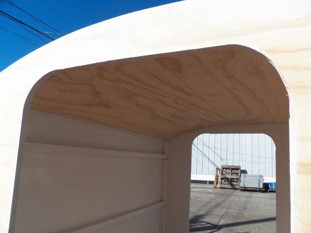

Postby fullon627 » Mon Sep 01, 2014 1:01 pm

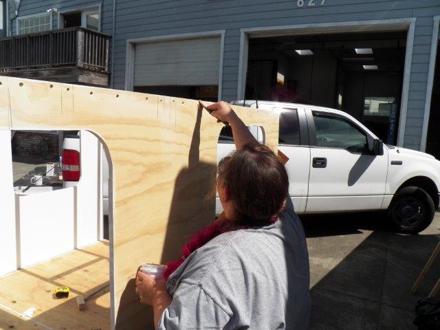

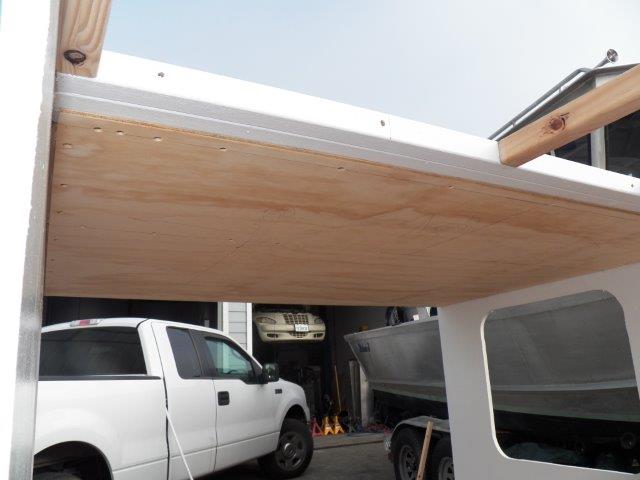

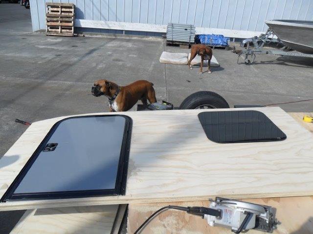

Work for five hours yesterday. It was nice to have Boo's friend Mara helping. Got the front (curved) part of the ceiling in and Mara was a big help in that! Then they ( I just supervise after that???) spent the rest of the day filling and sanding screw holes. Boo did purchase the insulating for the roof yesterday. Boo is taking the day off today. I will be putting in the insulation, cutting out the holes for the skylight and vent. I will also be doing some wiring.
Mara, pre-countersinking holes before we put the ceiling up.
Inside ceiling pics.
