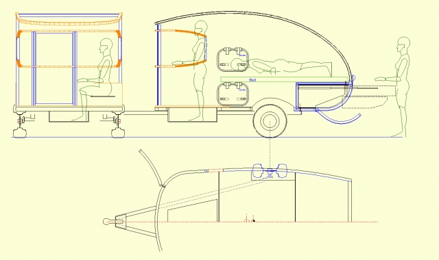

I want it to curve on all sides. Anyone who saw my early post may note that it is rounder at the front lower, more TD like bottom and with vertical face.

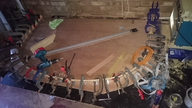

And bending ply is the other. This curve is 1 of 5 needed for the drop down rear door. 10 layers of 1/8" ply and PVA wood glue

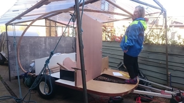

Postby UK-Corlett » Mon Apr 18, 2016 8:17 am
Hi
In July 2015 when half way through my build I snapped my Achilles Tendon.
Well 9 months later and now the days are warmer and the nights longer the build is back on.
Bought 3 sheets of 9mm ply and started bending frames. Photos to follow.
While out of it the design changes a little. It still has the aim of curving on all sides. it has stowage and two small chairs in the front. The construction is light weight ply foam ply. with the foam injected and expanding in situ.
Clive

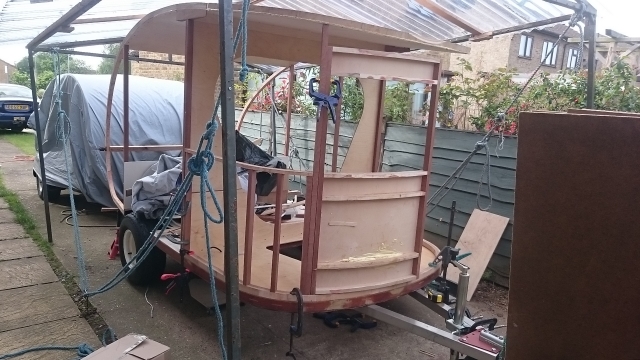

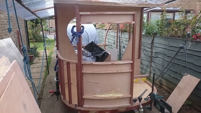

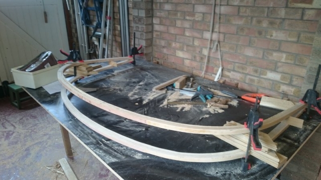

Postby UK-Corlett » Mon Apr 25, 2016 4:41 am
This weekend I spent making component bits.
I am focused on the front of the TD. I need curves to define the front.

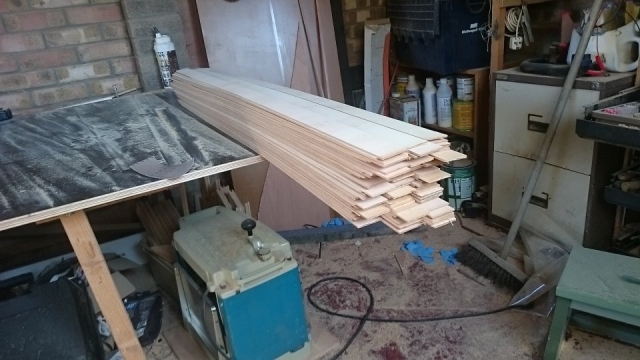

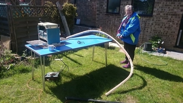

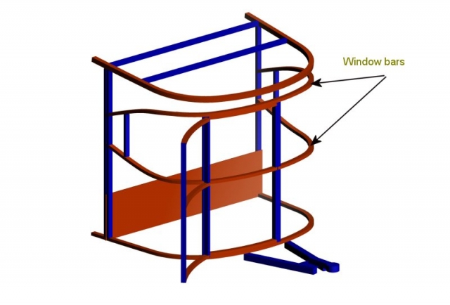

This little set of photos shows us making the window bars.
For this we will need lots of lats (1-1/2" wide x 1/8" far eastern ply) and lot of clamps.
The curve then wants planing to size in my thicknesser.
and them dummed up on the bench.
Obviously the gap between the bars will be bigger. But the question is should the smile be turned up, turned down, parallel.
Well Kate has decided that its parallel at the bottom of the window and parallel for mid span at the top but tapering down at the sides.
All will become clear in later weeks.
Finally we get glimpse of what the continuous curve may look like.
Next week bulk heads me thinks.

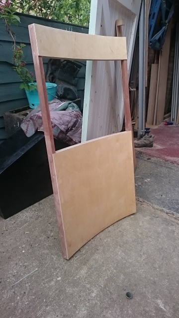

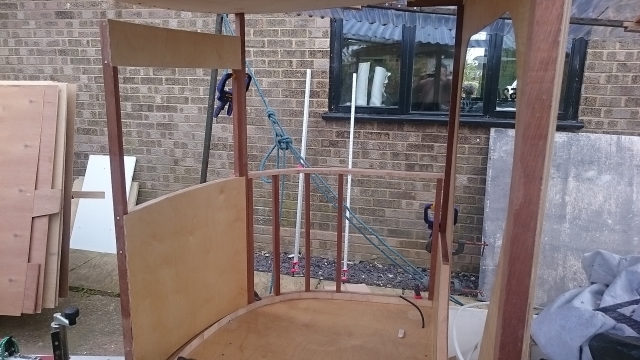

Postby UK-Corlett » Mon May 16, 2016 5:23 am
Hi
We have has some nice days here in the UK and construction moves on a pace.
As it turns out I have chosen the slowest construction technique possible. All curves on all sides sounds a good idea until this ham fisted clot tries to pull it off.
An asymmetric curved door sounds difficult and guess what, YES I wish I had gone for flat. But here it is half skinned.
You should be able to see the path of the curved window to come.
I will skin the interior wall next weekend and we have a bank holiday the week after (something we Europeans has in buckets {holidays})
