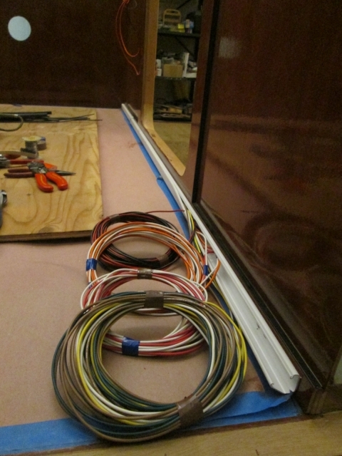

I used Uniduct 2900 for low voltage wiring around the wall sills of my cabin. It works fine on flat surfaces.
In this shot looking thru what would later become the front wall of my cabin you can see the wiremold laid open along the base of the street side wall as I rough in the 12v electrical. The track snaps open and closed. I was leery about the adhesive backed foam tape that is factory applied because I am sure there will be times when the inside temp will get pretty hot when setting in the sun closed up, so I used some truss head screws thru the inside as well. The tape ends up sticking really well... at least to the very smooth poly'd surfaces, so maybe the screws weren't needed. Stuff is easy to drill thru to pull wires thru the back.
