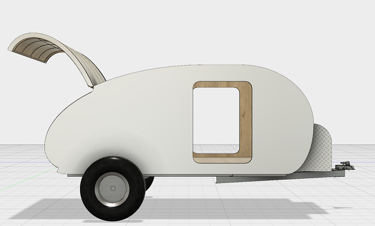

I've been designing a modified and stretched cub. It is 5x10 on a welded Northern Tool trailer. I'm replacing the original suspension with Timbren independent, and adding 15" wheels and tires. Here are some early sketches. I'm doing some last minute tweaking to the plans. I have begun ordering parts for my build. The suspension is on the way. In the next week or two I'll pick up the trailer.
The floor and walls are skeletonized, insulated 3/4" with 1/4" outside walls and 1/8" inside walls, headliner and roof. The whole thing will be skinned in .040" Aluminum. I'm also stretching the tongue for more clearance and better backing.
Several quick questions for the forum:
What is the min height needed for my roof cross-members? I'm tall, so I'd like to gain as much headroom as possible without going over 48" OAH. I have a 1.5" drawn now but if 1" or 3/4" would work...
Would I need more than 6 bolt anchors for the floor to frame?
Thanks.
David

Postby lfhoward » Sat Mar 12, 2016 9:36 am
Hi David,
That's a nice looking trailer you have planned there! Looks like you've done your homework and have considered lots of factors in drawing it up.
A couple of things come to mind. First, be sure to check on the correct position for the trailer's axle. In your sketch, it is pretty far back on the teardrop, which would make sense if balanced with a very heavy rear galley, but with your tongue box and the majority of trailer weight in front of the axle, it may put too much tongue weight on your tow vehicle. I'm sure there are guidelines for positioning it (my TD is not on a red trailer so I'm not sure where to send you for that), but you could also check out some TD's with similar proportions, like the Atma Travelear or the Silver Beatle.
Second, to answer your questions, I think more bolts to hold the body to the frame would be better than less. If it were mine I'd go with at least 8, if not 10 or 12. Even if that many may not be absolutely needed for the physics of the thing, they would give me peace of mind and they are not hard to put in at is stage. In terms of roof spars, in my opinion you'll need a depth of 1.5 to handle the torque that curved 0.04 aluminum will put on the frame, and that depth is needed if you plan to install a Fantastic Vent Fan in the ceiling. 1.5 inch spars (1x2's oriented vertically) will provide strength to the TD body and keep it from flexing. If you can find a source of 5 foot wide 0.04 aluminum sheeting, you could design your TD to be 5' tall and gain an extra foot of headroom if you are concerned about inside space.
lfhoward
Posts: 1370
Location: Philadelphia, PA
Re: Yet to be named build log
Postby MIB66 » Sat Mar 12, 2016 10:17 am
lfhoward,
Thanks for the reply. I can easily go with 10 bolts as it is planned. I was pretty sure the response would be for 1.5" roof spars. That is what I currently have planned. As to the axle placement, The original plan was checked in solidworks, and that position gives about 15% on the tongue. Also, with the Timbren axles, they would be easy to move.
David

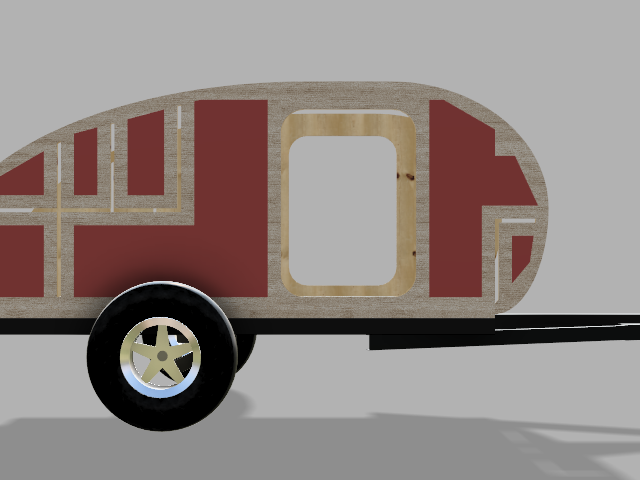

Postby MIB66 » Mon Mar 14, 2016 3:07 pm
Turns out you were right about my axle location. The earlier image was from before I did the CG calc. Here is the updated location showing the redrawn sidewall frames.
David
