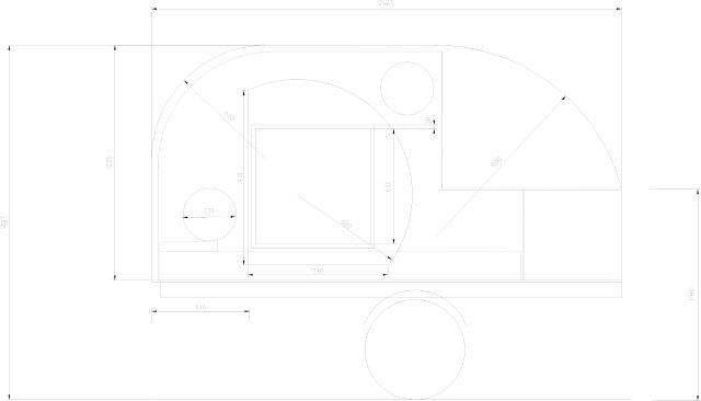

Hello all,
I am copying the bulk of my intro post to kick off the build journal.
Let's see if I end up with anything like the plan!

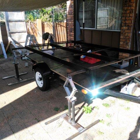

Due to limited parking space (or too many vehicles & boat!) I have designed a system where I can lift the TD off my trailer so it can double for general haulage tasks. (it also allows for sliding a folding table and tarp poles etc underneath)
The horizontal bars that sit on the jacks slide out when the TD is on the trailer.
I have the base trailer (5’ x 8’ flat top kit) and my floor frame complete (recycled steel too!). I have the profile drawn up and the marine ply for the sides ready to cut out ….

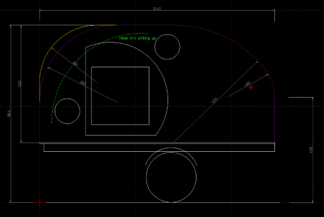

Oh and the design might be tweaked a bit already - I am toying with the idea of increasing the radius of the front curve from 600mm to 800mm as shown in this diagram.

Picking the final shape is tough, I really like the traditional look like the Grumman or Cub, but there is a lot of lost space especially in the galley. Obviously a square box has the best use of space. I think the Benroy is a good compromise. I see you are considering going with a larger radius at the front. The Generic Benroy plan uses a 19" radius. I went with a 20" (508mm) radius. A 600mm radius wouldn't be too much more, but 800mm radius may make the vertical portion of the front wall a little short for sitting up in bed and reading a book or watching a movie on the laptop. Just thought I would mention that in case you hadn't considered it. By the way I used 1/8" baltic birch and it easily bent to the 20" radius. On the tongue box I used a 16" (406mm) radius and that wasn't a problem either.

Some kind people have liked my jack stands for lifting the TD off the trailer. I thought I'd throw up a clearer shot of them.
As you can see the nest reasonably well for storage. My first try the base was a Z shape rather than H so they would nest really well but they were not stable enough if the TD was pushed on a diagonal from one corner.
The RHS on the H is only 20mm high so very easy for the tyres to roll over when removing the trailer.
The slightly different sizes on the other dimension are because I am recycling scrap. I get all my steel from the local motorcycle dealer. The bikes come on a steel frame in wood packing crates. Here is a picture of one I have not cut up yet.
