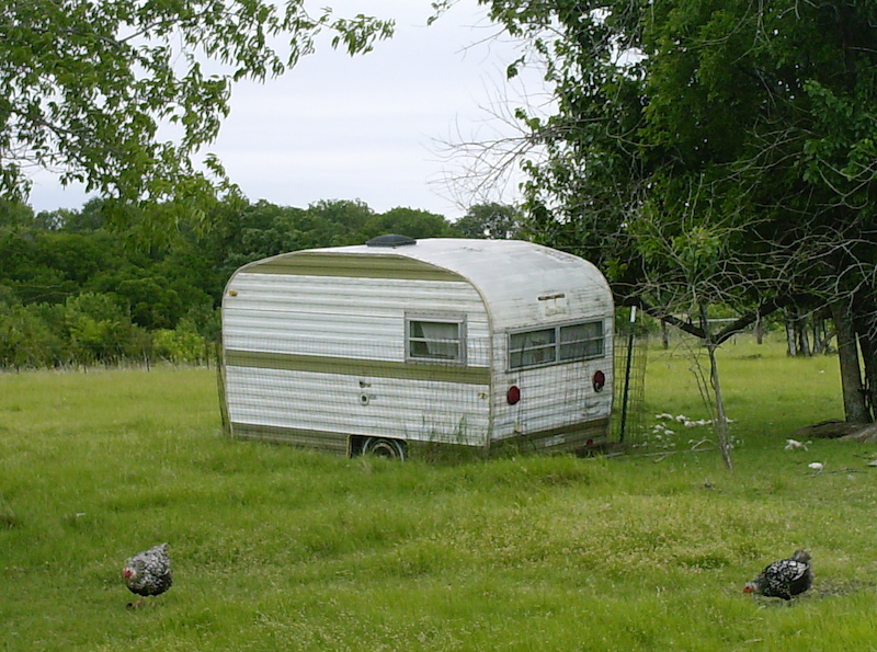

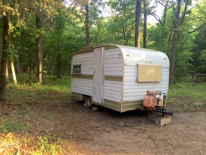

I just sold my ’68 Scotty that I have camped in for the past three years and at long last I moved the '78 Play Mor into the garage and started working on it. Since this is the beginning of the build thread and the first time I have done one on years, I will digress for a moment on the history of the camper… My mom bought this to escape the heat on their property while they were working outside before their house was built and then it sat for 20 years unused. She gave it to me after I built a greenhouse for her. I am the 4th owner and I have all the original paperwork on it and receipts for every title transfer since it was new. It was totally trashed inside so I gutted it after getting it home and it has been sitting, waiting on me for four years but hey, I’ve been busy… While it was sitting in the woods on my property, I snapped a cool photo which was published in Vintage Camper Trailers magazine so it’s already “famous” haha.
My personal likes about this camper are that it is a 1978 but could easily pass as a 1968 with it’s vintage style rounded corners. Also, I have never seen a PlayMor that WASN’T a trunk back so I think that is pretty cool too since I don’t care for those (sorry). I love that the camper hasn’t been repainted or gooped up with silicone. Lastly, I just love the simplicity the the camper, it is low to the ground but has no drop floor, all the utility openings are located in one place on the side of the camper and moreover they are minimal and small. Along those same lines, there is no outside storage door; I really like that from a restoration standpoint and for the uncluttered look it provides. I won’t have any propane so I will be mounting my tongue box that I pulled off my old camper for all my outside gear and can store my easy up and other gear under the couch seat. The best part about this is that I am building this using my own plans and can make it 100% me.

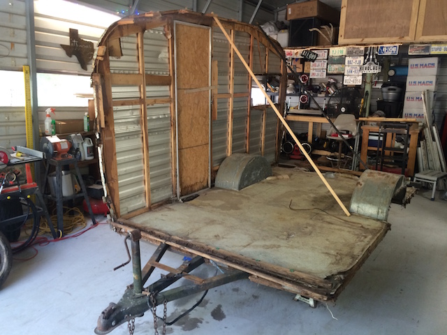

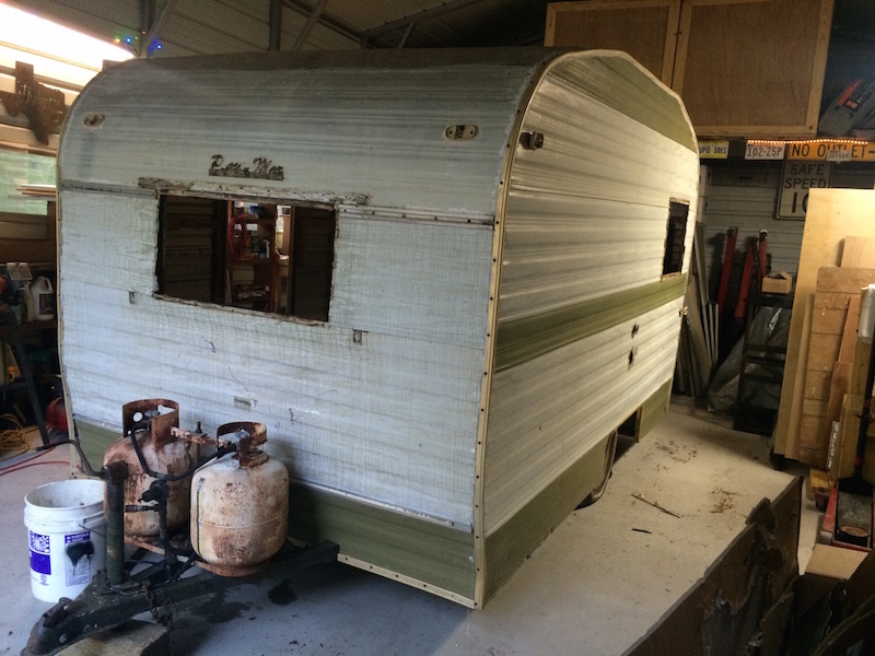

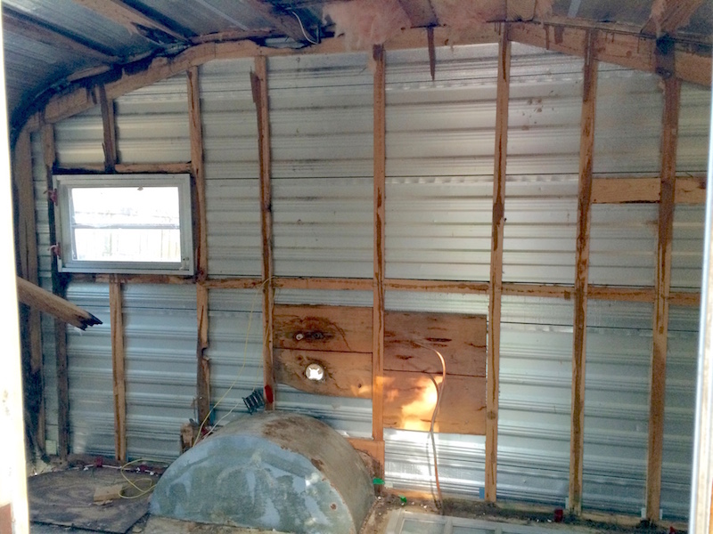

OK introduction aside, today I removed all the windows, lights, badges and pretty much anything that is screwed onto the outside except the corner edge trim and door frame. Going to take the side walls off in one piece since they are perfect except around the edges. Also going to re use all the aluminum skin except the top roof section which will be a new, probably white, one piece replacement.
Here are some pics! When it was at my mom’s, then as it looks today at my place.

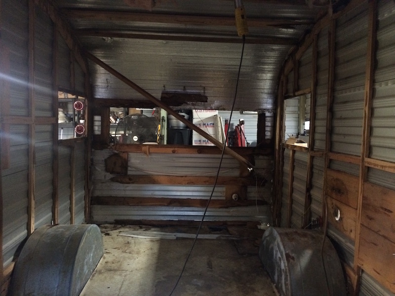

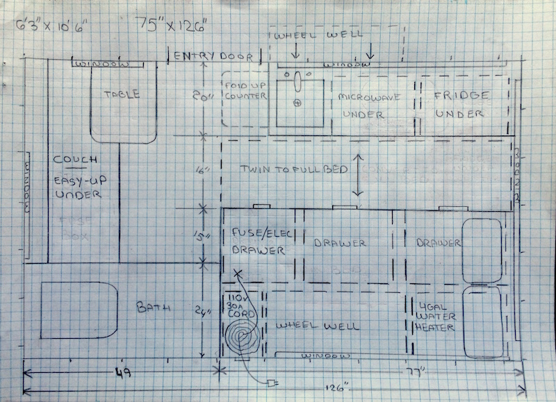

Here is the gutted interior and my floor plan. I wanted a 2 person couch/dinette. a Twin bed with an option to Full size, and a kitchen with lots of countertop space AND a full bath, all in a 10 foot camper.

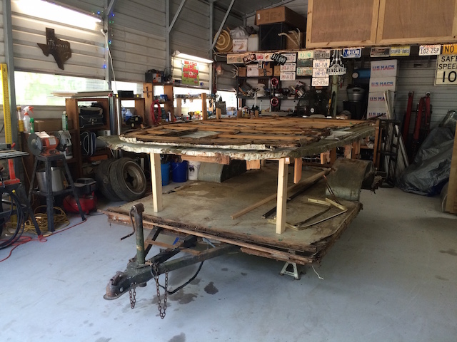

Postby 2bits » Tue Jul 24, 2018 3:44 pm

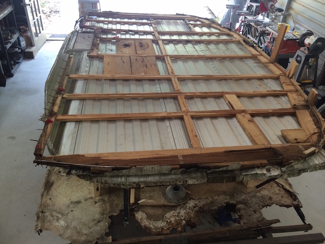

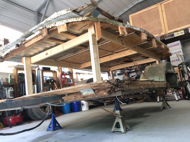

I got the other wall down and built a stand on top of the trailer to stack them on and it is right at a perfect working height for me to rebuild them before I do the floor. This rack is a great way to store the walls and if I need to move everything out of the garage I just hook up the trailer once the wheels are back on. The last pic is a good shot of one of the walls that shows how perfect they are except around the edges.

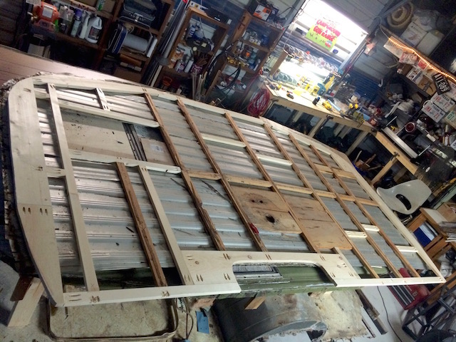

Postby 2bits » Fri Jul 27, 2018 8:22 pm
I got my first wall done! I just needed to go all around the perimeter and the window and everything else was good. I added some extra framing in the middle where it seemed like it would appreciate it. 120 pocket holes if my count is right.

I will be following your build closely. Your layout seems perfect to me! Linda and I are looking for a small trailer with a bathroom and shower, and your design checks most if not all of the boxes.
