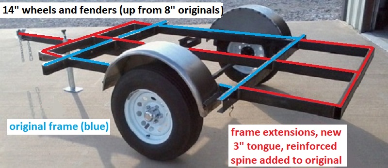

* I started my build with the "promise" to keep it under $500, but knowing already that'd be nearly impossible, from reading the forums/lurking for a year or two before I started (first: Expedition Portal, which led me to TnTTT). Ostensibly, I was just making a safe and dry sleeping trailer for my wife's Bigfoot hunts with her girlfriends, but also had personal camping/exploring/travelling in mind for myself, as I was approaching retirement (I was 61).
* I started the build at a friend's home race-car shop, 50+ miles from home, for
  • 1) room to build in (none in my garage at the time),
  • 2) using my friend's skills and tools (I had minimal amounts of each, myself, specifically the major welding of frame extensions & reinforcements needed), and
  • 3) so I could hide it from the wife until too far along for her to stop the project (I had hidden several car resto/racing projects in that manner before, and they were even more expensive).
I didn't weld at the start of the build, so I needed help with extending/strengthening the frame
frame mods welded-on at race shop.jpg (119.2 KiB) Viewed 4044 times

Postby JasenC » Sun Mar 27, 2022 11:38 am
I haven't been around much, okay almost not at all for awhile. The holidays, caught Covid 1st week of January despite all my precautions, that took me out at the knees for 2 weeks, no hospitalization though. Followed by nearly 2 months of headaches and fatigue that had a healthy active 58yo huffing and puffing before the top of 1 flight of stairs.
My company van full of tools got stolen out of my driveway last month, PD still hasn't found anything thing, had to tool up another van. The company is out a 2014 E250 and nearly $6k in tools, I'm out $2k in hand tools which the Ins is picking up and the company said they will pick up any slack left from the Ins. Wasn't happy about getting a Sprinter tall boy as a replacement to the Ford, the Spinters 4' longer and a foot taller but it definitely drivers better and is more comfortable to drive.
Took a bad step 3 weeks back twisted my foot and fell hard on my tail bone, but yeah I'm back up and operating at about 93% efficiency so happy days. :D
The freight company found the rest of my trailer literally as I was working on returning it, oh wait, no they found the wheels, fenders, hitch coupler, lights and hardware but not the axle.
Took delivery in January as I was knocking on deaths door with Covid. NT was to get in more axles mid Jan but that didn't happen and then they were to be coming in mid March and what did I find when I got home Wednesday, FedEx dropped off my axle. Glad that fiasco is over, NT's CS pretty much sucks these days although I don't know if it was ever good or bad, never delt with them before as I've never had any issues with them over the years aside from a simple return or two.
Now the garage got destroyed during the holidays, covid, work, scavenging trailer materials etc. I've started working on cleaning up that but now that my winter project has moved into spring I may just pull the Jeep a little farther into the side yard and build out there. I can tarp off between the house and fence if I need too now that there shouldn't be anymore wind storms until Autumn.
Also think I scored enough free steel for my frame extension from 5x8 to 6x10, our company truck driver found a piece he is saving for me down at the shop plus I got my hands on an old 52" Biesemeyer style table saw fence guide rail tube.
Missed a sale at Harbor freight on their 110v Titanium series MIG welder, my Miller Cricket wire feed is older then dirt and it gave up the ghost last year when I was trying to put a new muffler on the truck. I can't get parts for it anymore, it doesn't take gas and I'm tired of messy flux core wire. A bolted up frame doesn't sit well with me on something like this.
Don't think I'll get much done this week, the kids are dropping off the grandson today for a week while my son has a routine surgery.
I'll be done when I'm finished, if that's not fast enough, take a number.
