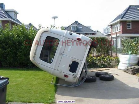

As far as rolling it on to its side. Have you seen the jigs that get used for under body repairs on car restorations. I have seen them in english classic car magazines. Not the rotisserie type, instead they have a curved frame that you attach to the wheel hubs. Ideally the arms would extend far enough up the sides to stop it rolling right over, and have stops so that it wont roll back. I googled "car restoration rollover jig" . Go on to images you will see all sorts of ideas, some made of steel, some made from wood.
