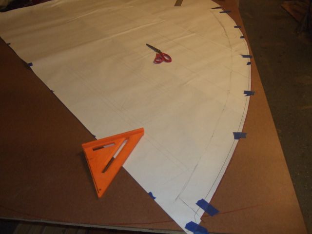

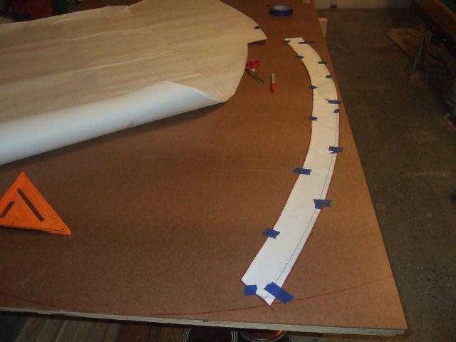

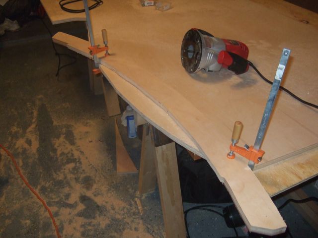

Ya' remember that full size pattern you sized? Now it gets used again. I taped the pattern to the side to mark the hatch rib outline.
Just how deep can the rib be...
Rib pattern
Test fitted rib pattern.
I found one spot where the jigsaw bit too much so I've glued an extra bit on in order to re-fair the curve.
Coming up. The dreaded hatch build. :o

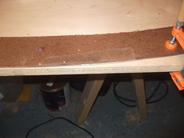

Postby Sparksalot » Thu Aug 28, 2008 8:48 pm

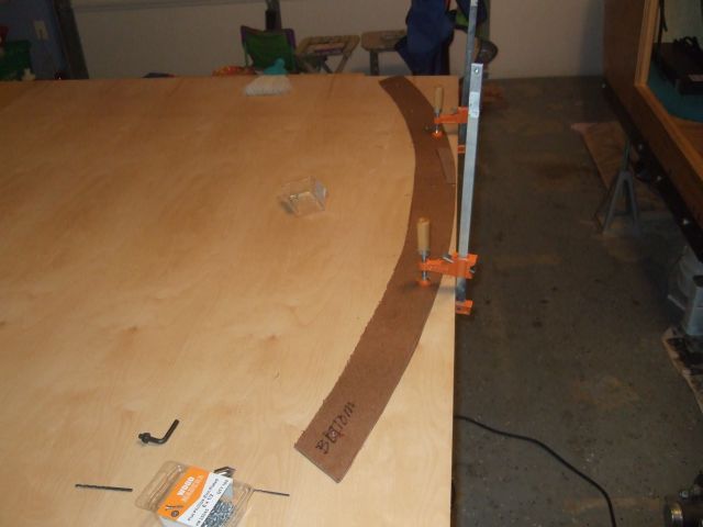

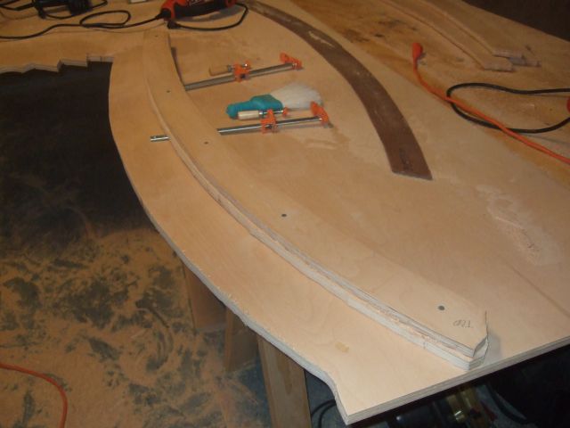

The template gets screwed onto the blank.
The scabbed on piece to smooth the low spot.
The Working Stiff rejoins the party.
The Princess is not to be left out.
Progress and an abrupt halt.
I apparently smoked a bit. Rats.

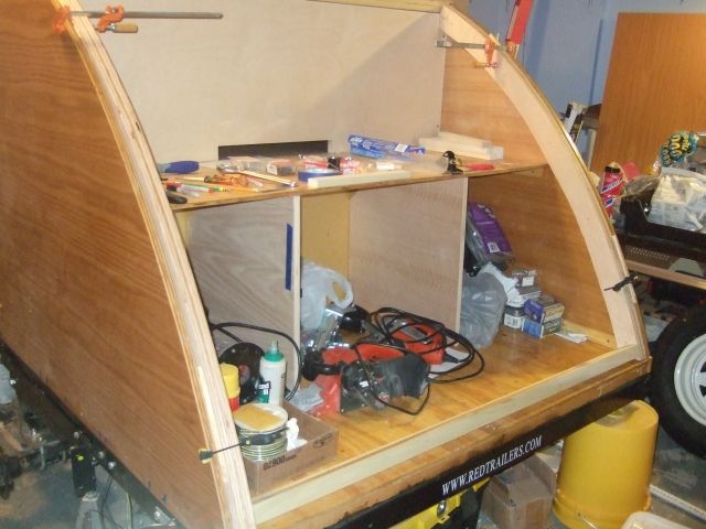

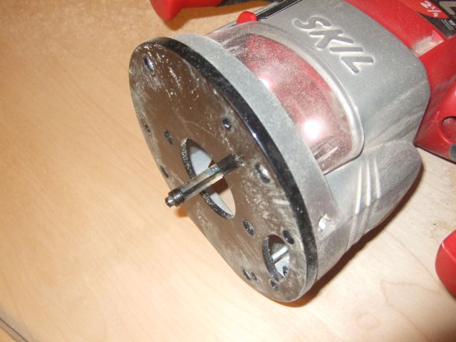

I replaced the smoked router bit and pressed on. I realized the 1/8" masonite didn't have enough thickness for the bearing on the bit to effectively ride against. I decided to use a full rib for the template instead. I didn't like how the first rib turned out because of the cut-us interruptus. I used the second one.

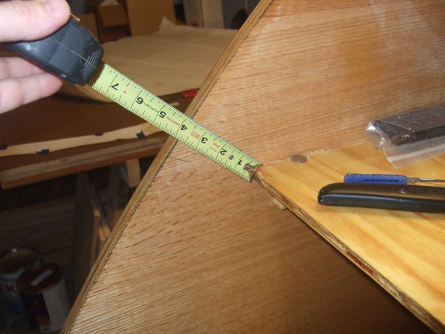

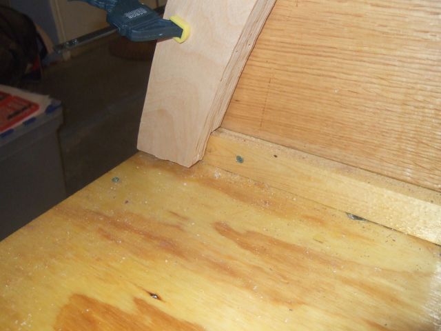

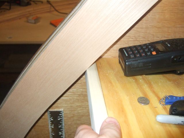

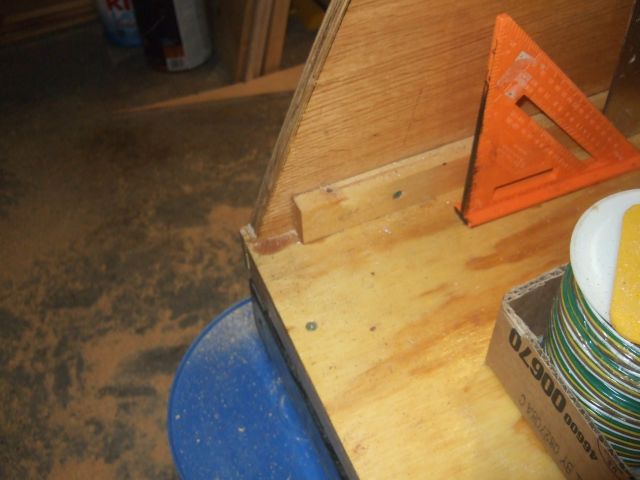

Along the way I've realized the 1x2 cleat at the base of the walls was going to get in the way of the hatch.
So, I turned to the router again. Have I mentioned before how handy this thing is? I needed one of these things years ago.
Fits like a glove.

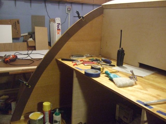

The ribs clear the shelf perfectly. I'll put a rounded over piece of oak trim on the shelf.

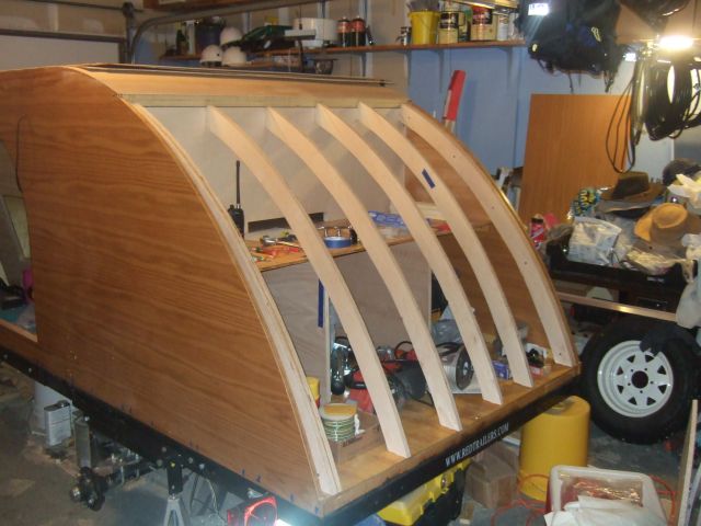

Just for fun, eh. Just sorta sitting in place. I haven't marked them for the top and bottom notches yet.

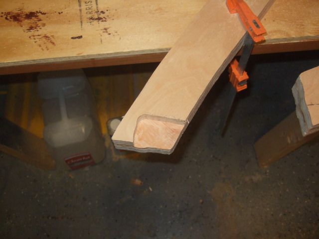

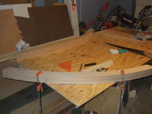

The side ribs are clamped in place. I finally got to use the package of door shims I've had laying around for years. SEE, there is a reason to hang on to all that "useless junk." The top and bottom spars were measured and cut.
Hey Ronald, eat yer heart our. MY McRib is bigger than yours. Has to be, it's from Texas. They're clamped together to make the top and bottom notch cuts.

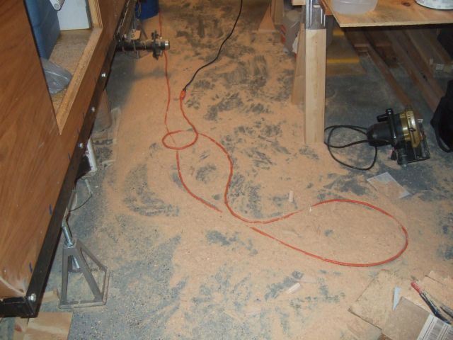

Postby Sparksalot » Sat Aug 30, 2008 11:12 pm

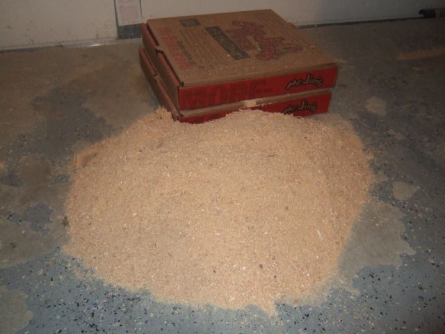

Messy garage pics for Auntie M.
Whoa, that's a gob of wood chips.

Postby planovet » Sun Aug 31, 2008 3:31 pm
Sparksalot wrote:Whoa, that's a gob of wood chips.
I never realized how much sawdust and wood chips I would produce when I started my project. It's amazing. :?

Postby Sparksalot » Mon Sep 01, 2008 3:27 pm
I've been continually sweeping it up and adding it to the compost heap. Gonna grow a plywood tree when it's all said and done.
